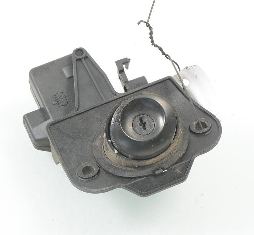

The whole setup looks like this: Being a one-layer plastic door, there is no real way to fix the lock with screws. They did it down with the latch where they found it inevitable but up with the lock, Citroën made the mistake of using a simple clip (7) to keep the lock in place. And, after a time, it does not.
I don't have a similar exploded look for the Saxo at hand but they did a much better job there: Obviously, not a direct replacement, not even close. Still, the question remains whether somebody already solved the issue, found a way to fit this, anyway, or some other make, or maybe a way to fix the problems of the original design? Adding a central lock mechanism just to the boot door is also an option, but a more complicated one, of course, needing wiring and a way to actuate.

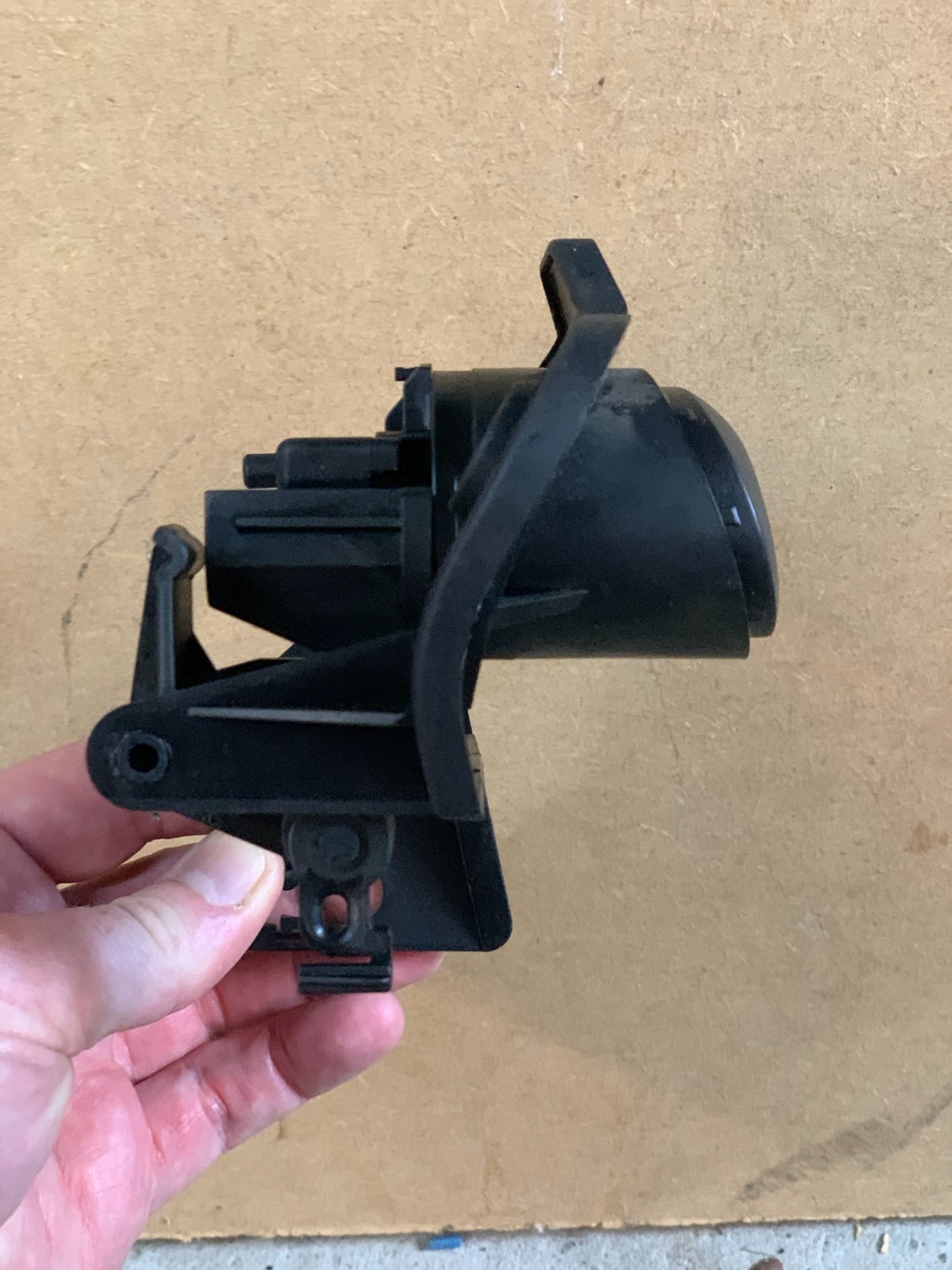

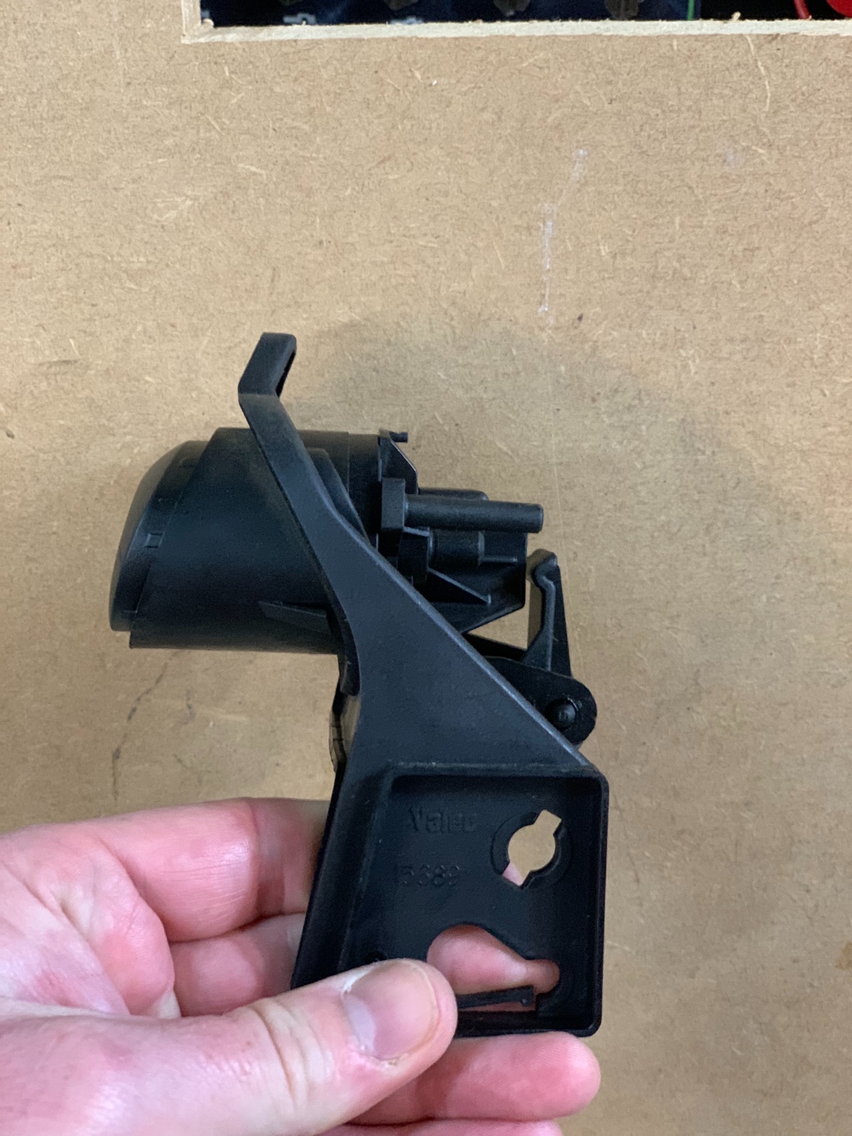

Like you say the locks are not even close & both operate completely differently. The AX twists to unlock? (From memory, its a long time since i touched an AX lock) but the Saxo pushes to unlock and is also bolted on rather than a clip.
I have a Saxo boot lock here so here are some pics from different angles.
If i was unable to repair the original lock i would probably consider doing away with it & fitting a universal solenoid release with either a remote or hidden button.

Thanks, these pictures were of real help. The car is at my mechanic, he will decide on the final solution. Seeing how the rod can actually be attached helped. A solenoid is still possible but attaching the solenoid would be simple, finding the way to operate it would be more daunting.

Pete, thanks, that would be very nice of you, thank you. My mechanic has just called me that there is a potential AX with probably the lock still there in a yard, he asked for it and expects to get the answer back next week. If that doesn't turn out to be available, I'll gladly take you up on it.
I found more than one on leboncoin, I think they are the same, the parts to be seen on the diagram above, the rectangular surround (4) and the barrel that goes inside (2), that's all. Probably with the retaining spring (7) but this is the one that tends to fail over time, so we might find another way to secure the lock in place. Gluing it in place is tempting but not necessarily the best solution
