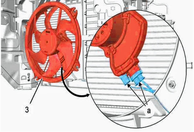

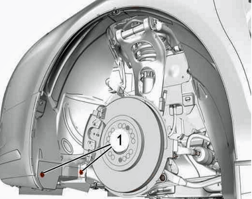

| Remove the bolts (1) ( each side). If necessary remove the front splash-shields. | Remove:

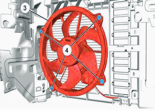

| Remove the bolts (4) (Fan (3)). Detach: The cooling fan (3). | Disconnect the connectors ( as "a"). Remove the fan (3) (Downwards). |
CAUTION: Mark the routing of the fan harness.

Reconnect the connectors ( as "a").
Refit:
- The cooling fan (3)
- The bolts (4). Tighten the bolts (2) to 0,8 ± 0,1 m.daN

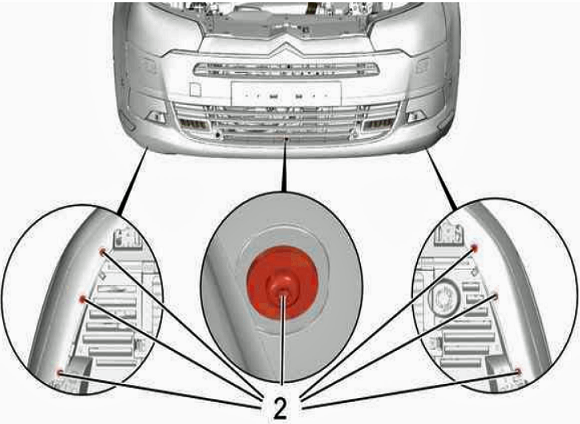

- The air deflector (under the bumper)
- The bolts (2)
Refit:
- The bolts (1)
- The protective panel under the engine (according to equipment)
