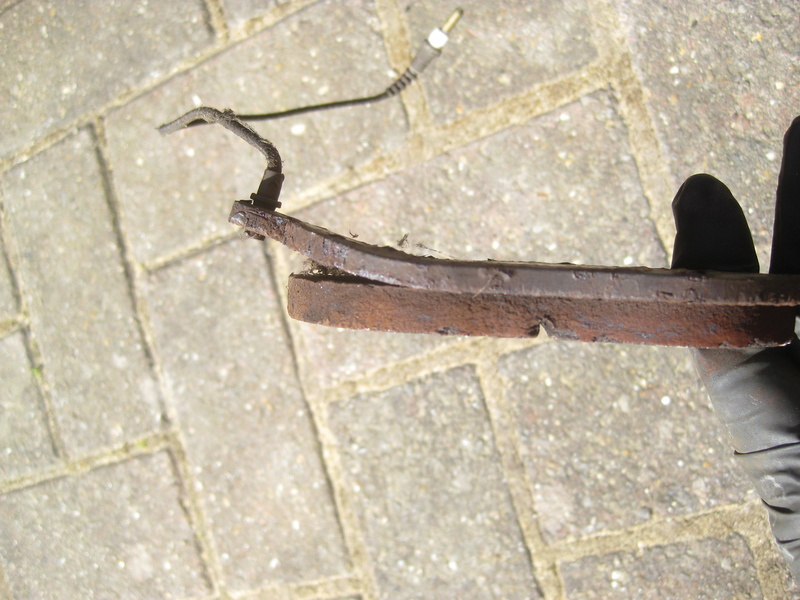

Nothing at all at the back was disappointing. I took the hubs off, hoping to find seized cylinders, but they were both nice and slidy, so it's not that. Jacking the rear of the van up, with someone foot-braking, I can turn both rear wheels by hand, so that is essentially 'no brakes', (handbrake works fine) but then the compensator valve should be detecting 'negative weight' so maybe that's expected. So propped it up on the axle instead so that the weight of the van is on the axle. Still no braking worth mentioning. But there is some if I push the compensator valve lever hard. So I think the zero-point is set wrong. I don't understand how to set the weird spring arrangement - more on that later.
As a whole new set of discs and pads was £47 with a current sale code from ECP I decided to just replace the front. Did that today and found out why I was getting 50% imbalance on the front. One pad was completely bent! The 'ear' must have caught on the edge of the caliper so it had to bend when the piston operated! Guess that's my fault from last time I fiddled and didn't put it back together carefully enough. oops. Not good. It was working surprisingly well considering. Nice to have a reason at least. Pedal is still soggy though, so the bent pad wasn't the reason for that.

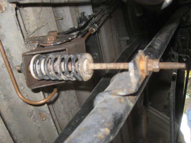

So this is what the compensator looks like:
Not a great image. But I hope you can see that the rod mechanism is loose between the panhard rod bracket and valve lever. No brake pressure will happen until the spring starts to push on the lever. There is a flange on the rod above the bracket which sticks through the bracket (you can see the fat bit) so it is not possible to tighten the bottom nuts up to stop it rattling about in there - that seem to be how it is designed for some reason (hysteresis?) The top nut is plastic and is also tightened fully against the top flange. Maybe the middle flange at the bottom of the spring can be adjusted (but it has no hex)? The Russek book just says 'take it to a specialist' to set the pressures.
So anyone know how to adjust this thing? or is it really too hard to do at home?

Re: Saggy Expert brake pedal
Some stuff here from another forum.
https://www.diynot.com/diy/media/untitled.93658/
Aha. that is really useful Gibbo. So the tool is 2 16mm shims. So there should be 16mm between the top nut and the top of the lever and 16mm below the bracket, then tighten the base flange down to there.I think I can do that. Will try on Sunday.
Just to complete this thread. With a new set of front disc+pads and an adjusted rear compensator, I got an MOT!
Setting the compensator was a bit tricky. I set it originally with a bit of stuff still in the van, and that resulted in removing all the rattle from the spring mechanism and when the pedal was pushed the wheels stopped turning. The garage must have set it wrong for last year's MOT so my rear brakes probably hadn't been doing anything all year unless the van was very loaded. About 18mm of thread remained visible at the bottom.
But then I took everything out and re-did the setting. That leaves the nut very close to the end of the thread - with only about 6mm showing. This seemed uncomfortably little so I wound it in to between those two positions with about 10mm showing. This seemed to do the trick, but I'm still not quite sure what the 'reference height' should be.
The brake pedal still sinks more than I'd like so the original issue remains, but clearly it was deemed 'good enough'.
