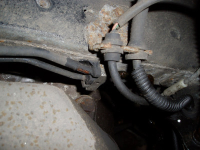

Hi everyone,
I hope you are all keeping safe and well.
I am very sorry for delay in checking in.
I have been having trouble on the photo front.
I have been busy on the challange ahead. on Saturday May 8.
The two piipes are close together,( one in front of the other) both pipes are postioned behind the near side wheel (about a 30% down from the wheel arch) behind a
removeable bracket that holds in place flexible rubber hoses/pipes one is the handbrake.
The very rusted pipe(now know as X) when looked at head on.With the wheel off.
The pipe (X) goes left too(now known as Y) TO the Hydraulic Pump, steering system......this is black in colour+belted pulley
The pipe (x) when look ahead on, goes too the right, deep into the heart of the engine. I followed it to around the steering area(behind a heat shield,thin tin like in nature).now known as (Z)
So in short the pipe(x) starts at Hydraulic Pump(y). It makes it way to the steering area(Z) 'I saw it secured' there. at points from Y to Z all is tight and clean. the pipe along looks fine.
The challange is under the N/S/F wheel arch.easy to get to pipe(X)
(X) under the wheel arch for apx 25-50 mm is very corroded, there are damp pactches around plastic surround(I guess this is to stop water ect getting into the body of the vechile) I cant remeber the correct name!. also as stated above the vechile is parked on the pavement both near side wheels front and rear are higher than the offside wheels however all signs of leakage are under the front N/S/F wheel.
I am sorry if I have gone on for far to long, Chris bless you, as I think your on the right lines and for your reply.
Thank you (James) I think its 'Hell raiser' for your reply.
After searching for the route of X.......' 'I ache in the places where I used to play' leonard cohen line, from, Tower Of Song lyrics.
Look lads I need help on this.....I dont want a Xantia scrapping for a little rust and I dont think French Car Forum members and guest do neither.
Steve

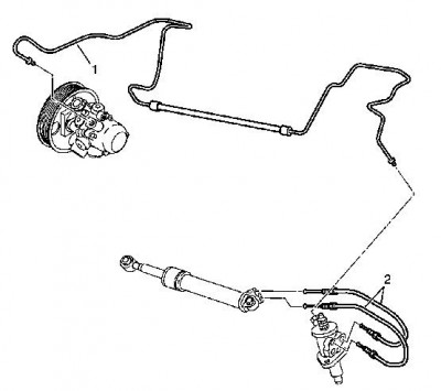

In the absence of your pictures, do the pipes in this topic look familiar? viewtopic.php?t=66577

Dear xantia-v6........god bless ya and a big heart felt Thank you!
You have sent the exact photos.........of the problem......call me soopy but I cant thank you enough.
for the avoidance of doubt...the photo showing the nearest pipe(X) to the securing bracket holding the rubber flexiable hoses.....its the nearest pipe
please excuse bad spelling
cheers friend.
cheers friend.

Hi lads......well now the photos have been made available if you would follow the link Kindly sent by Xantia_V6 (Forum Admin Team) Top man.
The photo showning the location in the wheel arch, are very nearly the match, the (semi) corroded pipe on my Xantia is a little to the left But is the nearest one
(pipe).
So at the moment the Xantia is part parked on the sidewalk (n/s/f and rear, at a angle, No steering!, not tested in real time Brakes!, very little if any 'magic carpet'!.
outside the narrow road.

Hi Lads
rather hope the photographs will help.
If we could make progress on questions that would be Great news and helpful.....I understand forum members are pressed for time too.
Kindest regards
Steve
Kindest regards

Post by Xantia 521 » 02 Jun 2021, 23:48
Hi lads, sorry for the delay.....Big Thank you and grateful for your help Steve & Chris.
Its looking like I will do a combination of both methoods.
I have cleaned all Corrosion reaching beyond a possible leak,its all looking to the naked eye very good, i.e nothing noticable.
This post/item is part of the post, headlined as 'grrrr lhm leak' take a peak of it if you find time....as to repeat the details would a duplication, however something is
bothering me.
So question is.....'by reversing on full lock up the six in curb', could this be causeing truma to the PAS??...as stated on the first post both n/s wheels are on the pavement.....the leaking is directly under the near side wheel......I just get the feeling parking this way may be part of the problem
If you ever feel fed up with answering the same questions....please be assured I for one are very grateful and does not go unoticed.
Stay safe be careful out there
bothering me.

There is a pressure relief valve in the steering, so you cannot damage the hydraulic components with your parking technique. I think that it is unrelated.
The low pressure LHM return hoses on these cars are often perished, and can cause an intermittent leak.
- x 1746
Re: comple loss of LHM grrrrr
Leaks from high-pressure (HP) lines are rare (usually the result of corroded or damaged pipes), and the HP joints almost never give trouble. An HP leak can result in fluid spraying out over a large area.
Low-pressure leaks (from plastic or metal return pipes) are usually just a weep/drip, as pressure is low, and most return lines - with the exception of the power steering - are only having to deal with small volumes of fluid.
For the 3.5mm polythene/nylon return lines, these usually make connection with steel ones or hydraulic components with thick rubber elbows/tee's/couplers. With age, as Mike says, these can split or fail. They're easily replaced, when the leak is identified.

Hi all, big thanx to 'xantia_v6' and Chris.
The help is very much appreciated.
I am pushing my luck....is there any chance of photo, or maybe point me in the right area to look too focus on?
I really dont understand why the LHM was/is directly under the front near side wheel....both wheels on the pavement i.e 6 inches higher.
Look thanx lads.

Ok just a silly thought having read and re read this thread.
Is it possible that the n/s front strut return pipe is split, may have been leaking for a few days but by parking on the angle as described, both n/s wheels on the pavement 6" higher than the o/s that a split could self syphon the LHM out of the tank ?
As the LHM tank is on the n/s of the engine bay 6" height difference would tip the contents of the LHM tank towards the return pipes ?
Colin
