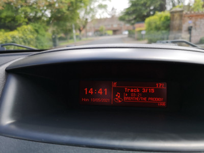

Re: C2 Multi function display upgrade questions.
Hi, thought i'd do a quick update. The type c display arrived today so I went out and installed it to make sure it works. Seems to be fine. All functions present and correct from previous type a with the only difference I can see is the bluetooth function which of course my rd4 radio doesn't support. I shall remedy this with a rd45 upgrade later then get it all configured correctly.

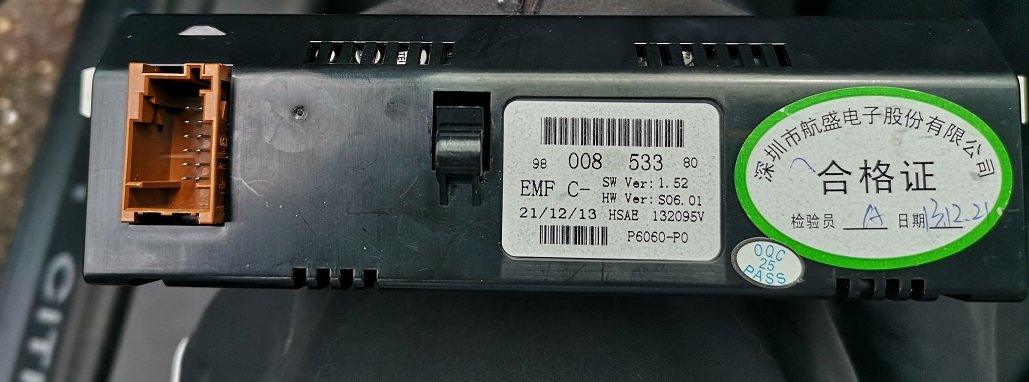

Before I order anything else can I check that the screen I have is compatible with a future RD45 upgrade and that my car can happily work with everything it's supposed to when all configured correctly?
Plus the pic of the screen, is it new enough? I ordered it before joining these forum so please forgive my cheap chinese version! Thanks for any help
Hmmmm, that Chinese writing looks a bit ominous.... where did you get it from?
Usually from others here who have undertaken that upgrade on later cares the software version of the EMF C screen needs to be 7.1 or later - so can't say if that will cut it or not for sure.
It was from aliexpress as mentioned in first post. From a link on a youtube video where the guy swops out an A for a C on a 207.
- x 6956
It's probably a copy then. Can't say if it will work or not...
