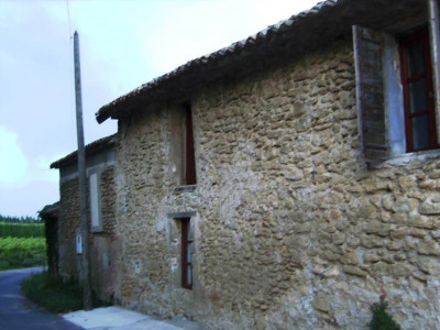

If one decides to go for the type that buries pipes in the ground, what sort of minimum depth do they have to be put laid?
The reason is that our gaff in France doesn't lend itself to placing the heat exchange radiators on the outside wall. This is the north side of the house and as you can see it's virtually on the road.
It's not good practice to put them on the south facing walls as they get really hot in summer which leaves ground burial. And here we come to the next problem. The water table is only about a metre underground and this makes digging deeper difficult - our next-door neighbour had many ground pumps running when they installed a sunken swimming pool. What sort of area needs to be available per room or square metre?
