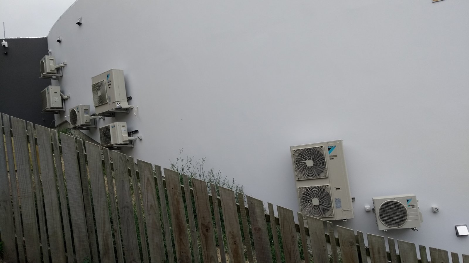

A house near us... I think I count 7 heat pumps.
We are currently thinking of converting our under- floor heating to have a heat pump. Probably a 9kW output air to water unit.

xantia_v6 wrote: 30 Apr 2021, 11:27 Image
Good stuff thanks everyone for the responses so far that but keep them coming. :-D I'll briefly get out of my armchair, as my ears pricked up to the air-water unit. More info on it gratefully absorbed.

Air to water for underfloor (or ceiling) heating is quite good. The operating temperatures for underfloor heating are lower than wet radiators by a fair level. You can install a ceiling water tubing based heating system that also gives out infra red heat and, no, your ceiling doesn't need to glow orange! These lower operating temperature systems are well suited to heat pumps/extractors.
