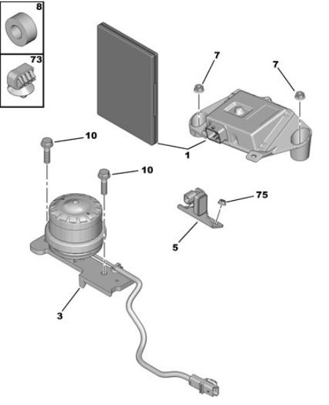

Just in case you are interested Julian, this is the system fitted for the DW12C engine on the X7:
(1) Is the Damper Electronic Unit
(3) Is the Active Damper Actuator

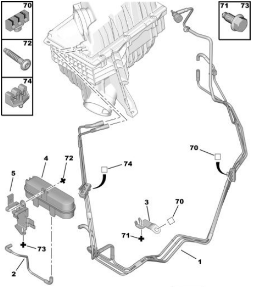

... and on the 3.0 HDi
(1) & (2) EGR Control Vacuum pipes
(4) Vacuum Reserve
So whether this has some sort of pneumatic cushioning hovercraft inflatable whatsitsname thingy... hence the Carlos Fandango inference...
