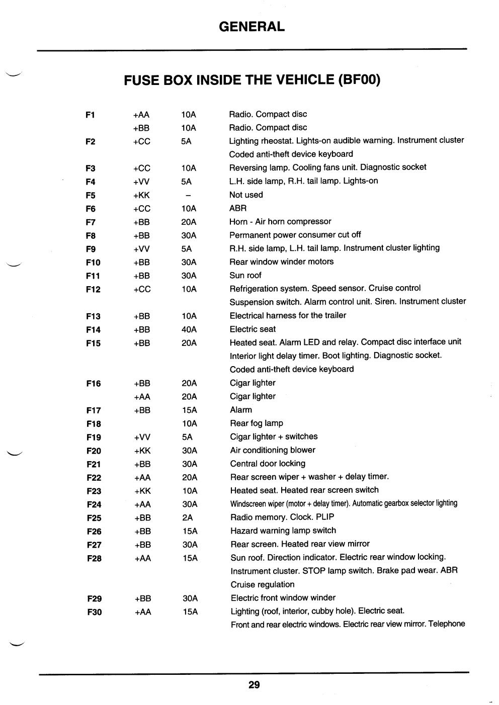

Do you have a any fuse box diagrams showing what is what by any chance?
Liam
1995 Xantia Activa
x 1746
Re: Activa procured!

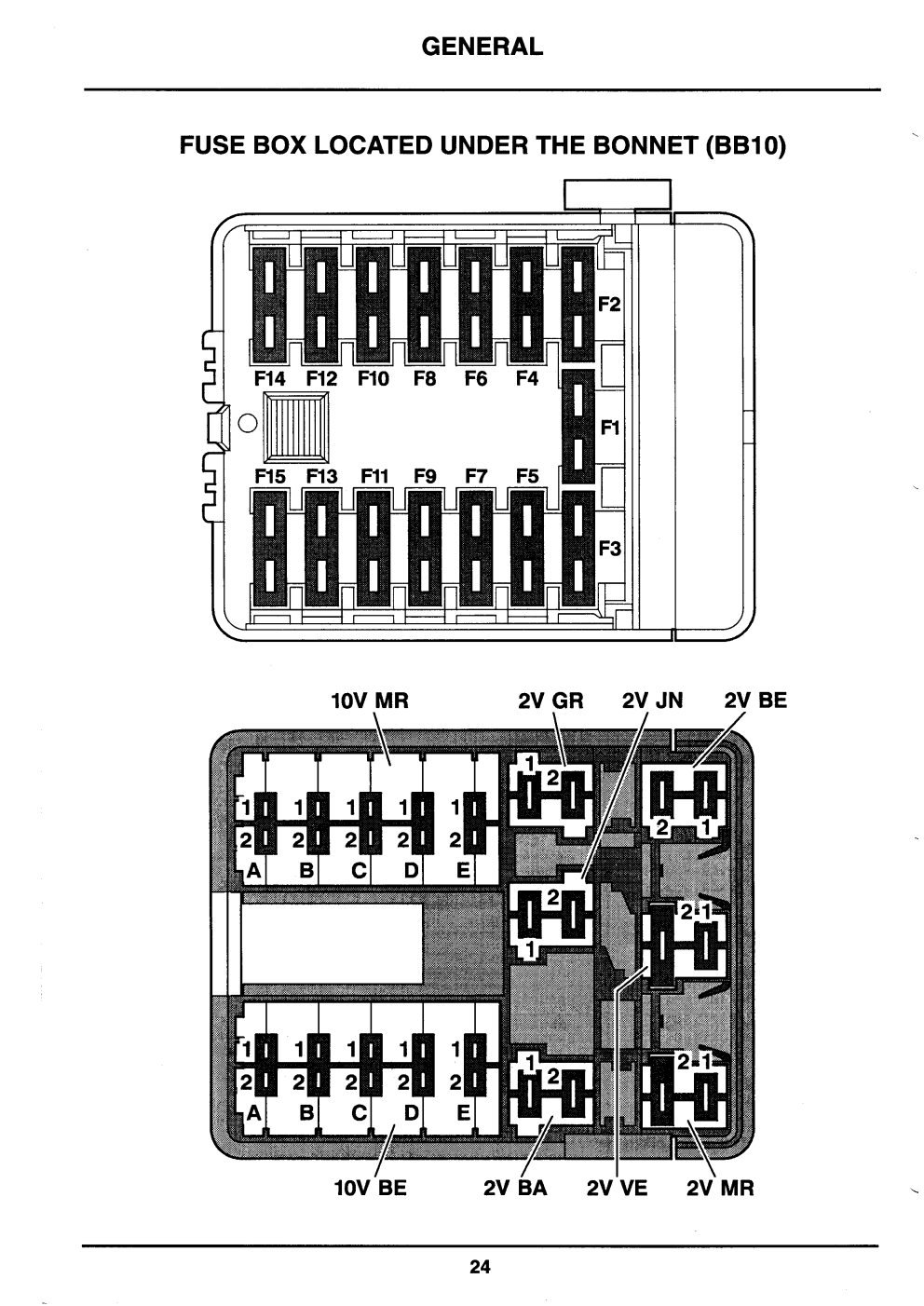

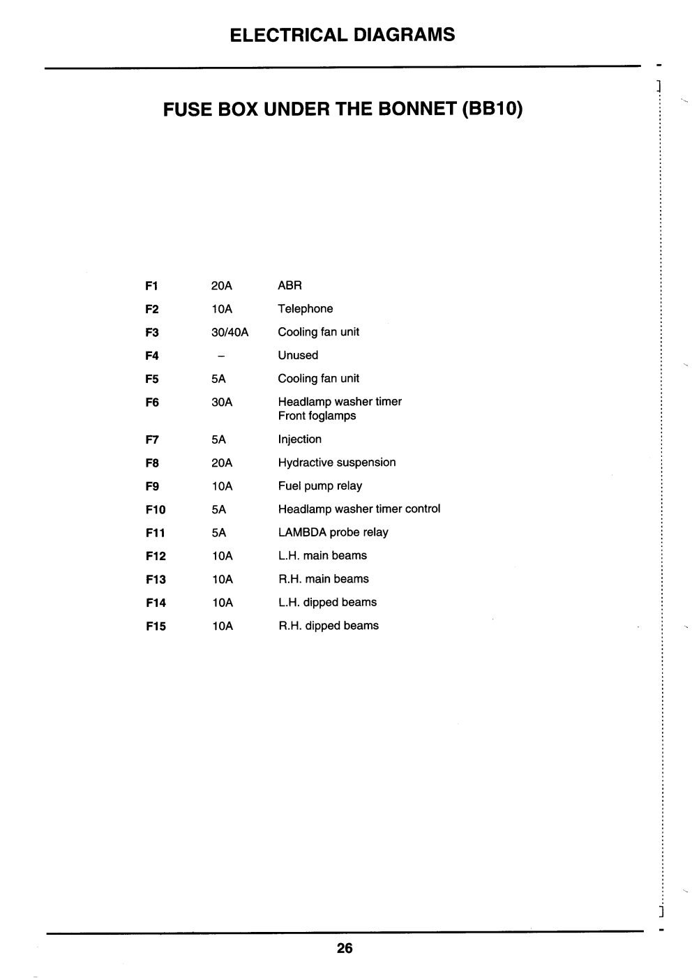

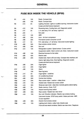

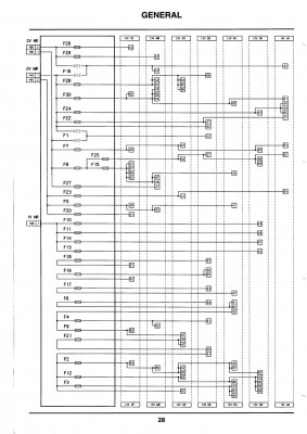

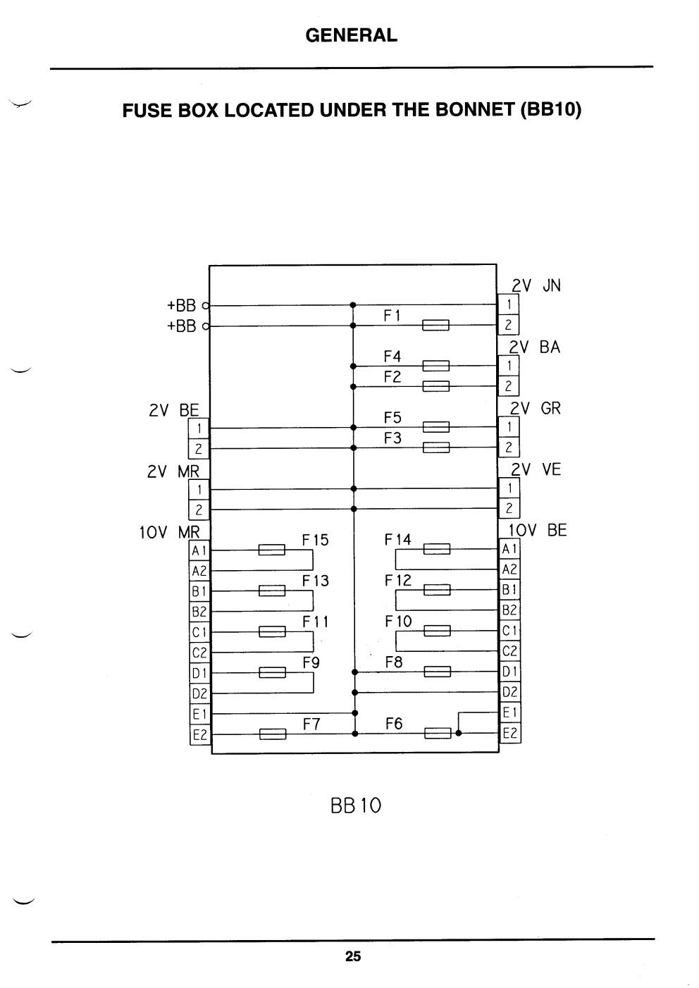

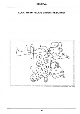

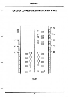

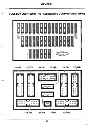

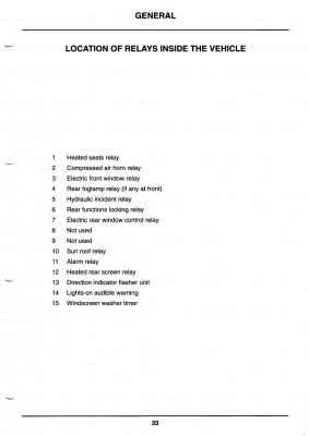

Cento, if you can post your VIN, we should be able to post fuse box details for the car.
Cento16v
Posts: 47
Joined: 23 Apr 2016, 00:13
x 9
Unread post by Cento16v »
Cheers
Liam
Liam
1995 Xantia Activa
x 1746

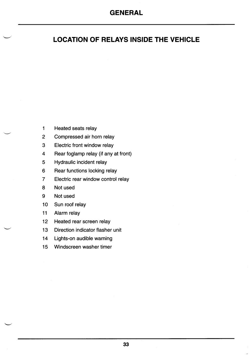

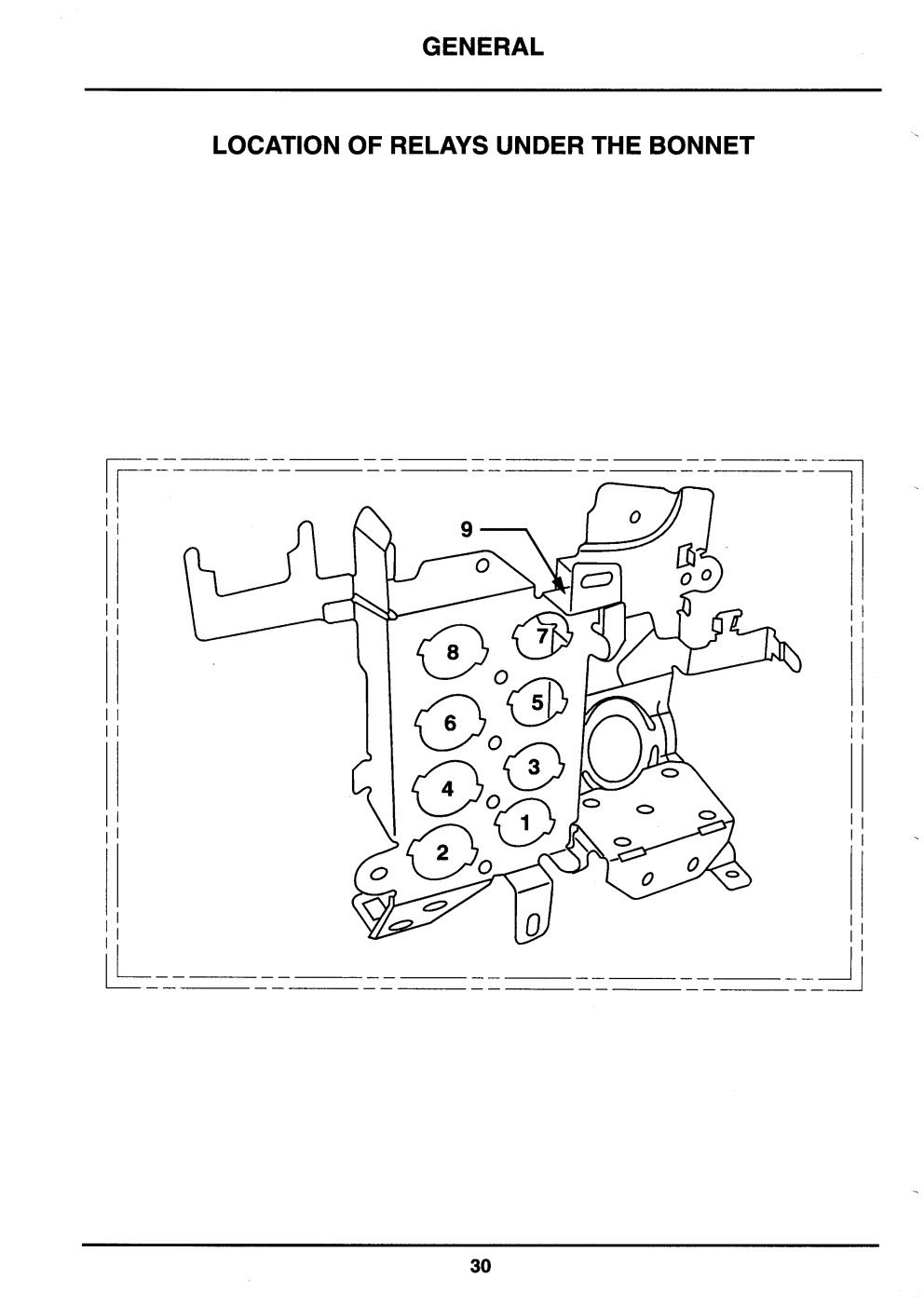

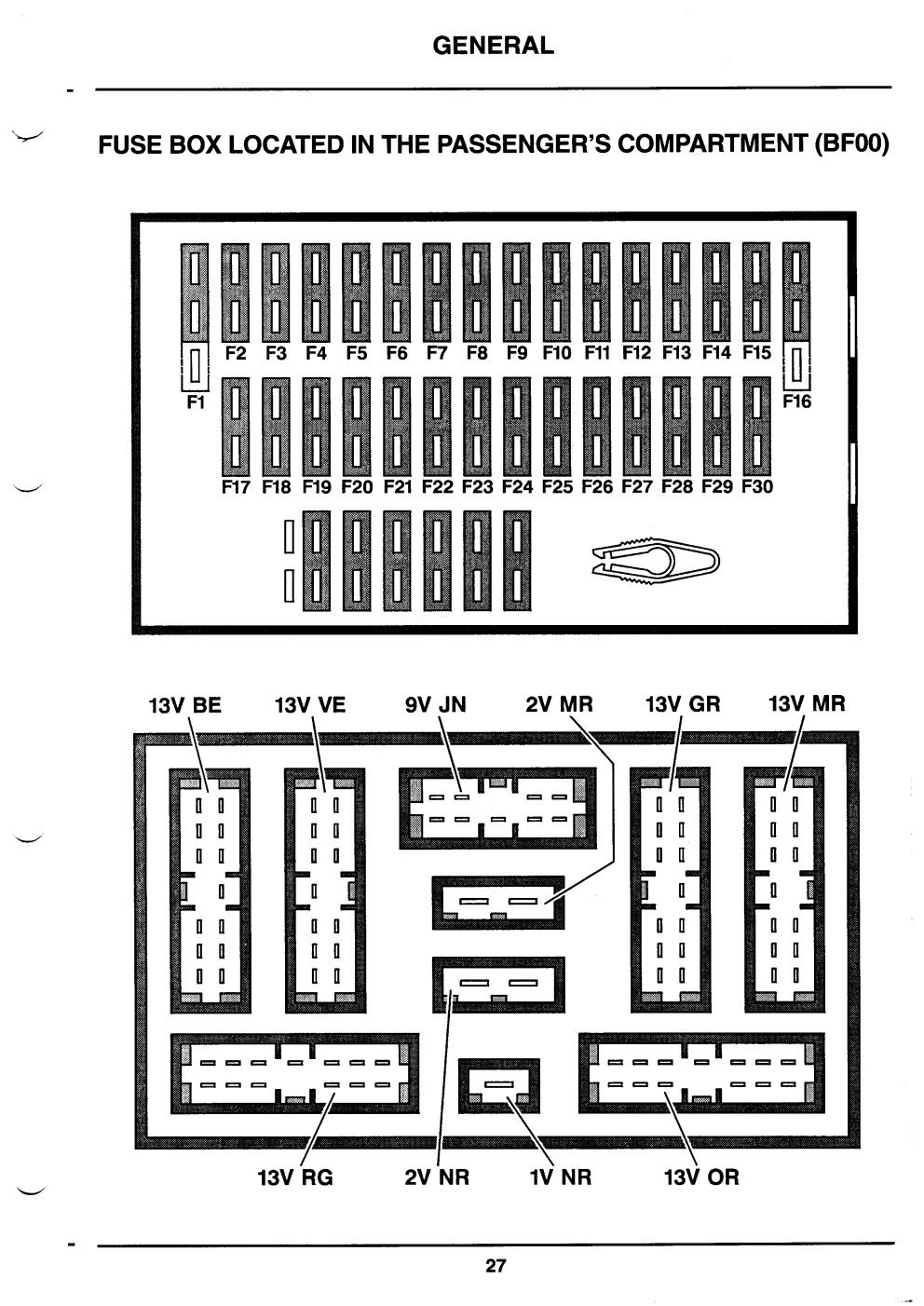

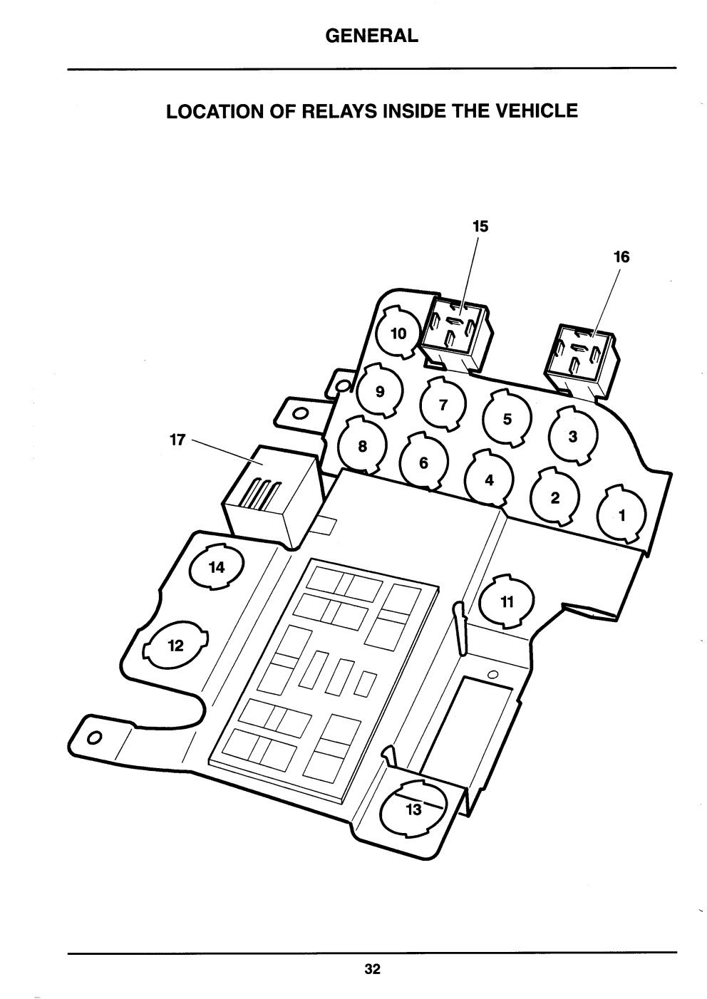

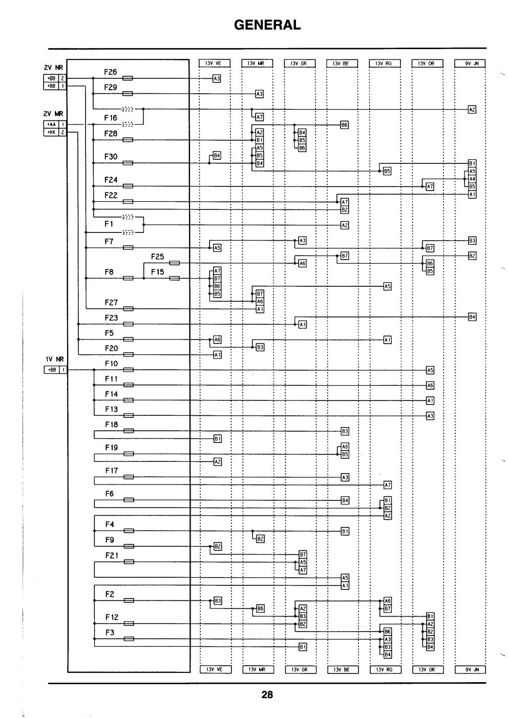

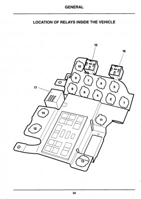

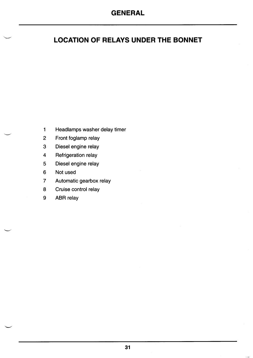

Hi Liam,
Xantia 5dr Saloon 2.0i 8v turbo BVM5 XU10J2TE
RPO 6944 (= 13Nov1995)
Fuses and relays...
Fuses, passenger compartment _1
Fuses, passenger compartment _2
Fuses, passenger compartment _3
Fuses, engine bay _1
Fuses, engine bay _2
Fuses, engine bay _3
Relays, passenger compartment _1
Relays, passenger compartment _2
Relays, engine bay _1
Relays, engine bay _2
Source: EWD BRE0071 Oct.'94 for MY1995

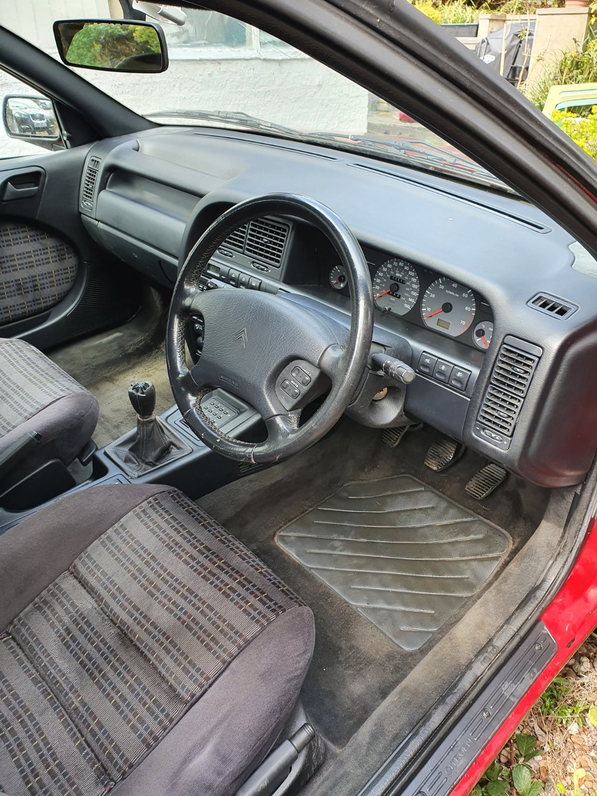

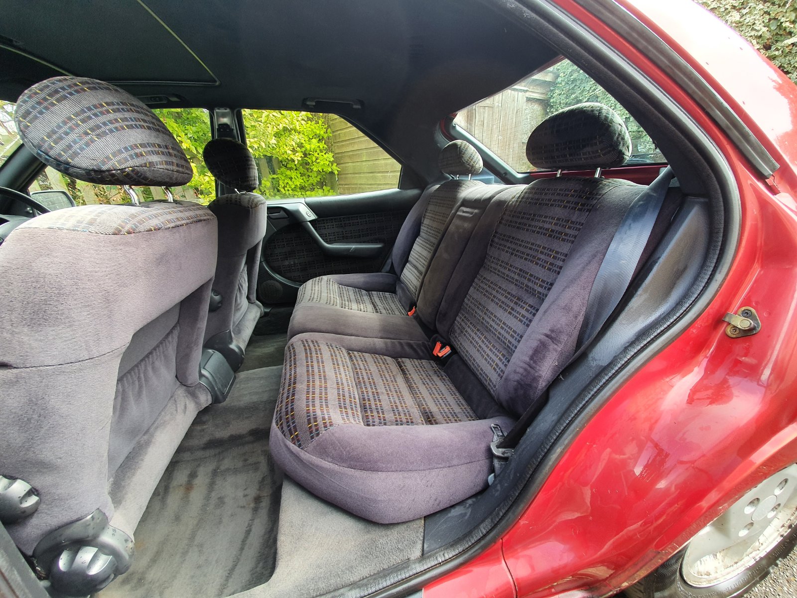

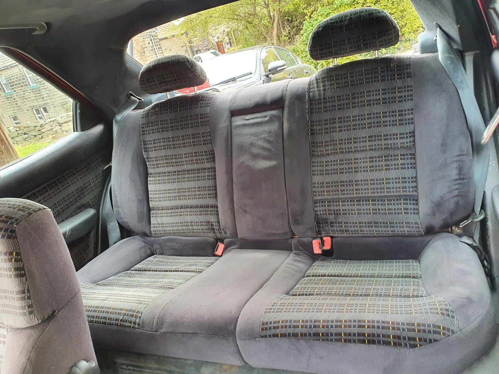

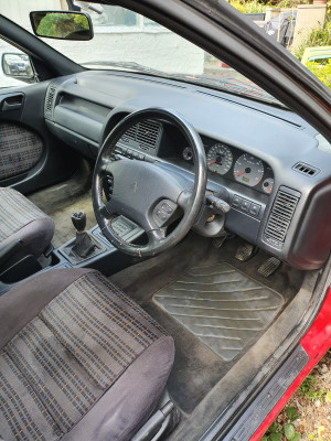

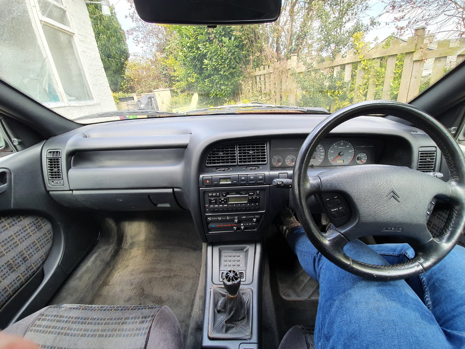

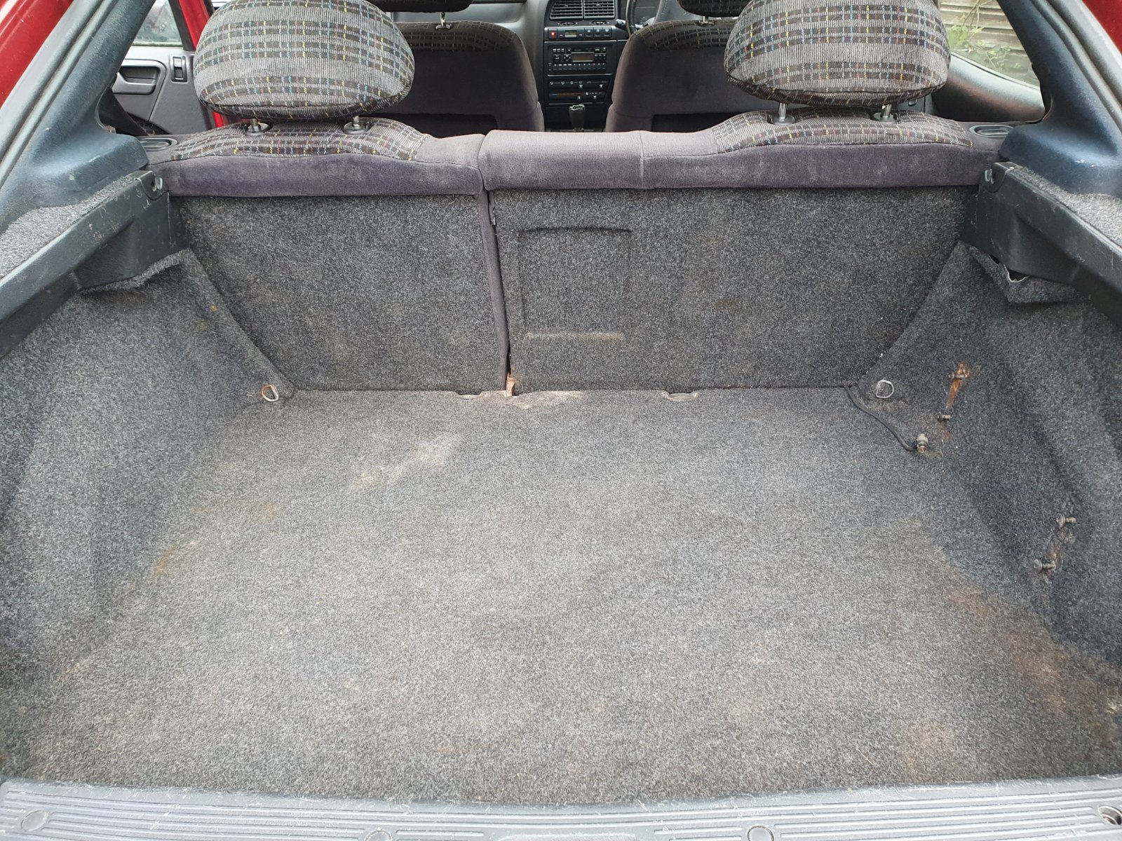

Well, its certainly somewhat more habitable after today!
Absolutely knackered, wasn't helped by the OSR door not opening either!
Ah well, all is forgiven now I'm in the beer garden!
Liam
1995 Xantia Activa
Posts: 55172
x 8437
That's looking hugely better :D
