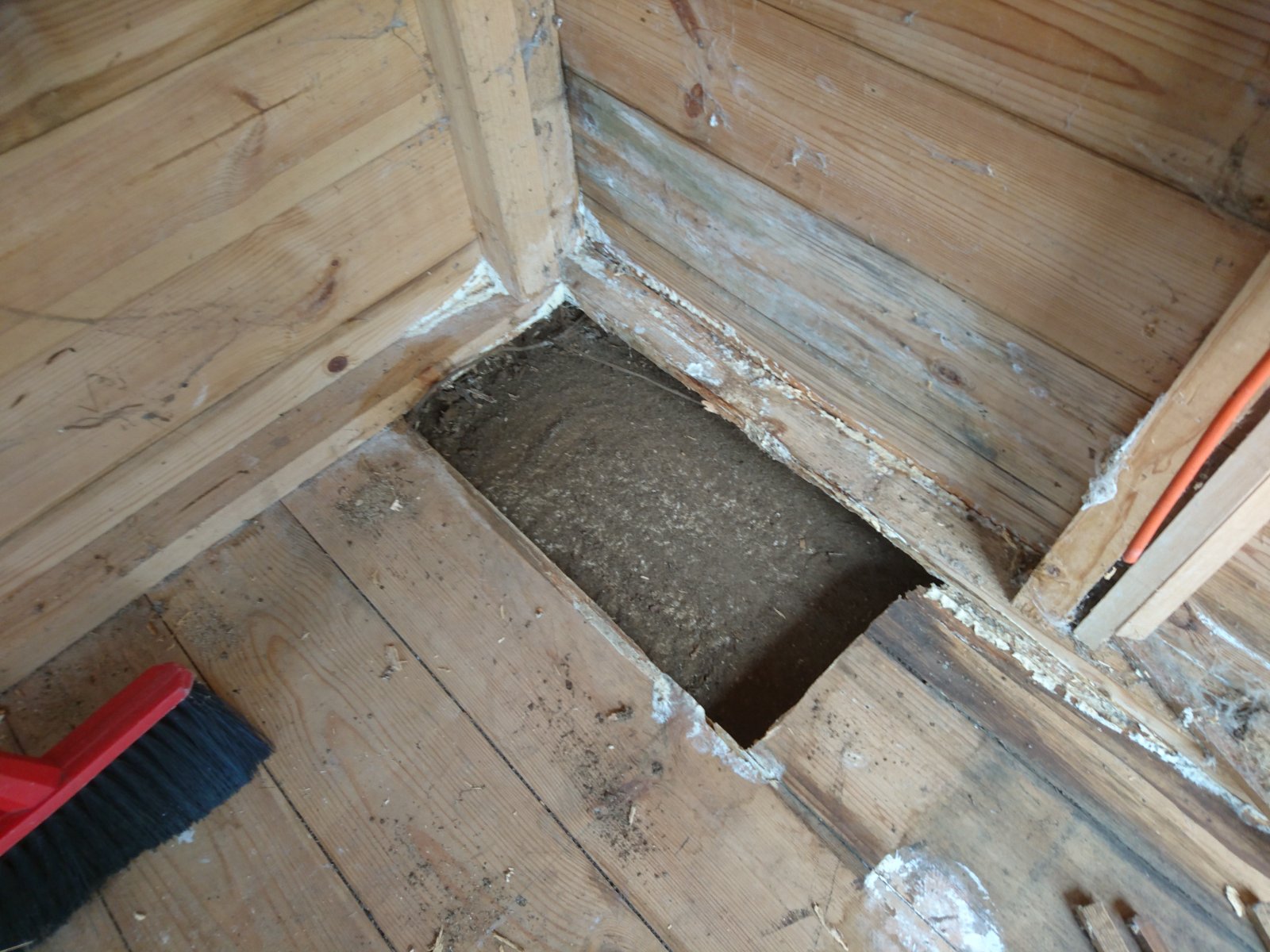

I looked at the job:
Own work
Own work
Own work
Own work
Own work
Own work
I had a little think and decided that only the last 700mm of the 2 boards at the end were rotting. It is clear that the cause was enemy action from our long time rodents in the garden so I felt that simply replacing the boards would only give them more to feast on so I decided to resort to my good old favourite postcrete to fill the void between the shed floor and the concrete base beneath, thus preventing any further attack. I know the reality is they will find an alternative thing to destroy but hey, it's an ongoing game we play, last time it was the greenhouse and having postcreted them out of there they have gone for the shed's weak points at the back corners!! So I set about removing the rot and preparing the surfaces for postcrete filling:
Own work
Own work
Own work
Own work
Then I had to shoot off to B&Q for £4.50 worth of postcrete, which is 20kg to those that are taking note of what I'm up to, and a couple of boards to replace the wood with. On my return I gave the neighbouring timbers a coat of bitumen, all I had in stock, and filled the cavities with the postcrete:
Own work
Own work
Own work
Own work
Then it was out with the watering can, liberally wetting, not soaking, the postcrete before inserting the new bitumen backed boards.
Own work
Own work
Not elegant by any stretch of the imagination but I am fully confident that the rot is gone, the enemies expelled and we live to fight the next war.

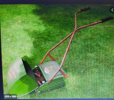

That looks like an old Super Panther mower, and if you used the rear roller on it to tamp down the sharp sand before you laid the block paving......... then how come we can't see your horses tethered to a gate or your cowboy hat sitting on a post somewhere ? :lol:

good work that man that knew it was a Qualcast Panther! What a diverse lot we are!
