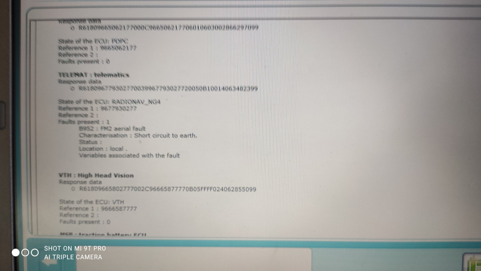

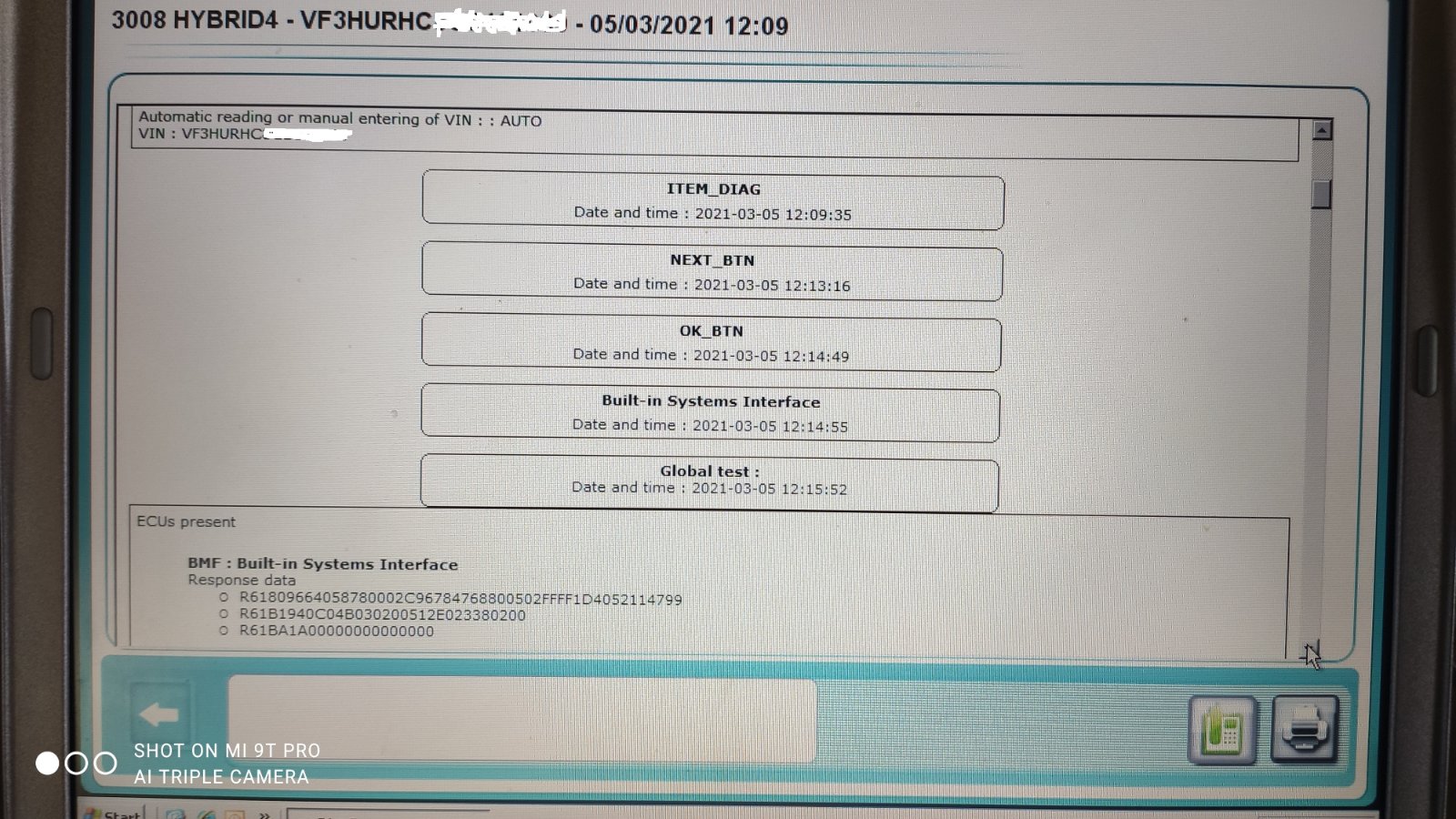

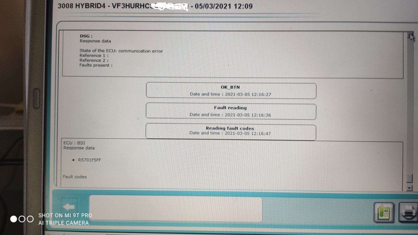

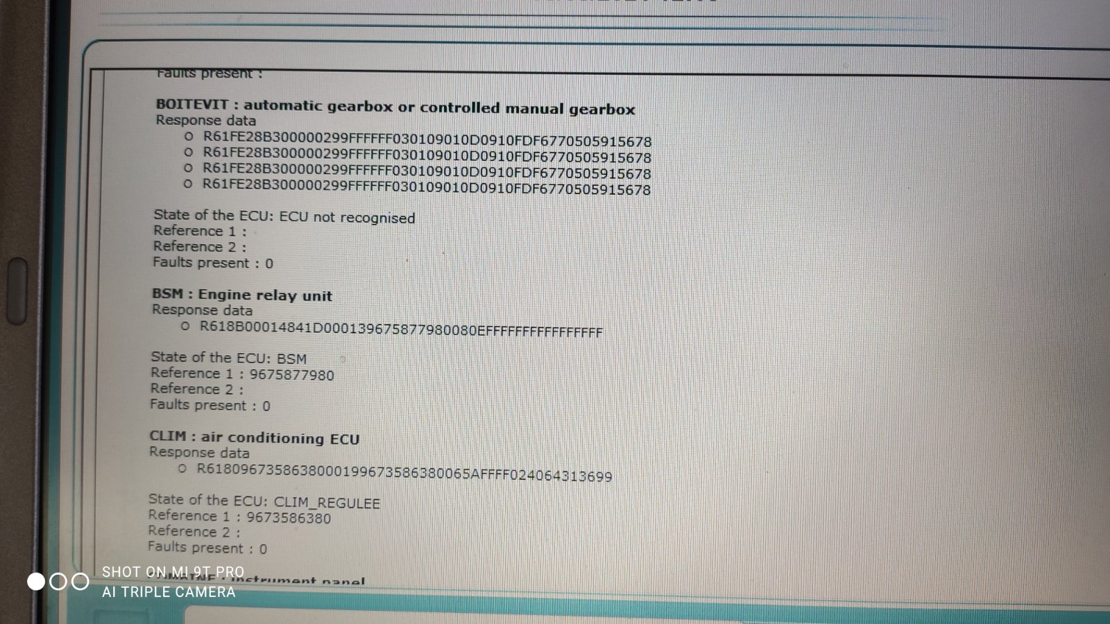

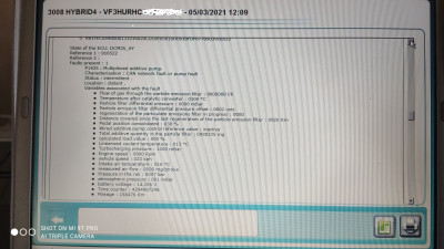

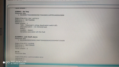

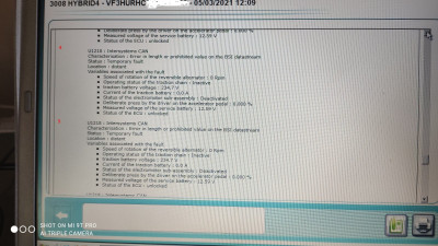

This is a series of screen photos of the last Diagbox session I did with the new Exide battery fitted. Anything obvious in the faults to point to battery draining and or airbag fault, engine repair fault, aerial fault.

sorry the pictures are in reverse order. Bottom photo is the start of the report. I skipped a few bits as there was nothing to see and never has been in all the reports I have.
