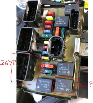

I assume my problem is RL2 in PSF1 (fuse box) as I have no 12 v power on Fuses 10 and 5
A few questions if I can
a) do you have a BSM relay id chart (assume its the one in the corner diagonally across from F10 and F11 - see pic)
b) I take RL1 in PSF1 is part of the ignition circuit, which powers up RL2 and the ECU (eg wire 1229 on pin 9 goes to the ECU which goes negative to activates RL1)
c) I assume F1 in PSF1 is the yellow 20 amp fuse next to Fuse 11 (40 amp) - I have 12.9 volts in this fuse so assume RL1 works
d) any ideas why the voltage on Fuse 10 and 5 drops around 1 volt when I apply a wire from the battery (eg reads 11.8 volts) ? When I leave it on and test the other fuses they are reading around 12.8 volts - bad earth or circuit connection some where ? Also the radiator fan turns on but stops after a 30 secs but voltage seems to stay at 11.8 volts
e) I take the injectors (11331 to 1336) are negative / earth triggered by the ECU given they are fed by 12 volts off RL2 / pin 24 on PSF1 (says wire 1355) - any hints which is pin 24 ? I assume on connection 26Y NR (black) as per pic
f) what does not make sense is the ignition coils are also fed by F10 wire 1355 - I have spark so they must be getting 12 volts from F10 (when not hot wired)
g) I also see wire 1355 feeds into 1382 (but have no idea what it is as its not on my peugeot how to read wiring diagram sheet)

A) This is the only internal I have of the Fusebox showing the relays:
C) Yes F1 is 20A for the Engine ECU and Cooling Fan electronic Mixer.

I'm noticing RL1 and RL2 are both controlled internally by the ECU, RL1 via pin E1 in the 48 way black plug, RL2 through the microprocessor in the BSM, again driven by pin M2 in the 48 way brown plug. Since RL2 feeds all loads related to the engine running (injectors, coils, lambda sensors, high pressure solenoid), I'm guessing that maybe the ECU closes it only when the engine is actually cranked, so that would explain how it can be that you don't find 12v at F5/F10 while just with ignition on, but coils and the rest work (and you actually have an issue only in the injector circuit), and would also explain why feeding 12 volts to the output of RL2 doesn't make any change. Have you tried measuring voltage on F10 while cranking? Just a thought, maybe with no sense, but it's something that came up on my mind.

After that it seemed to try and fire a few times but not run so confirms a fuel / injector issue - lots of fuel pressure in both injector lines when i pull the connectors off so assume pump is working
A few questions
a) would the P0335 engine speed / crankshaft sensor error (says open circuit) cause a crank but no start condition - I've put a new sensor is so assume its working but may be a wiring issue
b) I swapped the VVT's eg rear to front. front to rear and tested both with a 12 volt battery that they pumped up and down) but still have a P0081 rear VVT (open circuit) - again wiring ?
c) I get two P0335 engine speed sensor signal error come up in Diag Global test - all the data is the same
d) still get a communication error anti-theft alarm come up but no OBD code l
