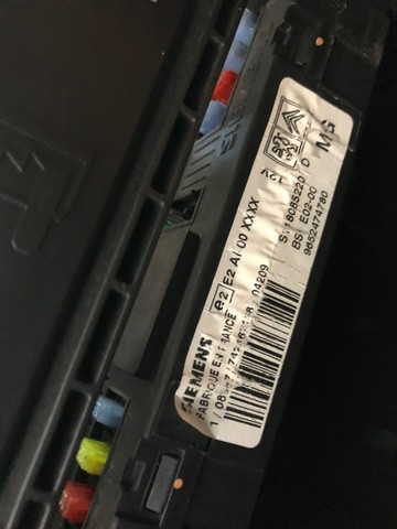

BSI sticker:

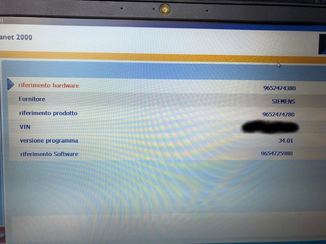

BSI specs (you see version 34.01):

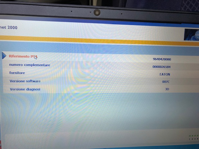

ECU specs:

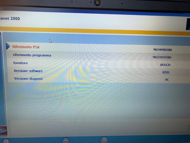

COM2000 specs:

Thank you so much, didn't think about that variable, so that different trim levels with the same software versions might not be able to telecode some options... Guess it has to do with the MG/HG marking on the sticker itself (which I guess is Moyenne Gamme/ Haute Gamme)...
Nice to know! I'd love to know the differences, whether the're just software sided or hw too.

So you have the Mid Range BSI: These were fitted to the 206, Partner and 1007 (VAN multiplexed architecture).
BG => Bottom of the range
MG => Mid-range
HG => Top of the range
All the replacement BSIs for these cars were subsequently replaced with the HG version if they were ever replaced from Peugeot.
