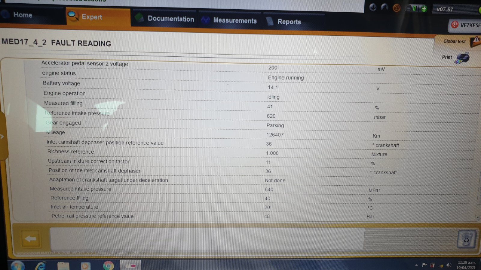

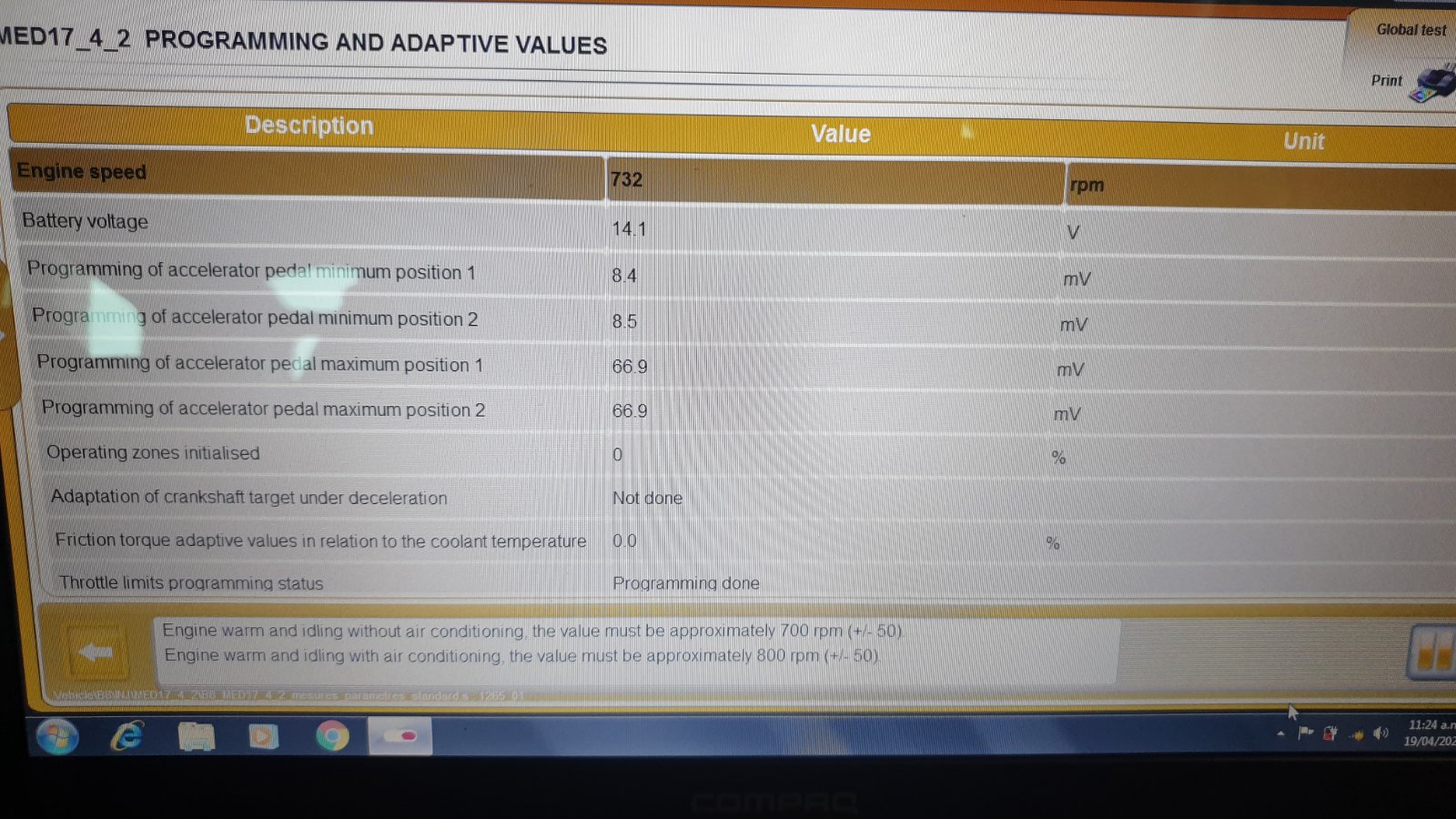

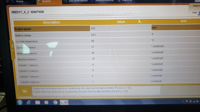

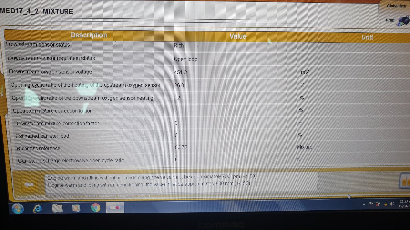

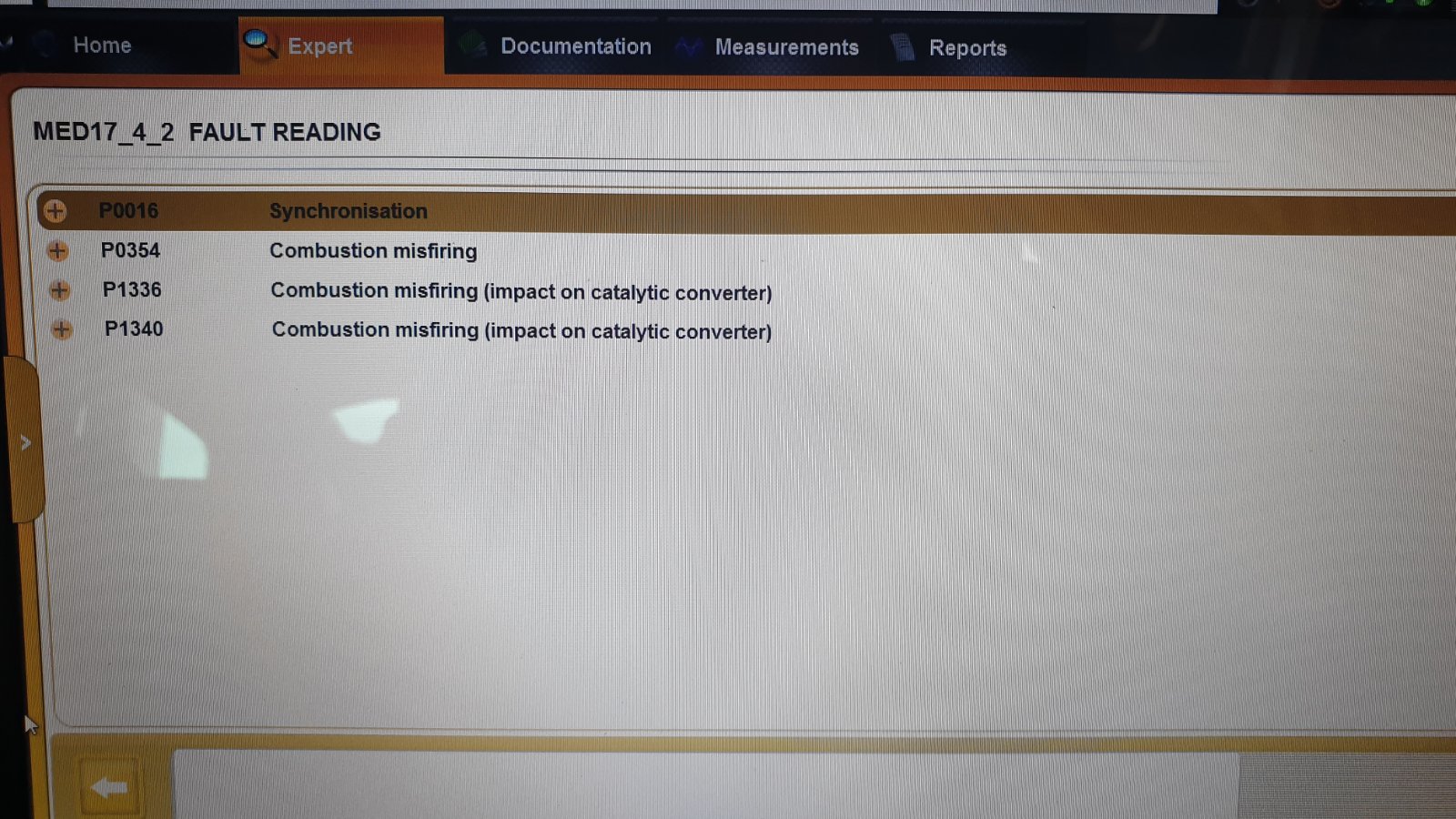

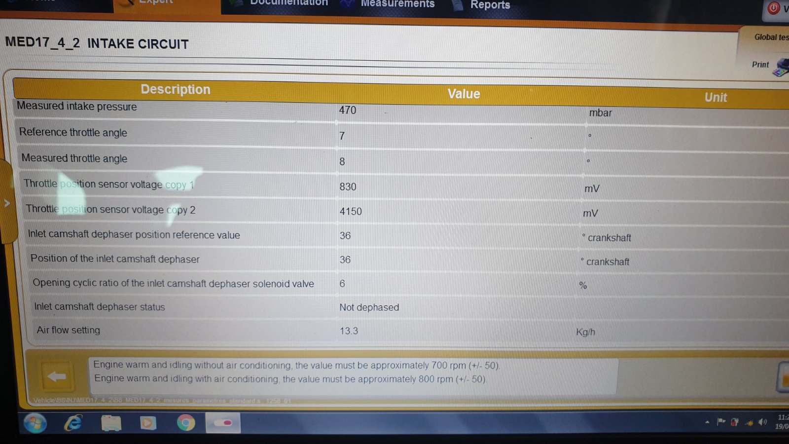

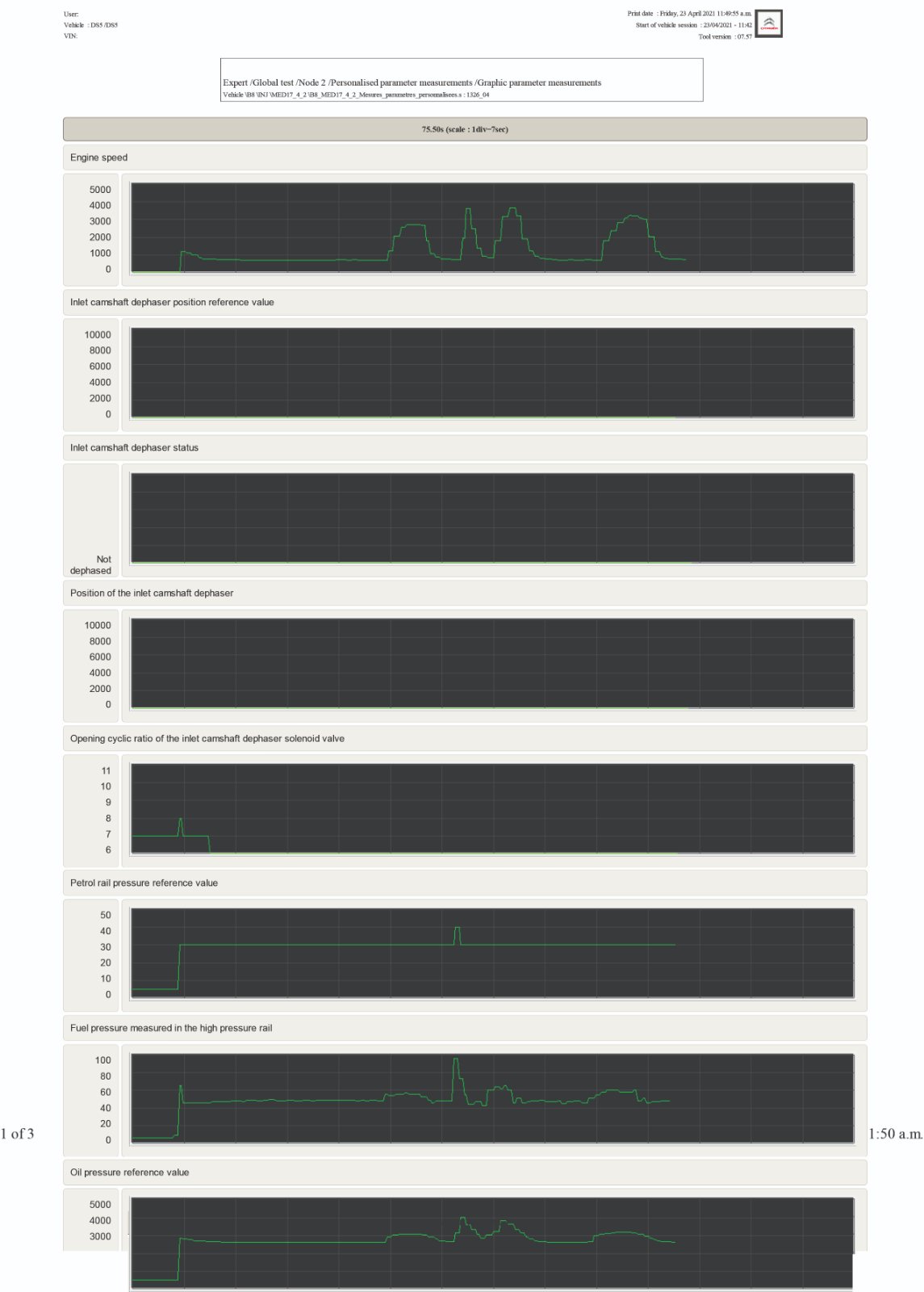

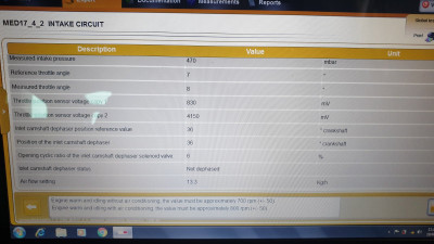

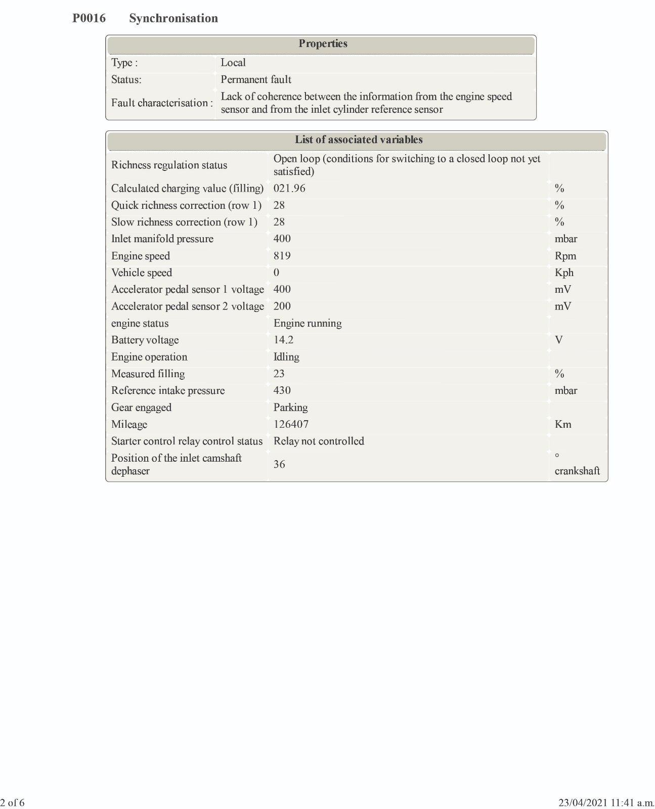

I've purchased a diagbox interface to give more in-depth diagnostics than what my other equipment can provide. It shows the camshaft dephaser at 36 degrees which I believe is correct?

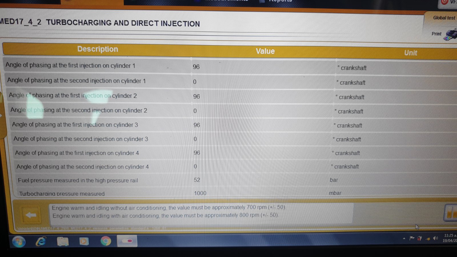

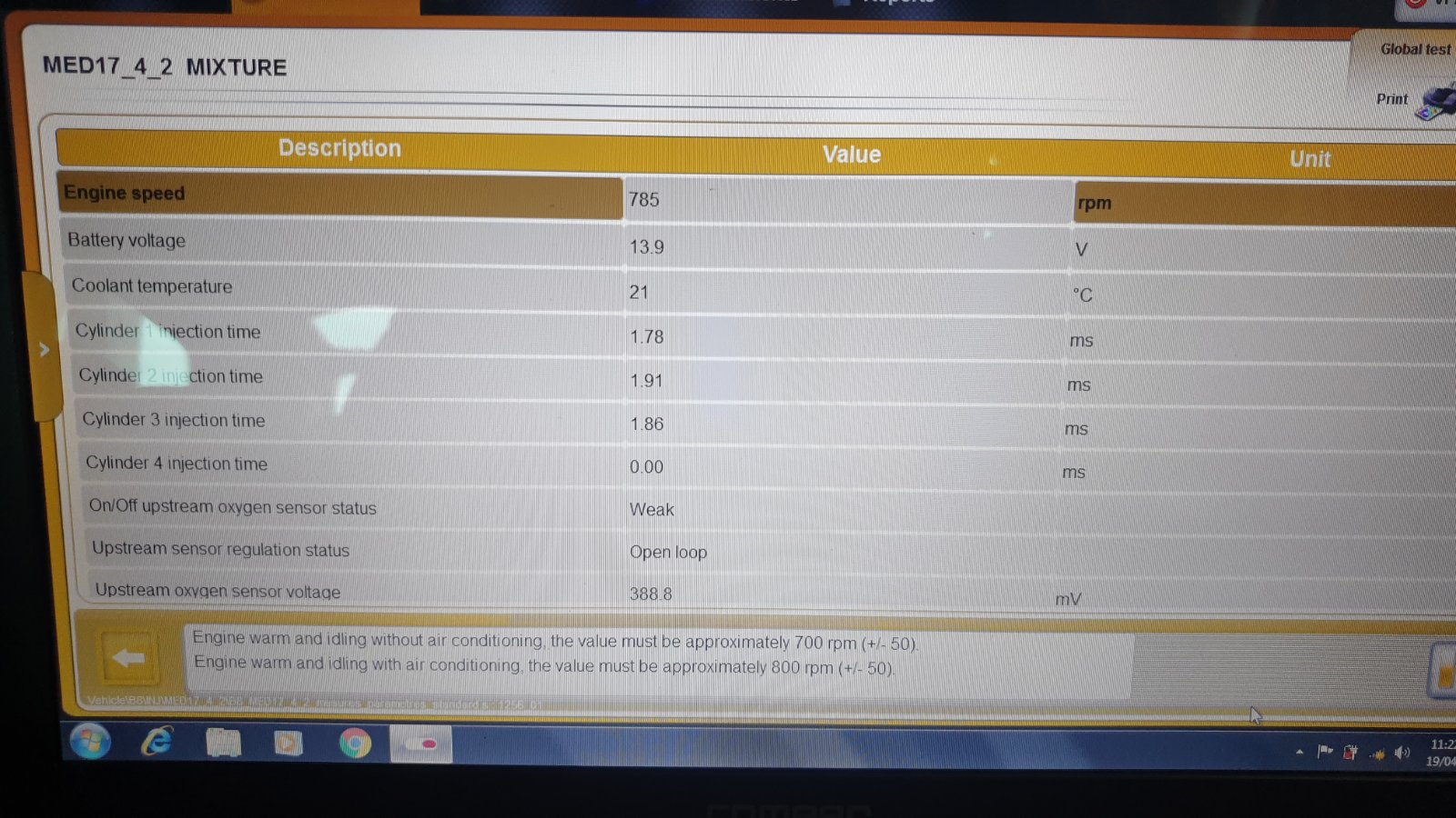

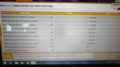

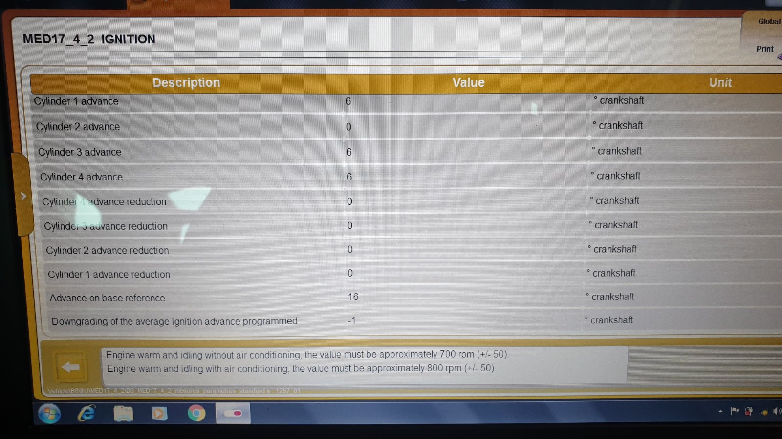

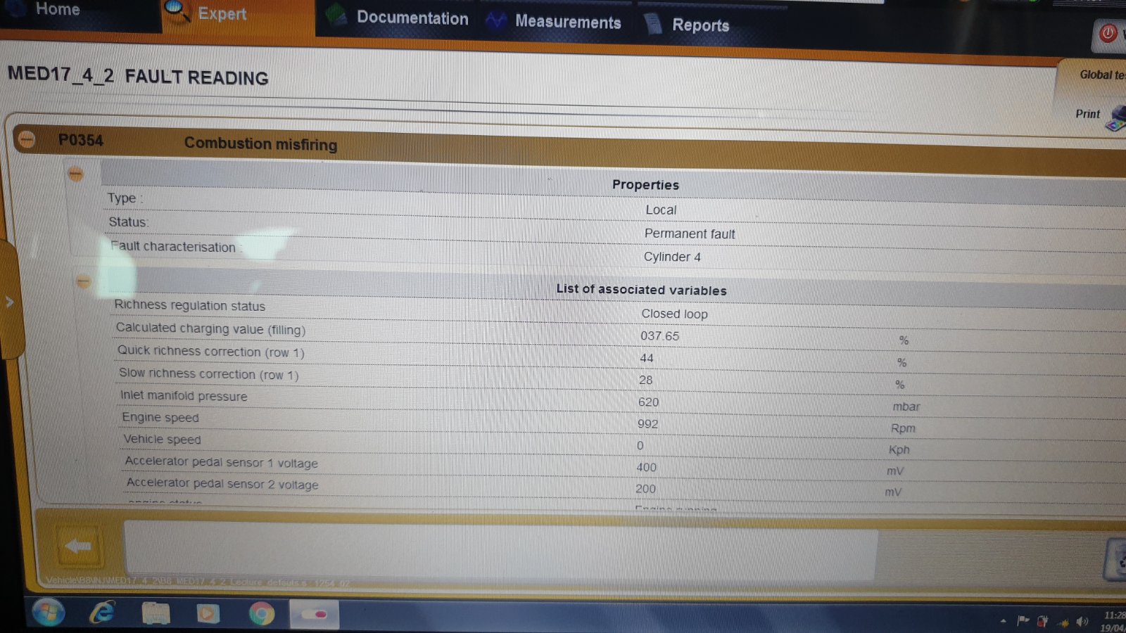

One interesting thing I found was the injector timings. I'm far from knowledgeable in this area but cylinders 1-3 are showing <2ms while cylinder 4 is flat 0.00ms. Does that indicate a faulty injector or something else?

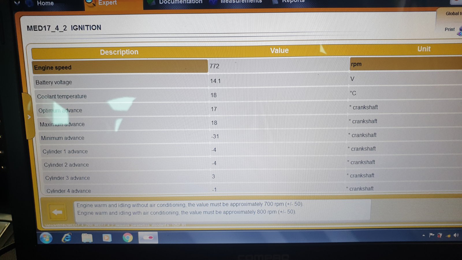

I would be very grateful for any assistance in analysing these values and figuring out a solution or even just pointing me in the right direction to look. Apologies for the photos, anytime I try to print/save a page from diagbox the program crashes. It may be easier to view them here https://imgur.com/a/67ywP5p

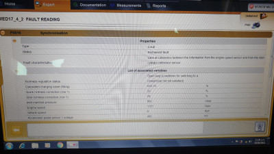

I'm not an expert in any way, but from what I'm seeing there's definitely an issue with the camshaft sensor. The code P0016 reads as "lack of coherence" between what is given by the crankshaft sensor and what is given by the camshaft one. P1340 and 1336 both refer to anomalies in the signal read by the cam sensor (out of range or something like that). P0354 refers to fault in the ignition coil of cylinder 4. I bet that since it gets faults from the coil (open circuit? short to ground?) it stops the operation of cylinder 4, thus showing 0 ms of injection time. You should try, multimeter at hand, to measure the feed to the cam sensor, it should have +5v, GND, and signal out. With the engine off, the signal wire should have (usually, I don't know your engine) +5v or GND if it's a pull-down or pull-up magnetic sensor, respectively. If all reads out, using a scope you should chech what reads at the signal output of the cam sensor while cranking. You should obtain a squareish wave signal alternating from +vcc and gnd. Measure the ignition coil 4 too, to check for oper circuits or shorts to ground. Inspect the coil visually too, sometimes the insulation gives up and starts shorting on the engine head when sparking.
Don't know if you can see the cam sensor reading from live data in Diagbox, that would tell you if it's reading or not. You can try also actuating the coil 4 with the spark plug on it to see if it's sparking ok.
You already cleared the codes after fitting the new timing chain?
I'm just following a line of thought, might be completely out of track, as I'm not an expert.

To my mind something is causing a misfire which the cam sensor detects, which causes the car to shut off cylinder #4 in order to protect the catalytic converter. I believe that's the link between the cam sensor/coil/injectors, and the cooling fan activates when the car detects misfires as far as I know.

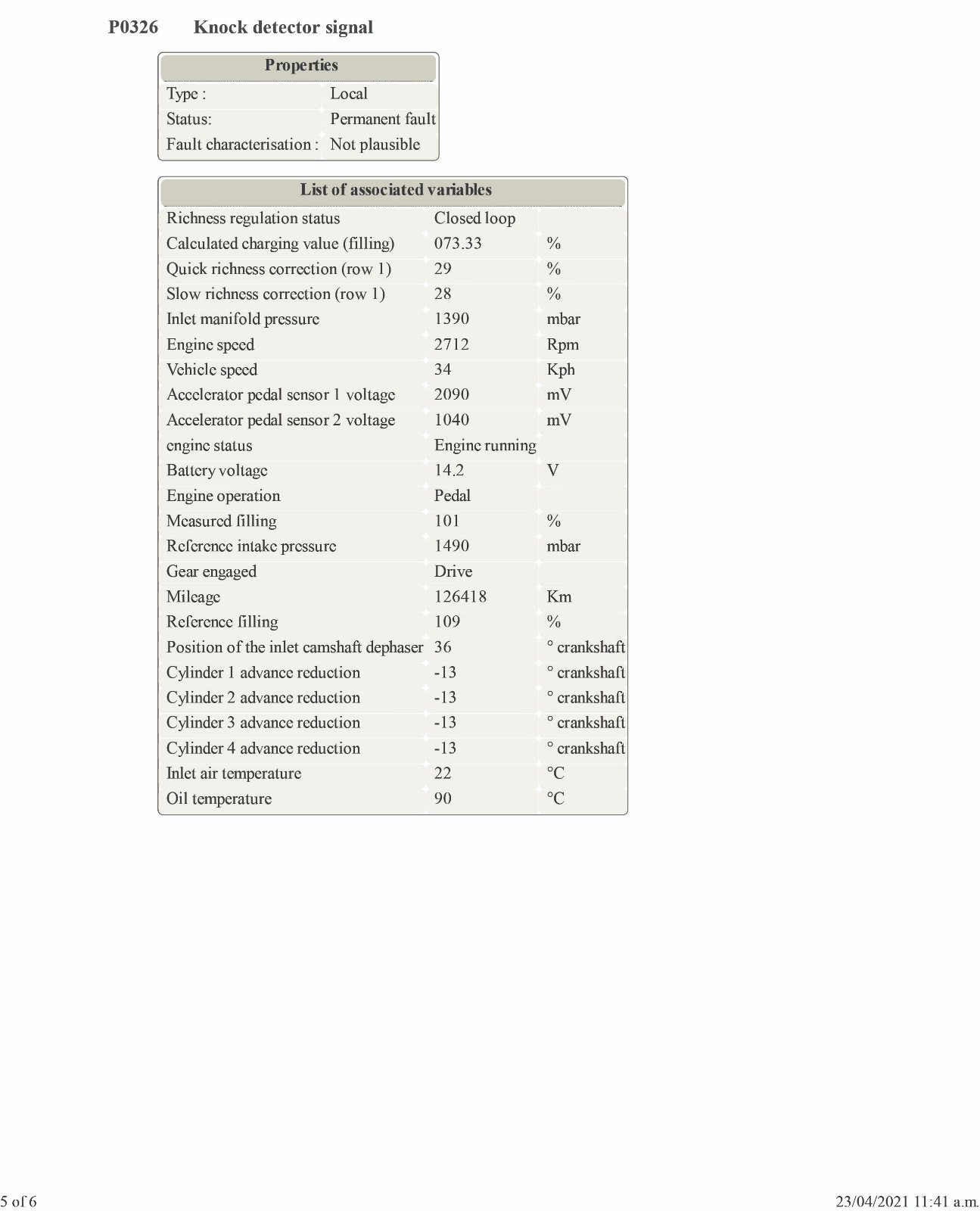

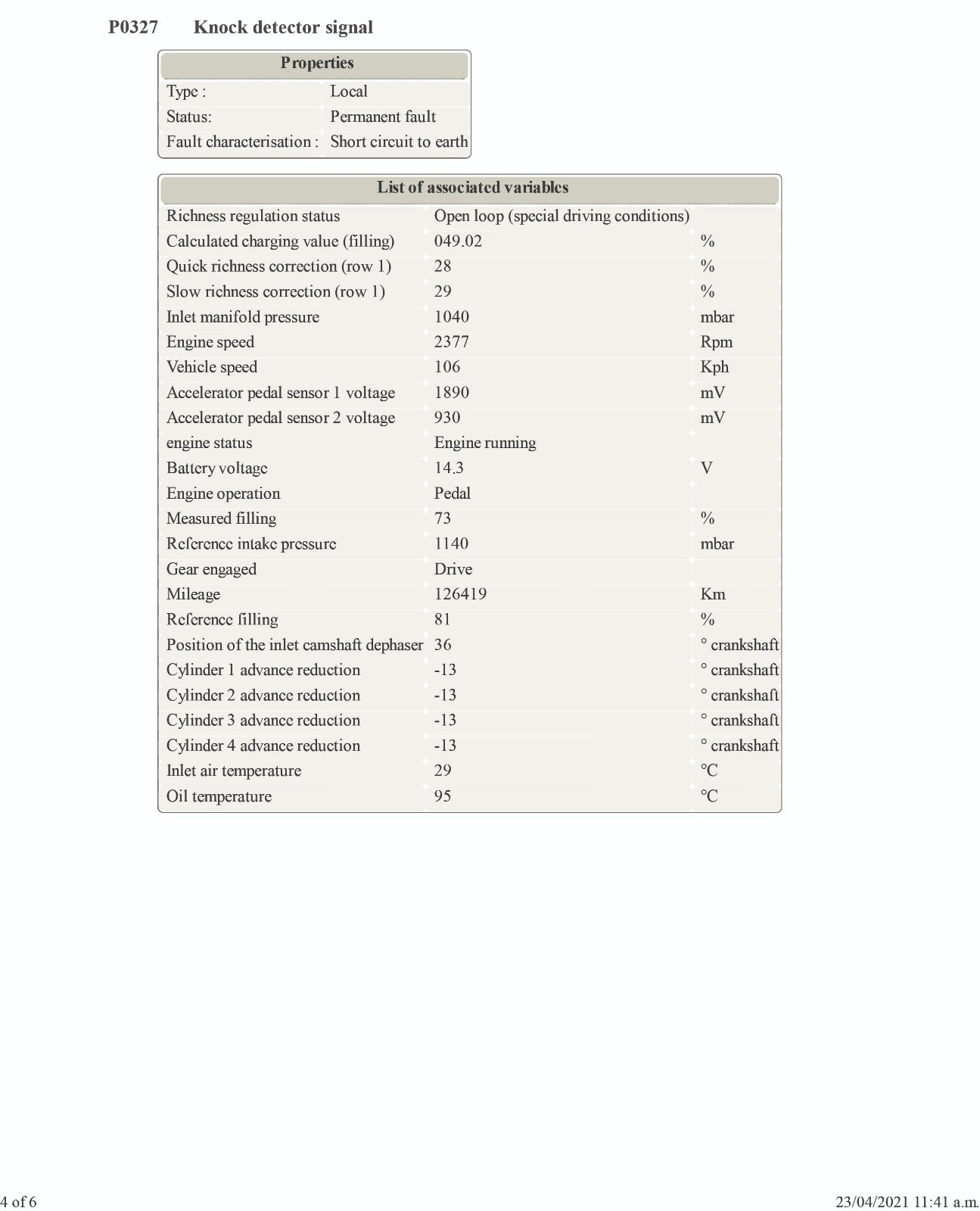

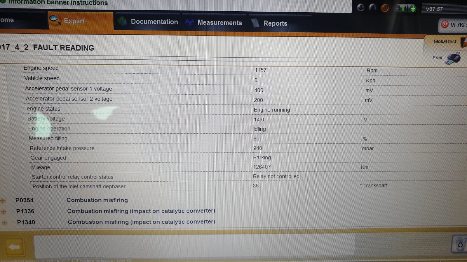

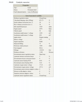

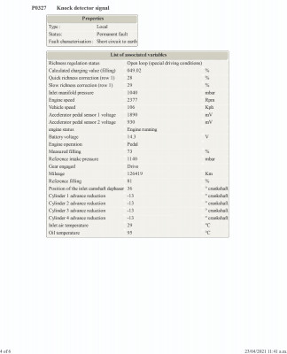

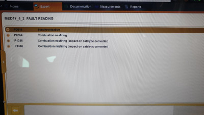

Just reconnected the cam sensor and the car started up and appeared to be running ok. Strange. I took it for a 15km drive and then brought it back home where it had a few new codes for me. Attached are the reports I managed to get, as well as some live data I recorded while it was running. I'm not sure what to make of it, doesn't appear that the dephaser is doing much. Looks like I can rule out the HPFP as a potential cause.

Hmmmmmmm... There's a knock sensor fault, short circuit to ground. Knock sensors are piezo accelerometers, if it's faulty it may well be that it tells the ECU that cylinder 4 is misfiring. You should test it for insulation to ground and values between pins. If I were you, I'd start to check for shorts among wires too. Unfortunately now diagrams would be pretty helpful... Cam dephaser seems to be stuck at 36°, no matter the opening or closing of the inlet valve. I don't know the VANOS system installed in those engines, whether it's continuously variable (maybe with a PWM signal to the solenoid) or discrete (by which I mean off or on). It might be that the ecu won't allow the vanos system to work if it detects misfiring. However that doesn't explain why it continuously reads 36°of dephaser angle (is there a sensor? that might be well worth investigating).
As I'm writing, I'm thinking that if the engine dephaser angle sensor reads 36° continuously, the ecu thinks that the camshaft is actually rotated 36°, but since it is NOT actually dephased, it's tricked in thinking that there's an incoherence between cam and crank sensor, since it expects a signal dephased 36° with respect to the crankshaft signal, while the signal it receives is (correctly) not dephased. That would also explain why the solenoid valve is never operated even at mid rpms (3/4000 as per graph). And it would explain why without the cam sensor the engine ran better, since without the closed loop the ecu doesn't try to adjust parameters to recover from a nonexistent dephasing.
That may be bollocks anyway, it's just something that struck my chain of thoughts as I was thinking on how the system works.

Another thinking... it may be that the pulley itself is stuck or stiff so the readings are consequently wrong, since the cams are not dephased anymore even if they're told to. That pulley seems to be a bit finicky and not so reliable.

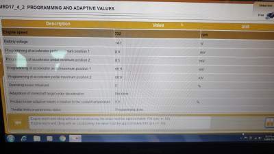

Just to make sure... are the injectors coded correctly, aren't they?

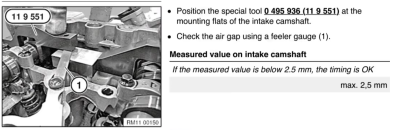

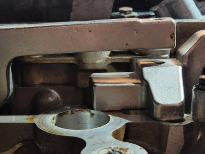

I finally dove back into this determined to figure it out. I went back and checked the timing and the cams seemed to be slightly misaligned. I was scratching my head after another few attempts at timing it. I would lock the cams, then with the tensioner in torque the cam sprockets to 20nm. Rotate the crank a few times, relock the flywheel and cams, and the intake cam was consistently a little bit out every time. After the third time I had a good look at the locking tool and found a bit of play in the intake cam side (must be poor casting). The next time I packed the back side of the tool with a .3mm feeler and lo and behold it held timing perfectly. After an adaptations reset and half a dozen code clearing then drive cycles the pesky code seems to have finally gone.
Checking the BMW TIS shows that the air gap where the tools meet must be less than 2.5mm, which translates into a much smaller misalignment at the cam itself. Mine was definitely more than that. After packing out the tool the gap was zero, and now the car runs without the P0016 code for the first time in ages.
Check out the original gap once the flywheel was locked! Anyone who buys these cheap locking tools needs to know this feeler gauge trick.

Re: Trying to track down rough running after replacing timing chain, 1.6thp
Good job ! This may save other people from the same probs you went through to get your result, i think anyone whos a home diy mechanic has had that job on a car that almost beat them , nothing like the feeling when you cracked the puzzle good job.
