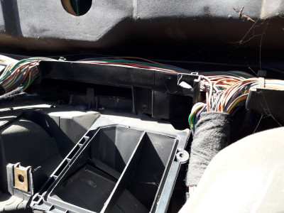

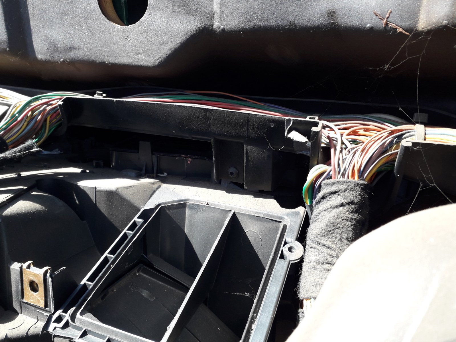

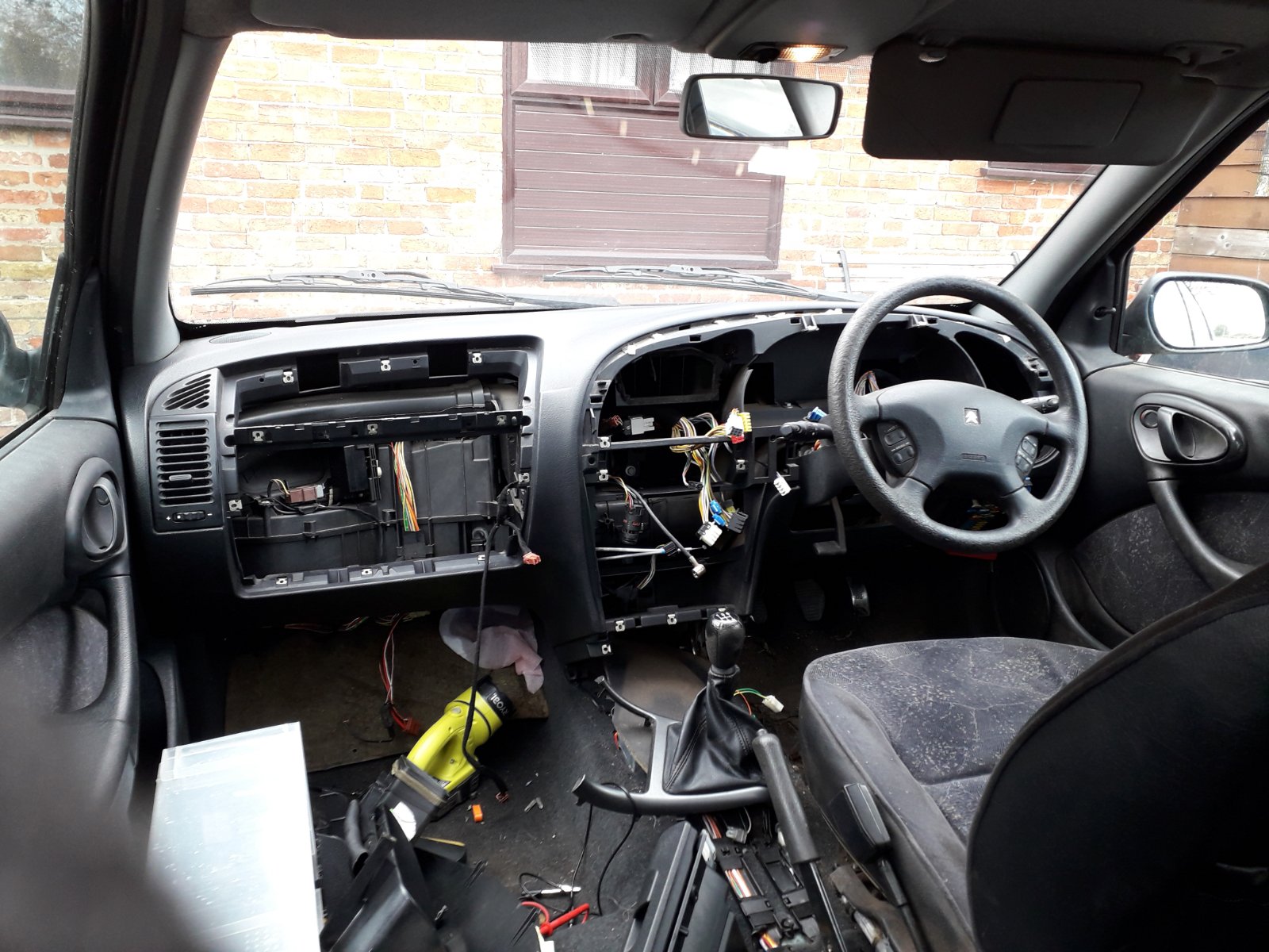

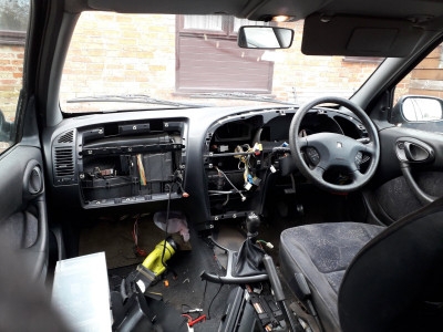

I have already posted in this forum regarding blower issues but whilst dismantling the dash this afternoon to investigate further I noticed a puddle of coolant in the passenger footwell and a drip from the heater unit which was accelerated by turning the engine over. my concern is the automatic aircon, can the heater matrix be removed without disturbing the aircon or am I fighting a losing battle with this car? I have disassembled most of the dash and removed the scuttle cover and wiper arms in preparation but am reluctant to progress any further if its a no go on the aircon front.

I don't know the layout on the Xsara, but on other Citroens of the era, the A/C evaporator was in a plastic casing that is separate form the main casing which holds the heater matrix and control flaps. On the Xantia (although again Haynes does not mention it) the 2 plastic cases can be separated by undoing a couple of screws, then the heater box can be lifted without touching the A/C.

Thankyou very much for your assistance, It would appear the evaporator is indeed separate, illustrations from http://www.catcar.info which itself I have only just discovered seem to support this. I will start to tackle this today and post an update as and when I make progress.

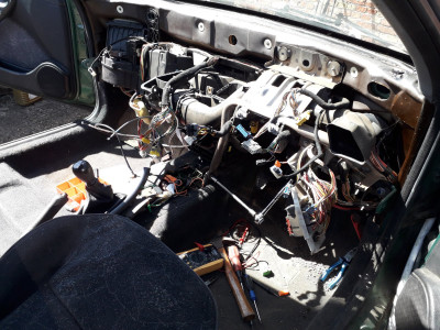

Well I've started, but Im not even halfway through. any ideas on how to remove the moderately inaccessible heater pipes? its a bit of a bugger to do so far to say the least.

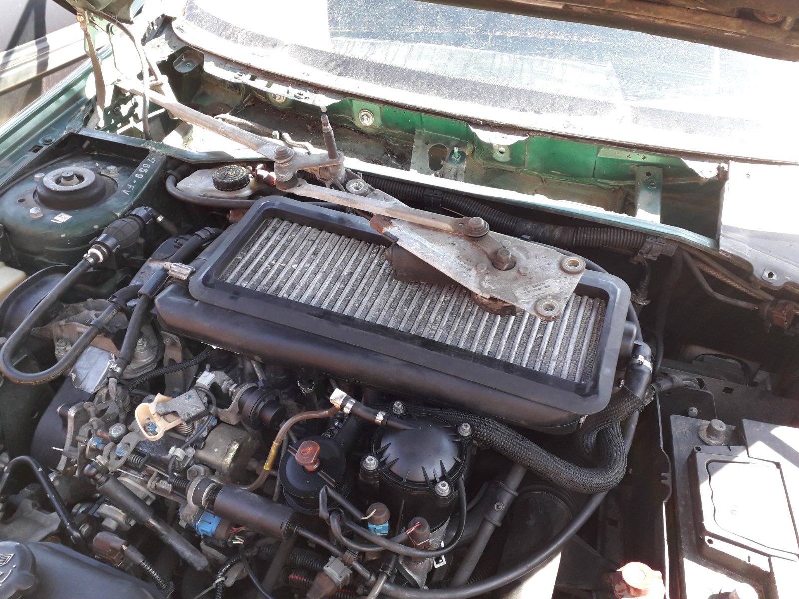

Well I finally got the offending object out of the car, Im not looking forward to reassembly. I had to remove the intercooler and associated pipes to get to the heater matrix union. There was very little room for manoeuvre and the pipes initially wouldn't budge.
I held a two foot pry bar between the bulkhead and union to the right and whilst holding the cambelt side of the union with my forefingers and the clip with my left thumb gently wiggled it side to side and it came out quite easily. Getting the heater into a position to extract the matrix was an absolute sod.
