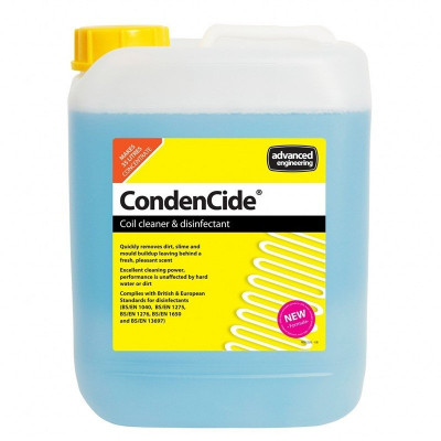

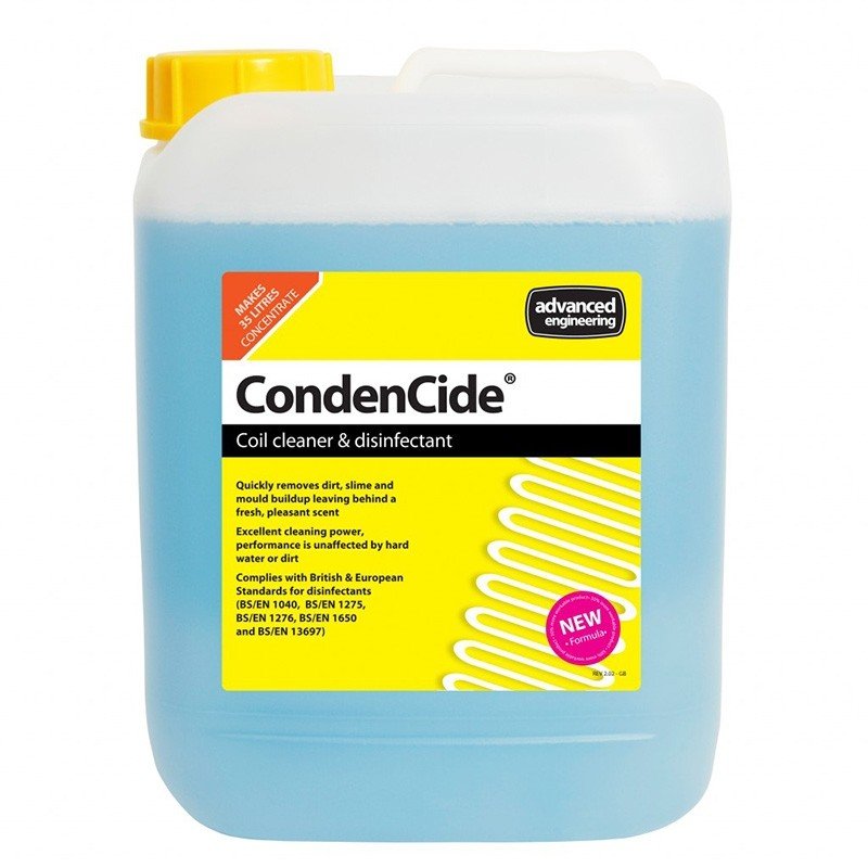

then there is something who called evapartor cleaning(seach in general ac stores- i have attached pic) , u mix it with water , i did it very concentrated , cos the evap was blocked completly, then u spray the mix into he evap , using a pressure bottle with flex hose, let it sit for 3 min(not more the 5 it will eat the coils,),
then wash it good! with water , i repet it like 3 times . that all
