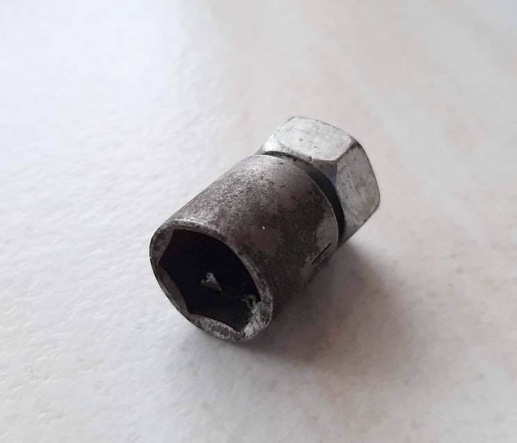

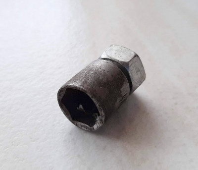

Here's my special tool for getting at the 10mm fan motor fixing nuts without needing to remove the rads and A/C condenser...
Having a 13mm hex on the end means a ratchet spanner can be used and that makes the job even easier...
Colin, it'll soon be on its way to you ;)

Well been a while but finally i have 2 working fans.
Thanks to Sir Jim and his special tool and the fans he sent.
However it was not as straight forward as i had hoped. Had a minor problem with one of the bolts which had managed to turn in the mounting as i was undoing the nut. Surprising as the amount of rust around the mounting was the only thing holding it together :(
Managed to undo the other 2 nuts and worked the motor out leaving the bolt and nut plus a little bit of rusted metal attached and with a piece of wood carefully placed i removed the offending nut and bolt. No such trouble with the other motor.
So a bit of contact cleaner and thread lubricant the 2 new motors were back in place and as they were sold as tested and working from Sir Jim i knew they would work so imagine my shock when they didn't, not even a hint of movement. :? :cry:
Then the penny dropped, they were not the ones Sir Jim sent me, similar box but from my stash of spares purchased in a job lot. #-o #-o
So removed them again and fitted the correctly supplied ones and bingo everything working as it should. :rofl2: :-D
So yes you were all correct it was the fans at fault all along =D> :oops:
