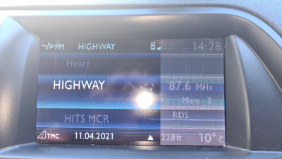

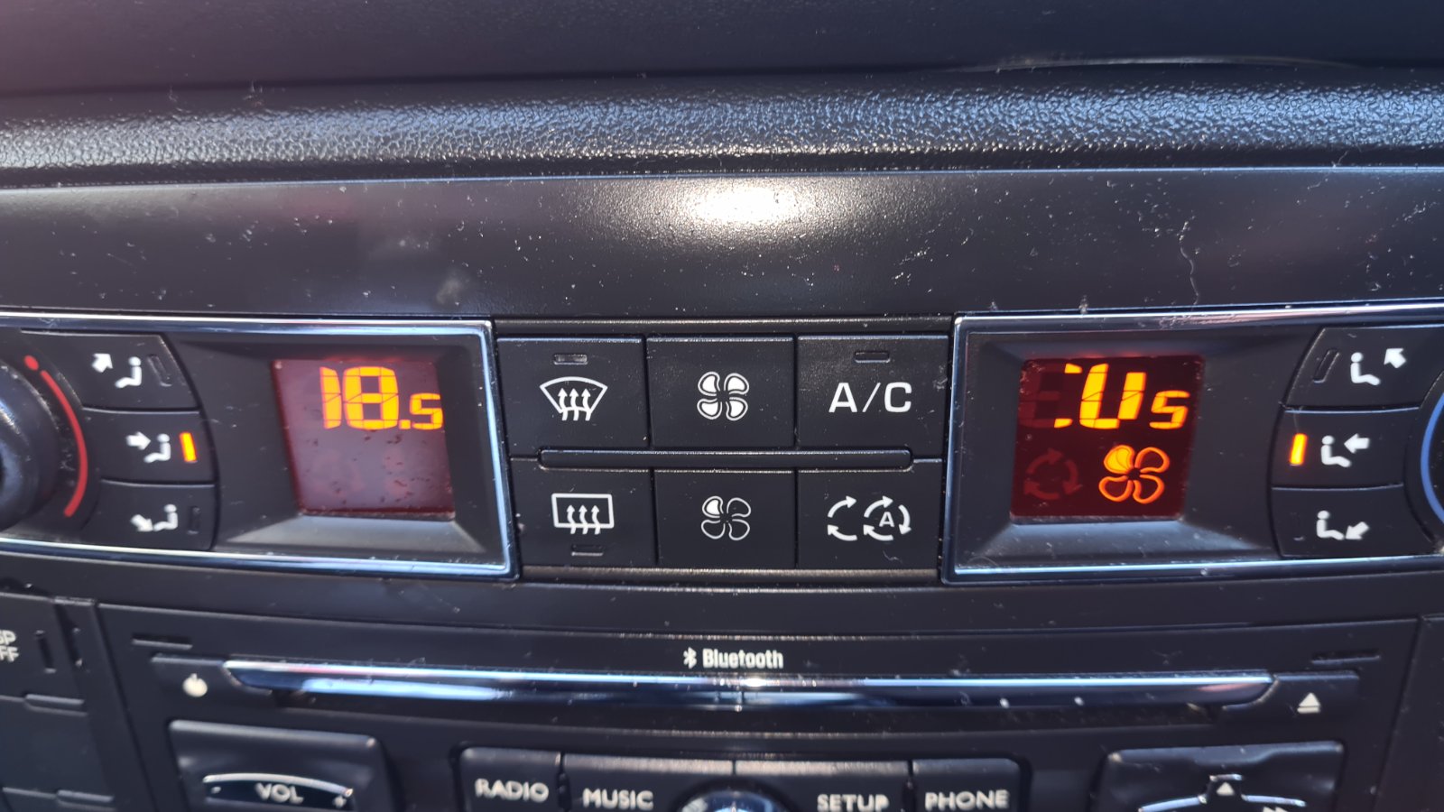

Afternoon all. I'm new here so hoping I am posting in the correct forum. 2 things really which I hope are simple. I need to know how to replace the bulb in the faulty temperature display as per attachment. Also a third of the panel of the sat nav seems faint, sometimes it's black but sometimes faded. Loose connection possibly?

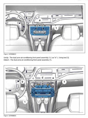

You can try wiggling the 3 connectors for the aircon control panel, but I think you might find the display is borked. The rotary knobs are normally what go on these - one or the other of them won't turn the temp up or down properly.
Here's the diagrams for removal of the unit so you can check the connectors.
Aircon control panel removal 1 - PSA, fair use
Aircon control panel removal 2 - PSA, fair use
