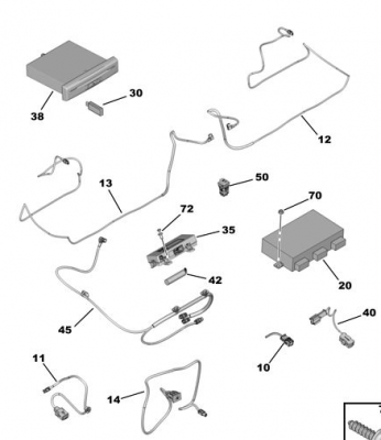

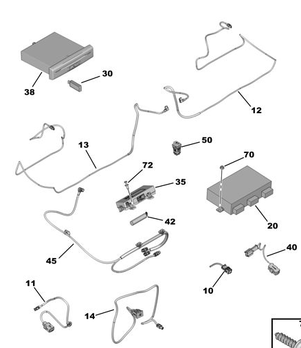

In fact it's the other way round, as I suspected, your C4 Picasso was never supplied with a CD Changer nor was there an option offered for it - only the single slot CD Player.
So if anything, the unit you have is from an older Picasso. Your SMEG unit may not be capable of interfacing with a CD Changer. Many CD changers were discontinued with the advent of later telematics systems and digital storage / streaming capabilities.
You may be able to send an eject command to the CD (as you would with a single slot CD that was available on your car), but other functionality may not be available.
As you can see, only the single CD system was available against your specific Picasso from your VIN - item 38.
