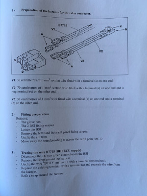

There is a official wiring modification you can do to the MK1 C5 that cuts the power to the BHI after a few minutes that stops the suspension nodding when parked.

Re: C5 BHI investigation query
From build date 13/10/03 the BHI unit had modified software that was meant to stop this however it was not always successful. The BHI can be updated with Lexia to the later version however again its not always successful in curing the issue. Citroen released a wiring modification to fit a relay that cuts the power to the BHI after a few minutes so that worst case it will only do it for a couple of minutes then stop so that it wont flatten the battery.
If you are interested in doing the mod i can look out the parts list & instructions. You will need to be confident in splicing into wires in the BSI & crimping relay terminals.

If you have Lexia check the software version, if its below version 000000730 the software update will not work anyway and this is the when BHI would need replaced to even attempt the update. This workaround was released to remove the need to replace the BHI.
It was easier just to take pictures.
In the wiring diagram at the end the relay with the dotted line around it is the one you are adding.

wheeler
- Posts: 7894
- Joined: 21 Sep 2002, 19:07
- x 1044
The CAN lines can be seen at the bottom of the diagram, they are the 2 thicker pairs of wires shown on each side of the BHI in the diagram.
