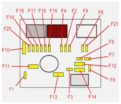

Check fuses F7 and F9 (both 10A) in the Engine Fusebox as these relate to the Twin Brake Switch before doing anything else though.

Here's the location of the fuses:

Many thanks.
Twin brake switch. That is the brake switch I replaced? It has two fuses?
- x 6963
Re: Peugeot 407 Hdi 2.0 2009 Brake Lights not working ABS/ESR er
The wiring diagram for your vehicle has several possibilities - it lists both these fuses as having that function, but it may mean one or the other. There are 3 levels of BSI and these also differ depending on the Injection variant fitted too. So that is why it may be one or the other and why I included both for you to check.
It won't hurt to check both though of course. But don't rely on a visual check - test them with a multimeter as I'm sure you know
