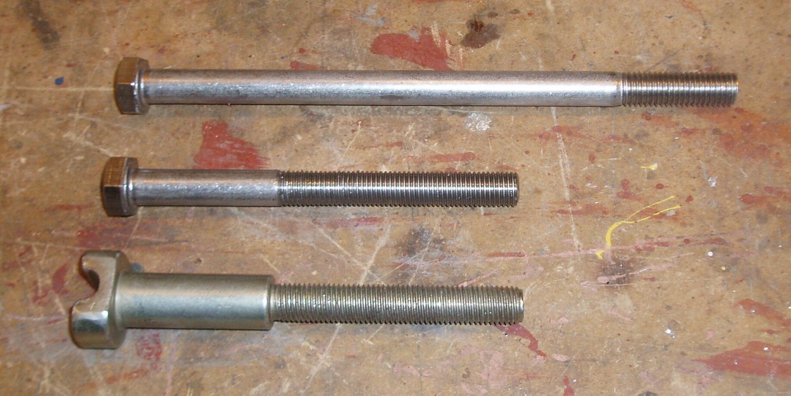

I really don't like the bolts Citroen decided to use for the Xantia spare wheel carrier. What possessed them to use a slot rather than a 19mm hex ?
I had to change an offside wheel on the hard shoulder of a motorway once, back in the good old days, when motorways had a hard shoulder, rather than the death-trap 4 lane arrangement we have today. Anyway, it wasn't much fun, even without having to deal with a corroded bolt that didn't want to let the spare wheel down.
After that experience, I got rid of the stupid standard bolt and replaced it with one made from stainless steel.
This is slightly less straightforward than one might think, because the thread on the hook is M12 1.5mm pitch, rather than the standard 1.75.
The solution was to buy a pack of very long bolts on eBay, plus an M12 x 1.5 die, cut the ends off and retap them with the required thread.
The head is 19mm across flats, so it fits the normal wheelbrace; the solution Citroen should have adopted.
Picture shows standard bolt, as bought, then a modified one and the original Citroen equivalent below.

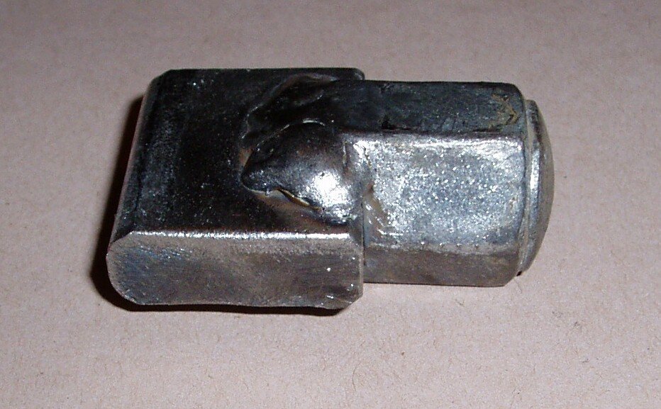

If anyone's struggling, I made this wee adapter to unscrew a bolt that was really stuck; yours for the price of the postage for the first requester....
