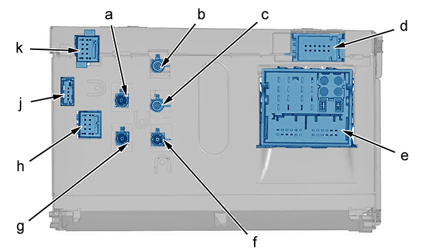

Here is a picture of the NG4 backside. Would you be able to identify where the unit should normally be connected to the CD changer ? I guess that it has to be activated using a diagbox as well ? :roll:
Cheers ! :mrgreen:
Franck.
x 6955
Re: CD Changer fonction on the WIPCOM3D / NG4 - Peugeot RCZ
The NG4 has telephone Bluetooth as you probably know, but will not support streaming music from any device. If you are planning on using a Yatour or similar to mimic the CD changer - bear in mind that will still be limited as it is only mimicking the CD changer, so you will have limitations to what you can do.
It's ok, I don't need the images of the rear, I have these already.
The connection you need is shown at 'E' below.
Within Connector 'E', there is a separate block 'C'. This contains the connections for the CD Changer. Below are the pin assignments.
The other connections are:
"a" Aerial FM2.
"b" Aerial TV2 (for Japan only).
"c" Aerial TV1 (for Japan only).
"d" MQS cable connector.
"e" 3-part connector.
"f" GPS aerial .
"g" Aerial FM1/AM.
"h" LVDS 2 cable connector.
"j" USB socket connector.
"k" LVDS 1 cable connector.
Yes the music you use will be in 6 folders just like a CD changer - each containing your music files.
Personally - I never streamed music - much preferring to copy over albums onto the SD card and play it perfectly using all the controls of the steering wheel. Best of luck with the project. :)

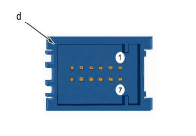

Dear Mark,
Do you have a detailed plan for connector D? I guess that there some of them AUDIO L R and VIDEO
x 6955
Here you go:
Micro Quadlock System Conenctor 'd'
Channel numberAllocation of channels of connector
1Audio signal + (Service module)
2Audio signal - (Service module)
3CAN High
4Channel not allocated
5Channel not allocated
6Channel not allocated
7Channel not allocated
8Channel not allocated
9VAN Low
10Channel not allocated
11Channel not allocated
12Channel not allocated

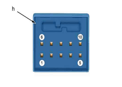

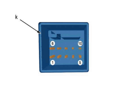

Here you go. :wink:
"h" LVDS 2 cable connector (10-way)
1Clock LVDS CLK1 +
2Clock LVDS CLK1 -
3Channel not allocated
4Channel LVDS A0 +
5Channel LVDS A0 -
6Channel LVDS A2 +
7Channel LVDS A2 -
9Channel LVDS A1 +
10Channel LVDS A1 -
"k" LVDS 1 cable connector (10-way)
1Clock LVDS CLK1 +
2Clock LVDS CLK1 -
4Channel LVDS A0 +
5Channel LVDS A0 -
6Channel LVDS A2 +
7Channel LVDS A2 -
9Channel LVDS A1 +
10Channel LVDS A1 -
