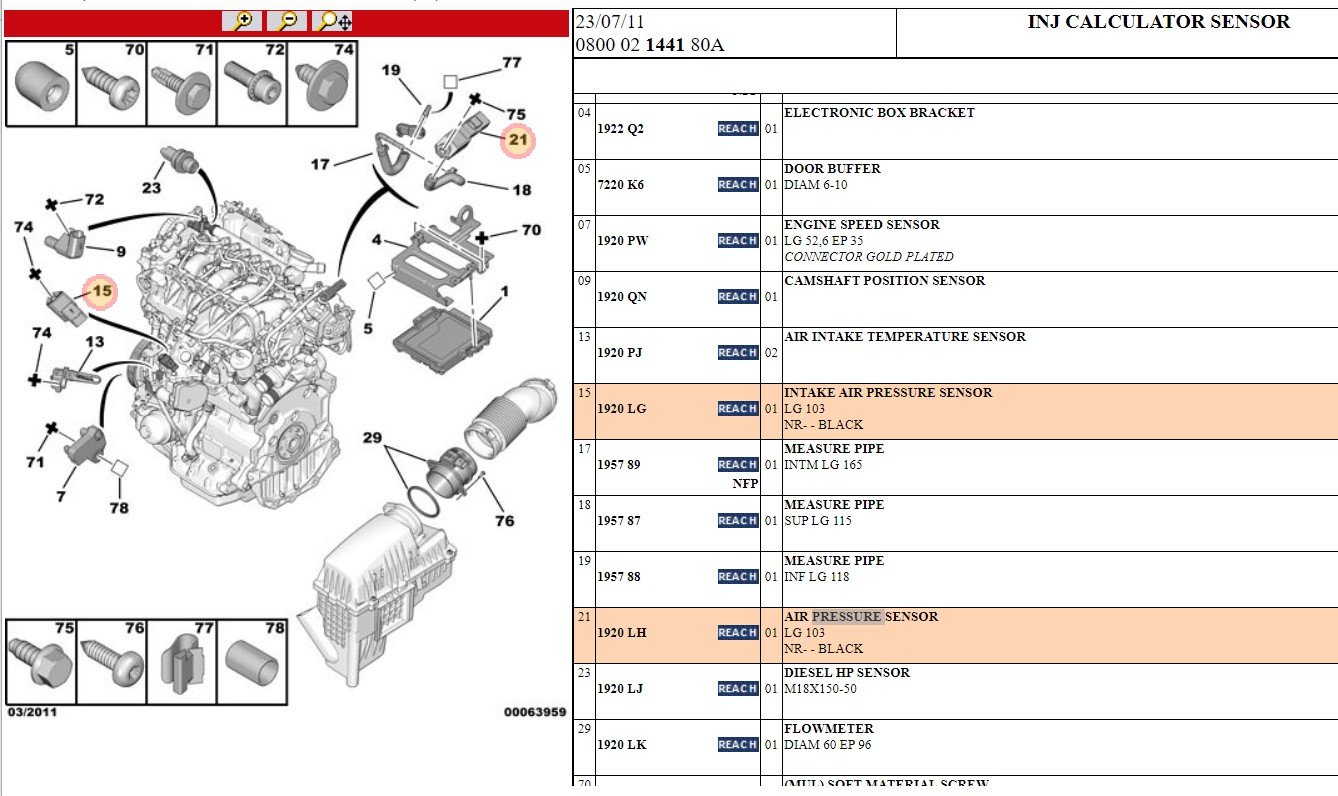

I've put this circuit diagram up as a vector graphic to help in your deliberations - so should maintain resolution when scaled.
So you have the DW12BTED4 Twin Turbo - here's the Injection Diagram for you and the location of certain components:
You can look up the codes of the hardware on our wiki that has most of them in sections in Ascending order:
Electrical Component Codes - Wiki
Injection
Location
Injection
Location

There are 2 different pressure sensors listed. You could disconnect each one in turn with the ignition on & see if the fault code comes up with sensor 1 or sensor 2 to confirm which is which.

Hello again finally received a new sensor fig 21 on the previous diagram and deleted the code.
All is fine for about 1 minute then the EML comes on again and the same code.
I don't appear to have any vaccum at the pipe on the rear of the sensor I have replaced, does anyone have a diagram of where this vaccum pipe goes to as I cannot trace its route.
I have tried to swap the sensor from the first turbo, fig 15 but the sensor is not the same.

Hello, found the fault, it was a broken vaccum pipe at the back of the engine, all fixed now.
