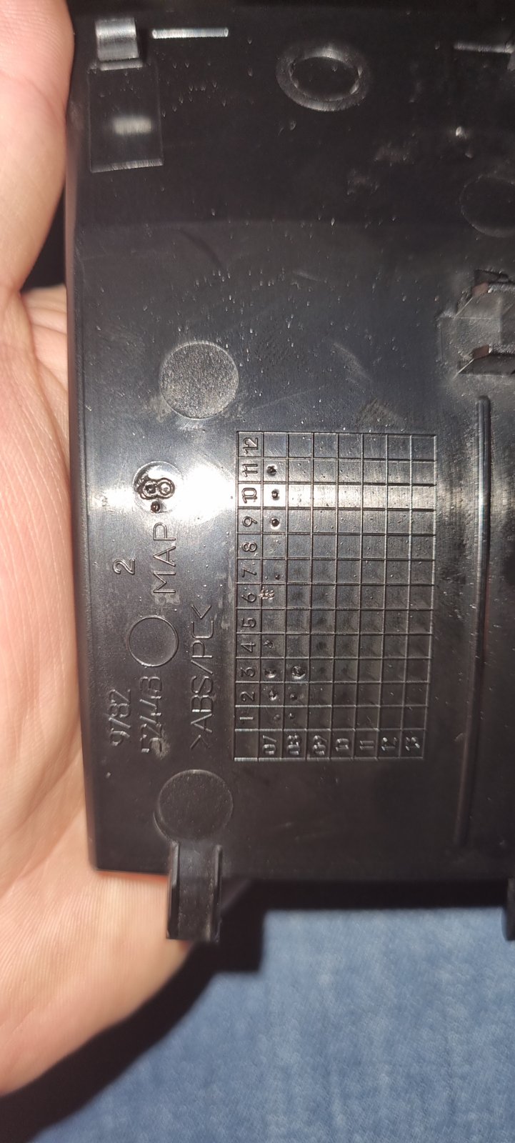

Re: C5 X7 - Removing Dash After Airbag Triggering
Hi again I have already replaced the arbags and the dashboard and I’ve already assembled everything. I’m now in the final part but I have 2 doubts. is the second is does anyone know where this piece of plastic is? Thank you for your helpGiveMeABreak wrote: ↑29 Mar 2021, 23:09 There are 2 satellite lateral acceleration sensors for the side airbags. If the side (curtain) or Chest (from the seat sides) airbags didn't deploy then the lateral sensors that are behind the B pillar at the bottom, behind the seat belts trims don't need replacing.
