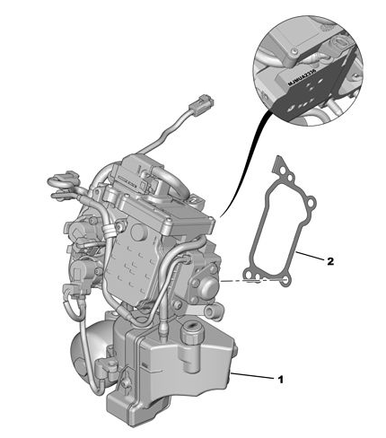

Limp home is not relevant here. Reduced engine power is generally instigated by the engine ECU for engine or emissions faults only - not the gear box or clutch on a piloted manual. You wouldn't expect to have a 'limp home' mode with a manual gearbox or clutch if it or the dual mass flywheel started slipping - same thing.
It would be the first time I've heard of the accumulator sphere being at fault on these piloted boxes - but not impossible of course.
As for the faults - a sphere has no electronic parts - it is purely mechanical so cannot report a fault. However if the pressure is low, it may have some sensor in the system that could detect this and report back to the piloted gearbox ECU. This is why they are a pain in the butt. Troubleshooting these can take a loft of time, but hopefully the dealer may be able to help you.
You can see the oil level on the system if you look - but this can only be physically measured and checked (and topped up if necessary) when the system is depressurised - which you need to do with Lexia / Diagbox. Essentially that would also show you if the system was pressurising or not and that would rule the accumulator out.
Try hooking it up and going into the piloted box ECU and seeing what the live data shows - that might give you some clues.
Oil reservoir at (1)

Thanks for that. I figure the sphere would have to have a pressure sensor somewhere. Perhaps not. On the Range Rover, the sphere's wear out and the first you know about it is the ABS system motor runs for ages after a single or couple of pedal presses when normally it tales many presses.
I want to do the oil, but not wholly convinced I can get Lexia or Diag to do the right thing. If you have any tips I'm all ears....

As far as I’m aware the system needs to be de-pressurised and depressurised using the diagnostic system. It is essential to ensure the oil level is correct, so is only checked when depressurised.
