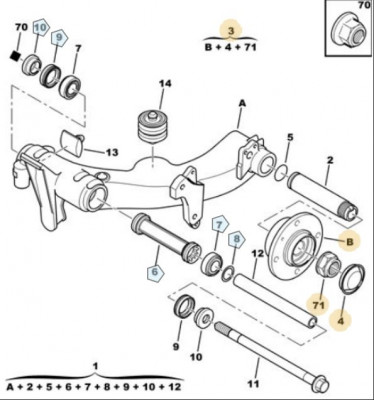

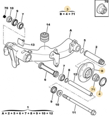

Re: C5 trailing arm bearing kit
These are the parts from Citroen for the rear bearing Kit:Gazzaman22 wrote: ↑28 Dec 2020, 20:14I've a 2007 C5 1.6
It's just after failing its MOT here in ireland.
Is there any kits I can order with all the bits in?
Item (3) on the diagram which includes items B, 4 & 71.
Citroen do an original OEM part: 374870 for £183.23
or they do a cheaper kit, part: 1623943380 priced at £74.84
All prices are in sterling and inclusive of UK VAT as of today, direct from Citroen.

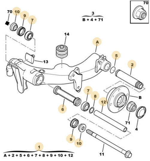

Malcolm, check these are the right parts before you buy as the diagram/reply by Marc shows a 'Wheel bearing' (3) kit, whereas original post was for "rear arm bearing kits" which according to the diagram should be parts 7 , 8, 9 & 10 (Possibly 6 spacer tube?) at least.
Item (1) in the diagram at the bottom is for the complete rear suspension ARM which includes ALL the components highlighted:
I only mentioned the rear hub bearing which includes everything in item (3) in my original diagram as the complete kits are no longer available from Citroen given that some parts are now unavailable.
The complete kit part numbers (1) when available were:
(Left) 5175AP £458.82
(Right) 5175AQ £458.82
Any items not in Item (3) you may need, list them up here and I can tell you if they are available form Citroen.
