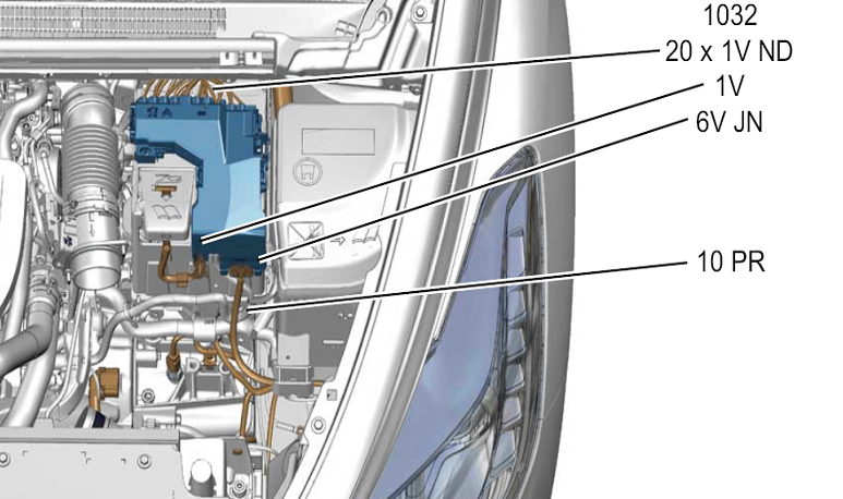

Ds5 dsport heated front seats not working.

First, check Fuse F9 in the passenger compartment - this controls the heated seats. Ideally you would need to check if you are getting any live feed on this fuse whilst the engine is running as the heated seats only work when it is.
If there is a live feed at this fuse, then it's likely that the heated pads may have failed, which they do over time. they are not really replaceable either as they are bonded onto the leather, so not practical to do realistically.

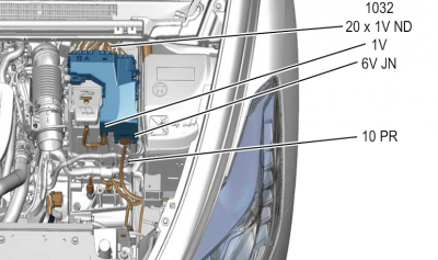

If there is no Feed at this fuse, then the supply to this fuse box is handled by the supplies fuse box in the engine bay marked 1032 as shown below - and the fuse you are looking for is F11. However, if it was this fuse, then you would find some of the other equipment wouldn't be working as F11 supplies the cabin fusebox.
