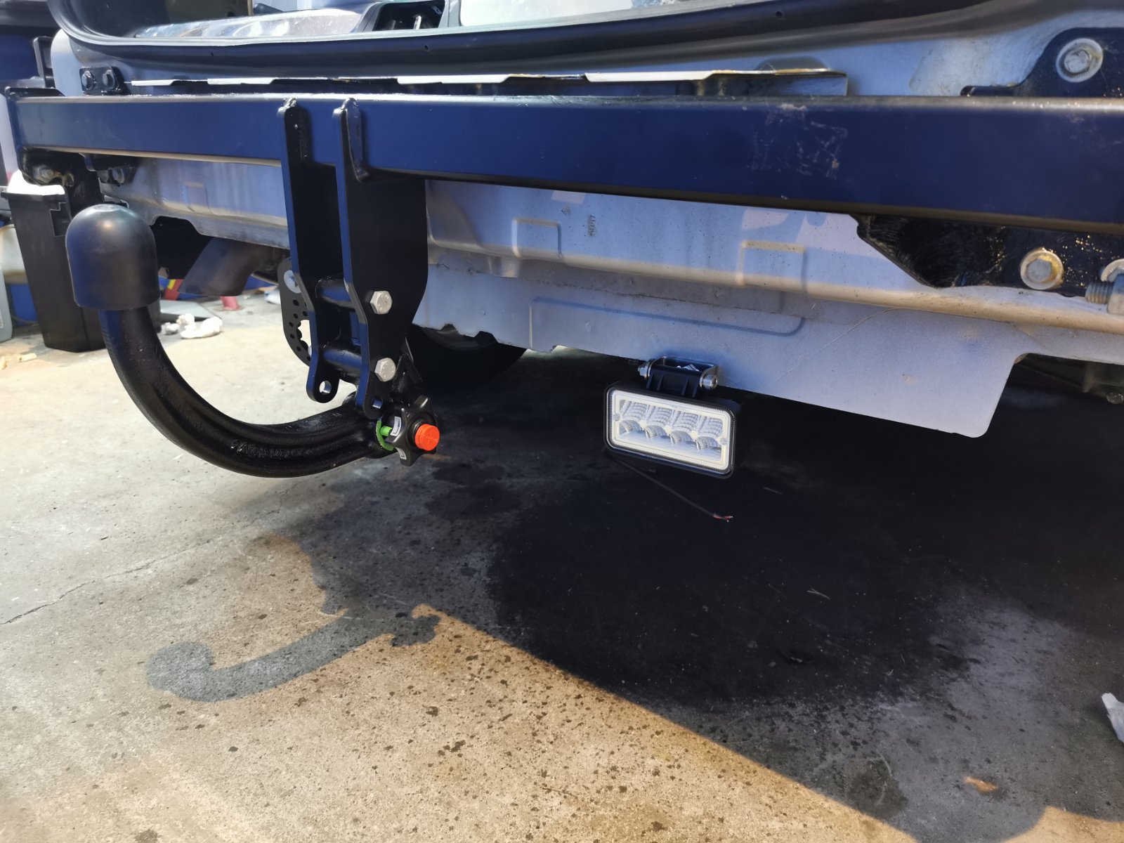

Working at mounting tow bar and when at it, a xtra reversing light. Original reversing lights are a joke, in combination with a camera that is useless in the dark, I really need some more lights. As its only legal to have a max of two reversing lights, I will remove the bulb or dismantle the reversing light at one of the sides, via Diagbox.
But. How to connect a simple LED light? It's a plain LED lamp of decent quality, consumption is said to be 12W, I guess 15W IRL.
I was first thinking of just hook into the wires for the trailer connection, but thinkering about it this might not be an good idea, as the reversing module for the tow bar will be programmed into BSI, and I belive must have some auto-sense-thing to know when a trailer is attached, as the module handles both LED and filament at the trailer, and it does not have any microswitches to turn off rear foglight or whatever. So... Can I try the nasty way just to remove the bulb in one of rear lamps, and connect this LED lamp? Or will a 12-15W consumption be sensed as a faulty filament, or will BSO dont understand the LED and assume there is a fault anyway?
So my option is to do it the proper way with relay with signal from any of the rear lamps, and if so what is a good scource for 12V power? The model is 2014 CrossTourer, 2litre auto.

Well, Im not into other bulbs, as the lens layout is just to weak. Im into a separate light, close to the tow hook, as on picture. I will try to see what happens when I connect it to the reverse wire for the tow bar. If not try a simple relay with signal from the tow bar electrics or one of the reverse bulbs...GiveMeABreak wrote: 11 Mar 2021, 10:10 The reversing light circuit is sensitive to LEDs and will record errors in the BSI and cause erratic behaviour. I replaced my reversing bulbs with brighter LEDs on my X7 for the same reason, but got notified by drivers on occasion that they were flashing! Also, when looking at the BSI fault logs it was flooded with warnings about the reversing light faults (shorts).
