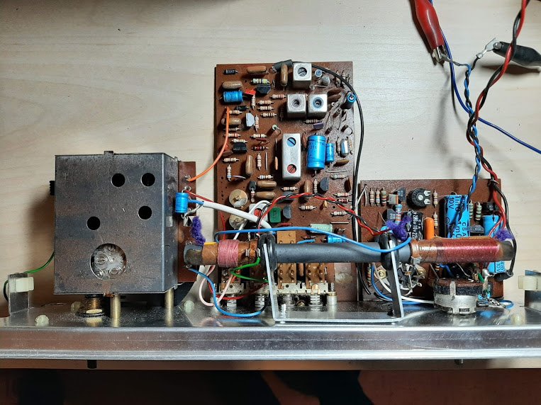

They were always good sets Peter. I would think they must have sold well, both the VHF80 and it's wooden cased sister, the VHF81... I have three VHF81s in my collectionPeter.N. wrote: 12 Mar 2021, 10:06 I recognise that Jim, we used to sell those when they were new - I was much newer too.

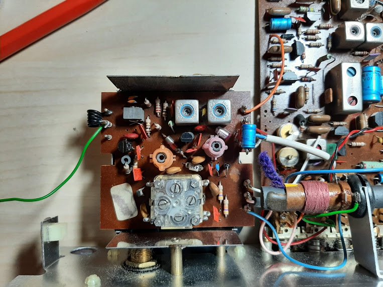

I've been fixing a product of a famous (and classy) old British radio maker today... A Hacker portable with a very noisy tuning capacitor leading to very unstable tuning...
It was necessary to open up the metal screening box around the tuner module to fix it...
And to do so I needed to unlace the tuning drive cord... Not a job I relish...
I took a load of photos so that I could re-lace it at the end
The repair was a complete success
