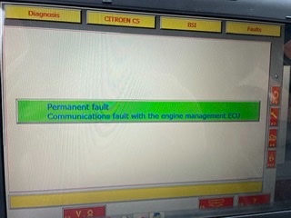

Just to add. Disconnecting the engine ecu and the bsm doesn't buss.. Its like a loud relay chatter really fast..

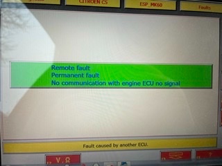

The buzzing is related to fuel pump priming. Removing F2 for fuel pump stops the buzzing..
But there's still no communication between bsi and engine ecu..

Strange one. What is the history of the fault? did it cut out when driving or just not start one day? what was the recent work done on the car?
Is there 12v a fuse 2 when the buzzing is happening?
If there is no communication with the engine ECU then the first thing you need to do is check the power supplies & earths at the ECU. A good starting point for that would be to check all the fuses (remember the maxi fuses under the BSM).
