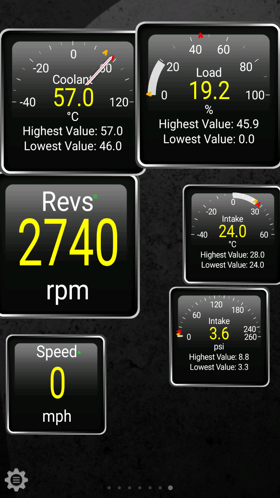

Car is not overheating (checked through Torque Pro)
