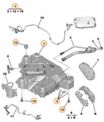

Please can I have the part number of the complete adblue tank of this van, VIN VF3**************[VIN obfuscated, can be read by forum staff].
Thanks!
x 6962
Re: EMISSIONS FAULT & ENGINE FAULT: HAVE THE VEHICLE REPAIRED
Hi
The complete UREA tank is part number: 9822257280 for your vehicle and currently retails at Peugeot for £1064.09 inc. VAT.
If there is an issue, now is the time to get it done under warranty though.
It contains everything circled below:
