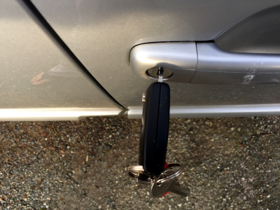

Marc, can you tell me if this photo of me putting the key in the drivers side lock looks about right? I’m sure the key never went al the way into the lock (unlike the ignition).
Regards
Carl

Re: C3 locked and remote not working?
Post by GiveMeABreak »
We have a Mk II C3, but I will go and check for you now....

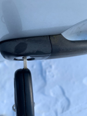

Here you go - ours does not go fully in either:
You'll have to excuse the bird crap on the door handle :roll:

Post by Carl170 »
Marc, thanks very much for that. Looks like I’m going to have to get the rear windows down and access the bonnet that way. Don’t know what to do if connecting the battery doesn’t reset it either.
It’s the key that annoys me most. 1st time in years that it hasn’t worked!
I will let you know how I get on!
