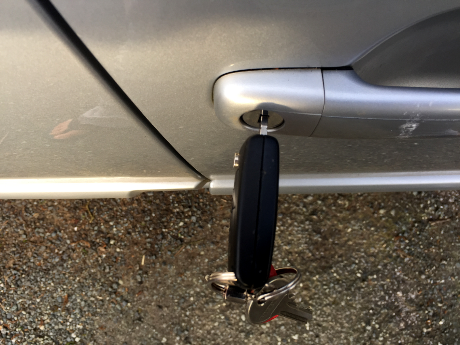

Marc, can you tell me if this photo of me putting the key in the drivers side lock looks about right? I’m sure the key never went al the way into the lock (unlike the ignition).

- Posts: 37459
- x 5743
Re: C3 locked and remote not working?
We have a Mk II C3, but I will go and check for you now....
- Posts: 37459
- x 5743
Here you go - ours does not go fully in either:

- Posts: 10
- Joined: 08 Feb 2021, 13:01
Marc, thanks very much for that. Looks like I’m going to have to get the rear windows down and access the bonnet that way. Don’t know what to do if connecting the battery doesn’t reset it either.
