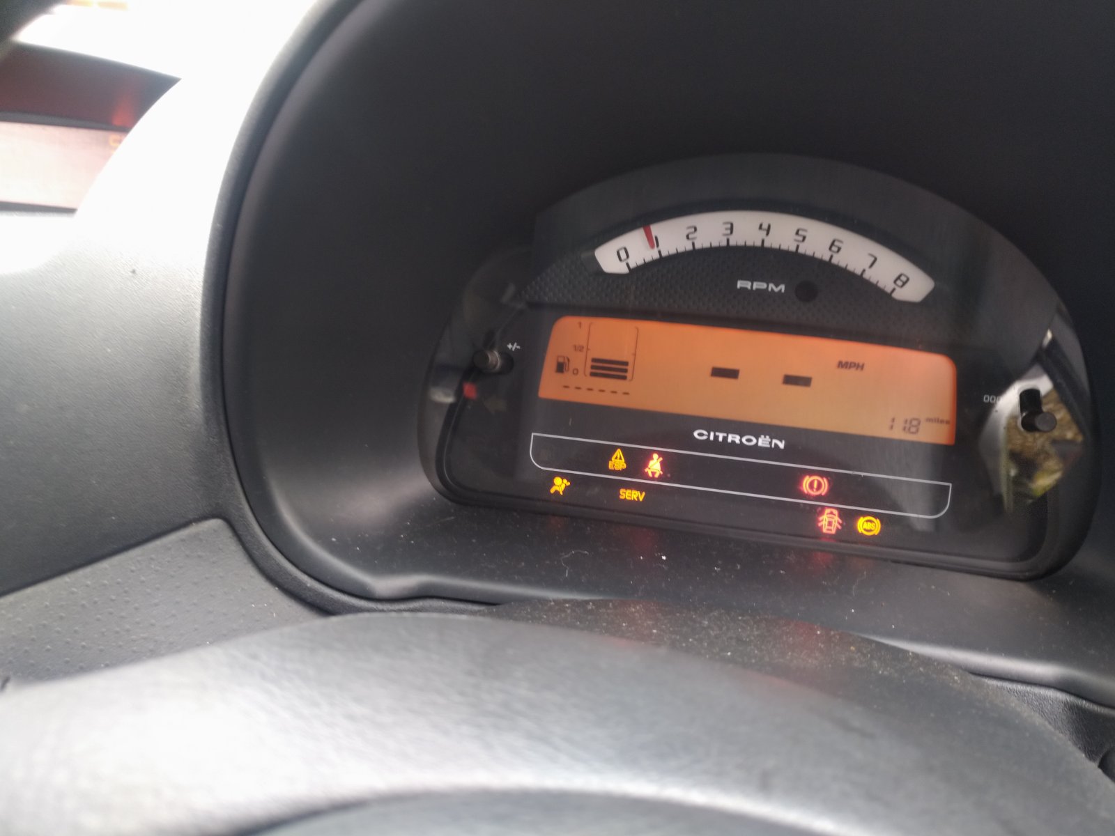

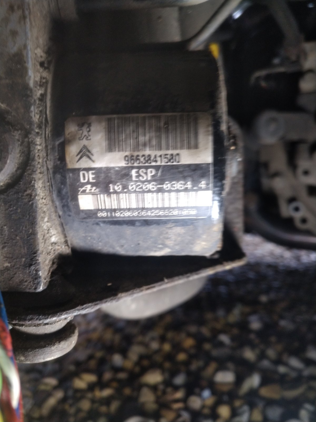

Helping a friend with problem on his car,...his ABS light and ESP light keeps randomly popping up.

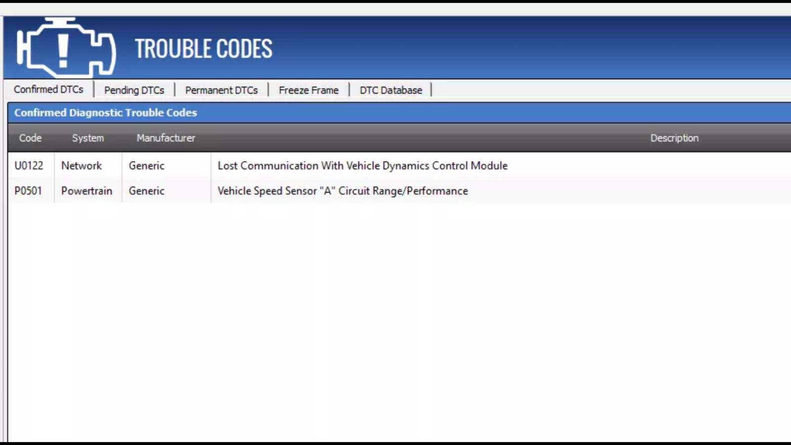

Have checked OBD:
Getting U0122 and P0501
Shown in attachments
Have checked all fuses and all ok.

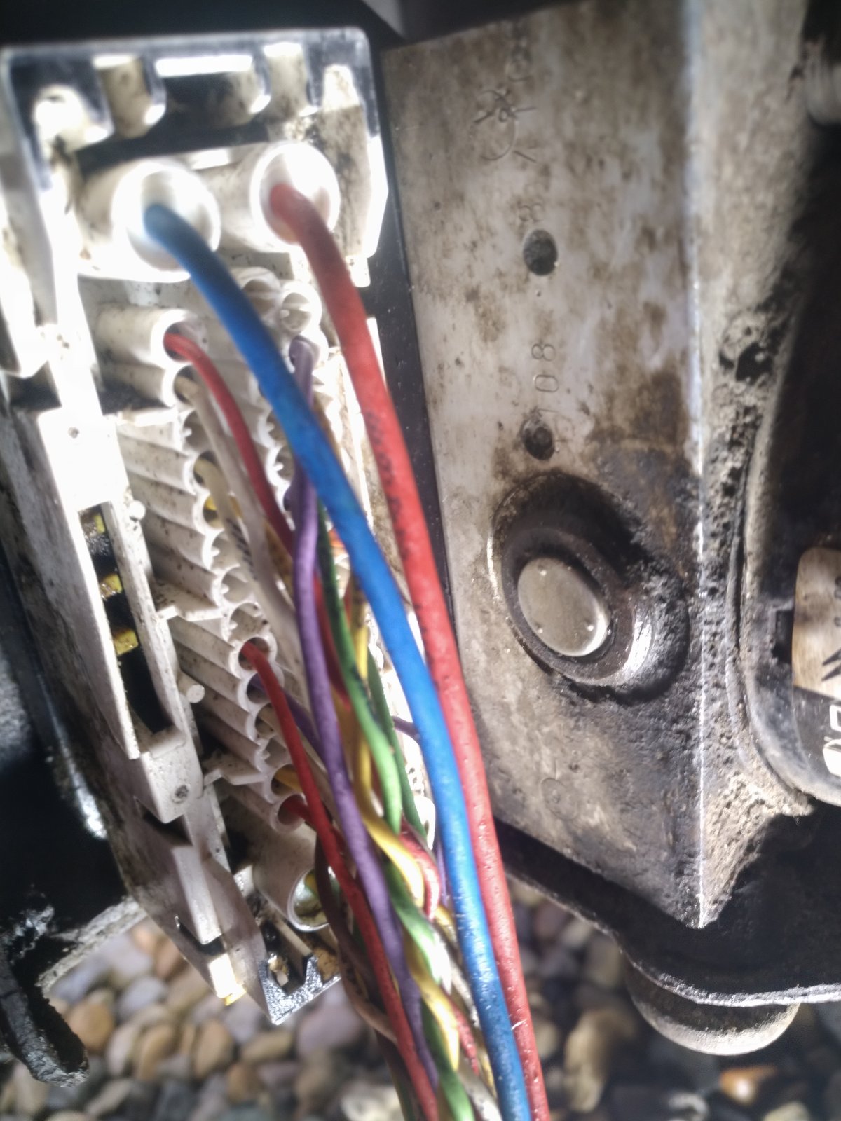

There has been a mud guard missing on N/S (passenger side, RHD) since he got it and that's where the ABS module is located, I managed to get the black cover off top of cables and it's quite wet and muddy but can figure out how to get harness out.
Did not have a jack to hand so couldn't remove wheel for a better look, but I'm planning on checking the connections on the harness and looking for ideas, instructions on how to get to the ABS module harness

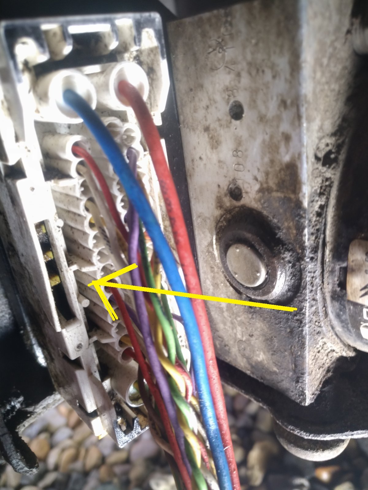

Edit: The yellow clip that connects to where arrow is in picture was broken off by a mechanic who recently fitted new steering rack
Have checked OBD:

That was nice of him. Neat trick seeing the ABS hydraulic block is nowhere near the the steering rack.amallaburn wrote: 04 Feb 2021, 16:23
Have you managed to get the connector off yet?
Have you tried to get a screw driver (or pointed object) onto the yellow retainer and push it side ways (down, in the thumbnail). Both sides. Tried grabbing the yellow tabs at the end of the connector and pulling them outwards?

Will probably get it with a jack, didn't have one to hand but saw on a Youtube video that the connector comes off (
Could you explain via an image, that would be great
Just need a diagram for the pinout of this connector as struggling to find online

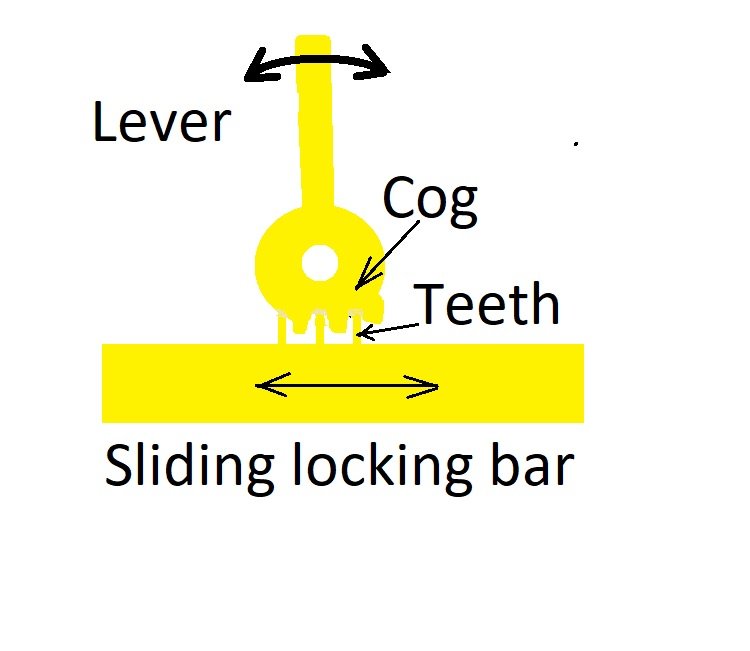

This video is no good to you (as far as the connector is concerned) because he has already undone the electrical connector.
If you go to the 7:00 minute mark you will see the two yellow tags (that I talked about) and you will note that they are "sticking out". Have a look at yours, they will be recessed into the body of the connector.
You will need to get a screw driver or long nose pliers onto them and pull them outwards, bit by bit, one then the other, as you pull the connector away from the receptacle.
The Lever (that is missing) has a cog-like shape that engages into those teeth on the top of those yellow locking tabs. Causing them to slide backwards and forwards in the connector as you move the lever.

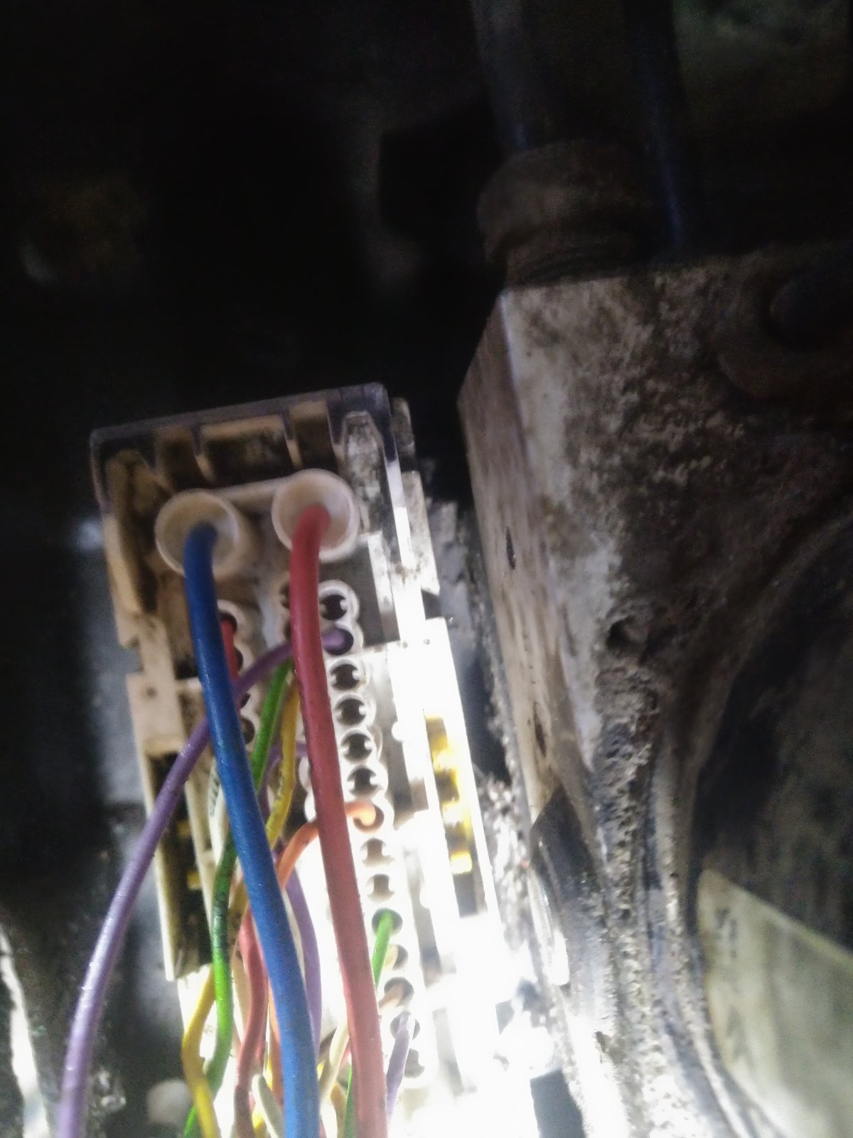

Ok, so that connector looks pretty exposed to the elements, so would not be surprised if water has gotten in.

Since the two DTC codes I read were U0122 and P0501 would that be a CAN BUS fault?

When turning steering while stationary the faults come up dash

Ignore if not related as I'd like to keep this thread to the original problem for the benefit of others reading
Throttle is sticking sometimes

Re: C2 ABS ESC SPEEDO problem (U0122, P0501)
Is the peddle sticking? Does the engine light come on?
If the engine light doesn't come on, then the engine thinks the peddle position and the throttle butterfly are are in alignment. Again you didn't mention any engine errors so I cant explain that one. Could it be a different type of fault? Can you describe the symptoms? If the throttle butterfly and accelerator peddle are not in alignment the engine ECU WILL throw a wobbly!
Sounds like classic battery/charging circuit problems.
I've got a blurb over on the Citroen C3 owners with a step-by-step on checking the charge circuit. It's very difficult to test a battery but easy to test the charging circuit. If it's not the charging circuit then it's probably the battery.
https://citroenc3owners.com/tips-for-an ... t4313.html
Apparently when the faults come up the throttle sticksozvtr wrote: 10 Feb 2021, 22:03 Is the peddle sticking? Does the engine light come on?
Been told all the lights come up, engine and handbrake includedozvtr wrote: 10 Feb 2021, 22:03 Sounds like classic battery/charging circuit problems.
I will go and check charging circuit today and report back, I found your guide the link didn't work for me for some reason
When the fault lights come up on the dash the throttle 'sticks'? Does it fail to respond (freezes) or returns to idle?
