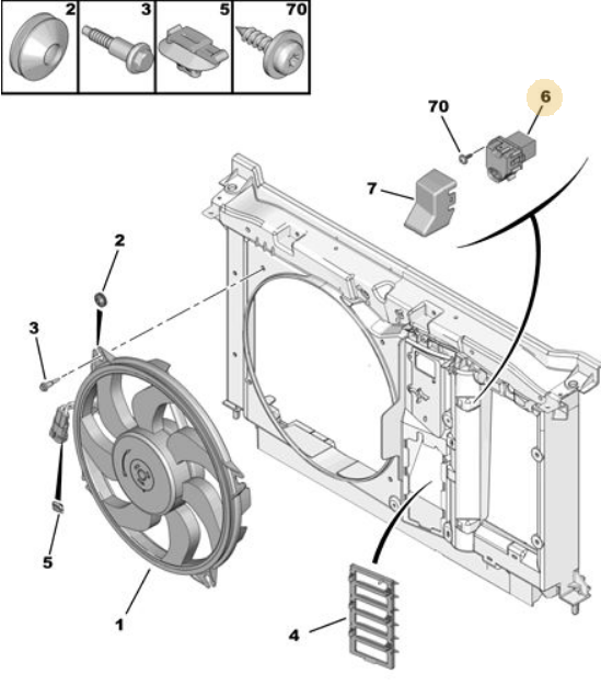

The system is controlled by an electronic control unit item (6) inside the fan housing under a cover. That is supplied by a 60A Fuse (F12) in the main supplies protection unit.
It is a single fan 2 speed system all controlled by the engine ECU. The relay is internal to the engine fuse box and not really user serviceable.

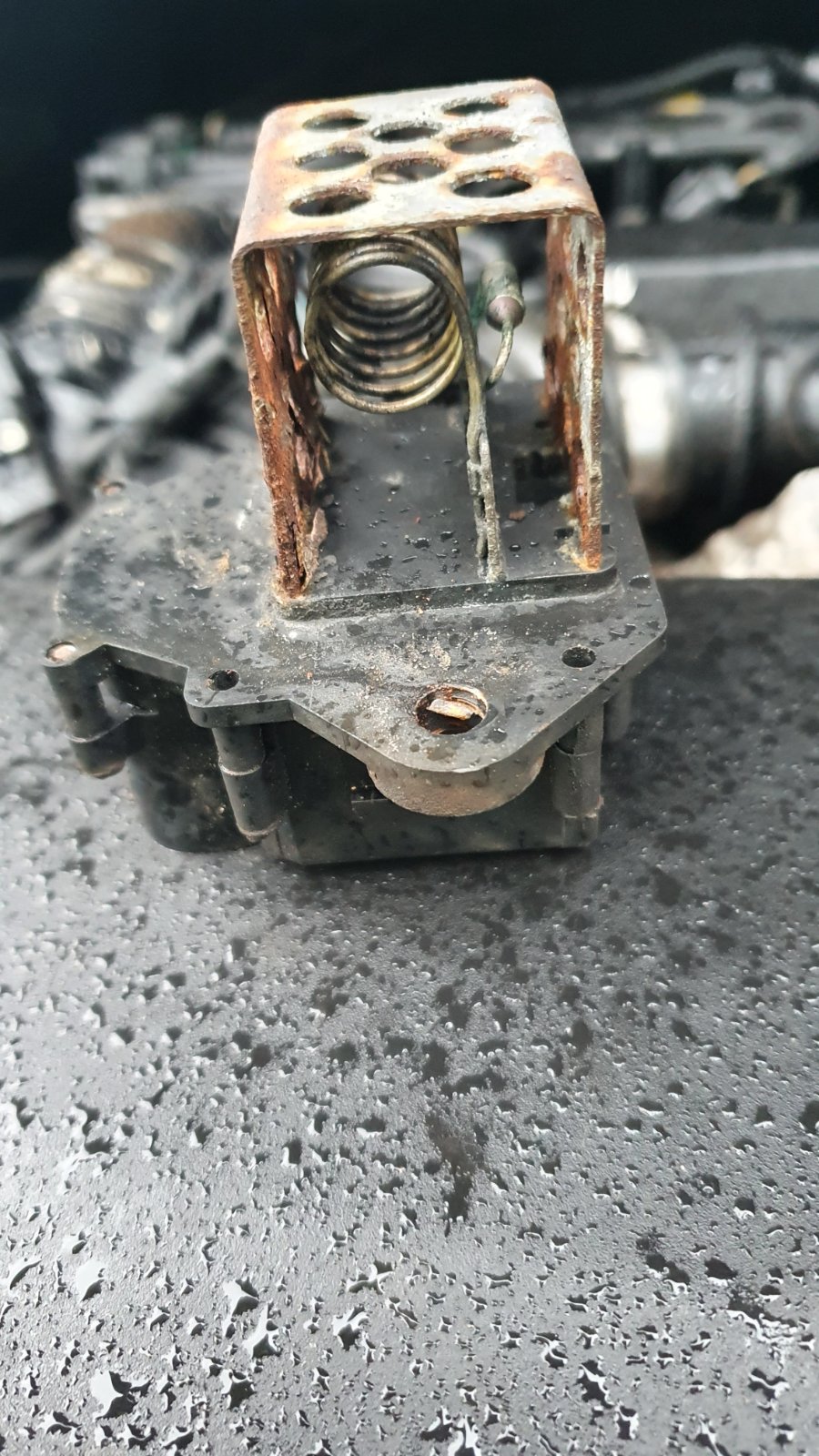

From that circuit, the engine ECU #1320 can send two outputs to #1522 Control Unit, for Lo and Hi speed fan operation.
1522 essentially contains two relays, one for each speed, and one dropper resistor for Lo speed.
Shouldn't be difficult to chase the missing fault through.
Fault might just be that 1522 needs replacing.
Loss of just high speed suggests that the HS relay (or its contacts) have given up/become arc-damaged.
These contacts will have hard time, given that the fan is fused at 60A!

Re: Cooling Fan Problem
Apart from the relays and the main dropper resistor, there are also two smaller components inside the 1522 control unit - a variable resistor, and what is shown as a fuse.
I'm unsure about the exact functions of these two.
Apart from checking the signals arriving from engine ECU, it might be worth replacing 1522 (price?) to eliminate it.
Engine ECUs rarely give problems, but fan-switching relays, and high-current dropper resistors, do.

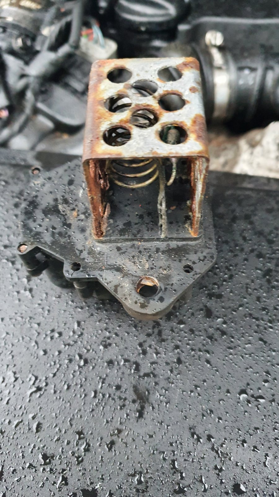

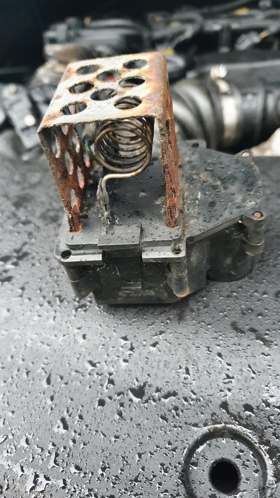

I think this could be it, I thought that was just a resistor for the low speed but it has the right amount of connectors, the high speed must pass through this but bypass the resistor. For the price it's worth loading it into the parts cannon

I'm not sure if this is the culprit but it looks like it's been in the elements for a very long time and it's a genuine part so the chances are it could be original. I'll replace it anyway and see if it solves the problem. I think there is an internal relay for the two speeds so worth a try

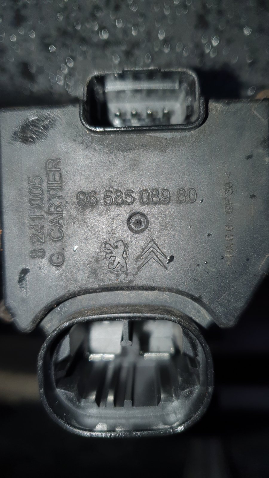

I have the part number from the part itself (provided it's the correct part fitted!)

Already have the VIN.
The control unit has been superseded with a new part (9830143880) for the unit and (1308CX) for the cover. Citroen specify both parts required, so I suspect the replacement unit is different and won't fit the previous unit's cover.
Items are priced at £81.63 and £4.62 for the cover inc. VAT direct from Citroen.
- white exec
The earlier part was 1308.CW (replaced by 98301....), just in case you go looking for a secondhand replacement.
