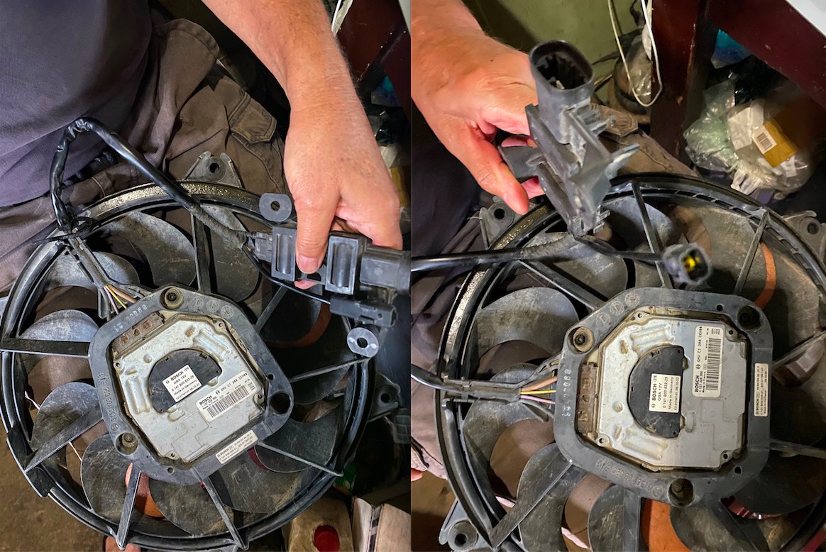

I have the fan out; it has four wires; two large and two small. I have put power on the two large wires; it draws a hefty current but the fan doesn't rotate.
What are the two smaller wires for? Do they need to be powered to make the fan work?

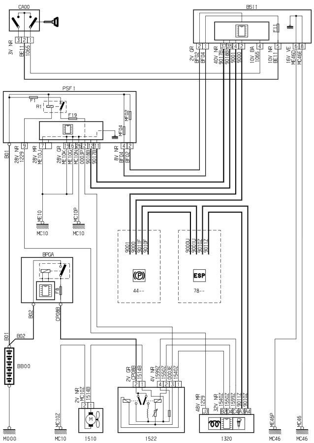

What is the last 8 digits of your VIN & i can look at a wiring diagram?

Re: Radiator fan not coming on
This is the diagram for your car, it shows the motor only has a 2 way connector but you say yours has 4 wires? The fan chopper unit has a 2 and a 4 way plug?
If you disconnect the grey connector on the chopper unit & give power to pin 1 does the fan operate?
gim461
- Posts: 5
- Joined: 05 Feb 2021, 00:33
Thanks for your reply.
I have attached two pics of the fan, and as you can see there are two connectors, each having two wires. So it seems this does not match the circuit you have posted.
Maybe for this fan, the chopper unit is inside the fan?
Thanks for your help.
- x 1746
Interesting. Does look like a control module integrated with the fan.

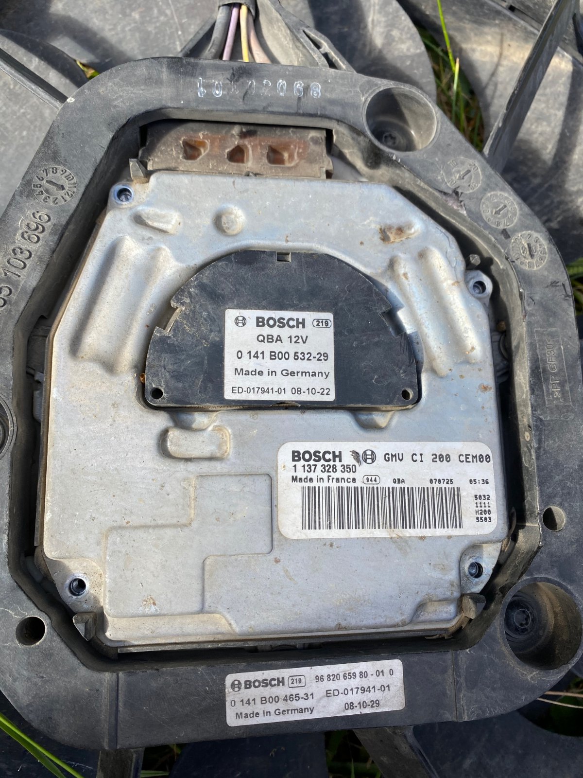

Could you post those Bosch item numbers (both the labels), so we can look up technical details for them?
Thanks.
Thanks.

Thats the wiring diagram based on your VIN. Thats not to say its definitely correct, it does happen sometimes where they are wrong.
I wonder if it can be stripped down further to find a 2 pin connector directly on the fan motor?
Although the schematic shows the fan control module separate they may be integrated.
It does look like a 4 way black which is what the diagram shows on the fan control unit.
gim461
- Posts: 5
Thanks Chris and wheeler.
Attached is a pic showing the numbers.
I took the four screws out of the cover and tried to lever it off, but it I couldn't move it.
