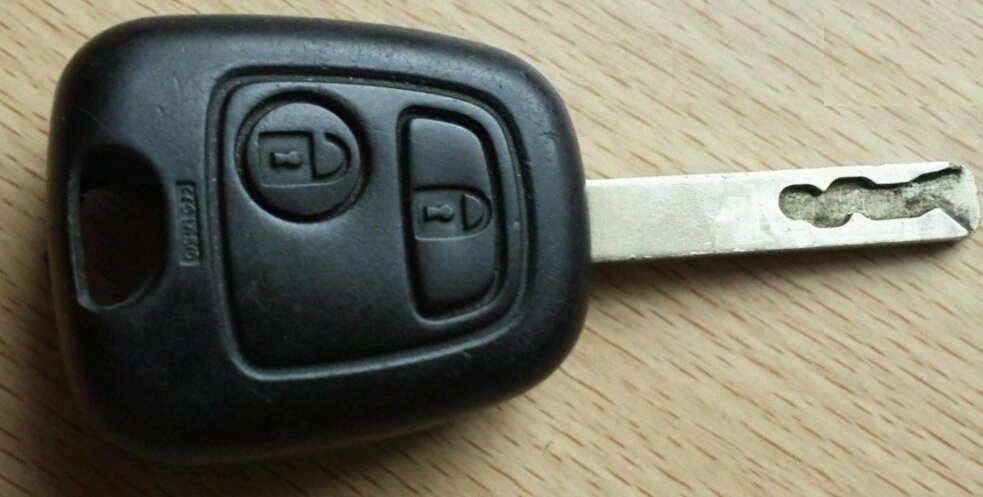

This is the style of key And this is the RCL bit The buttons and the battery are both good.

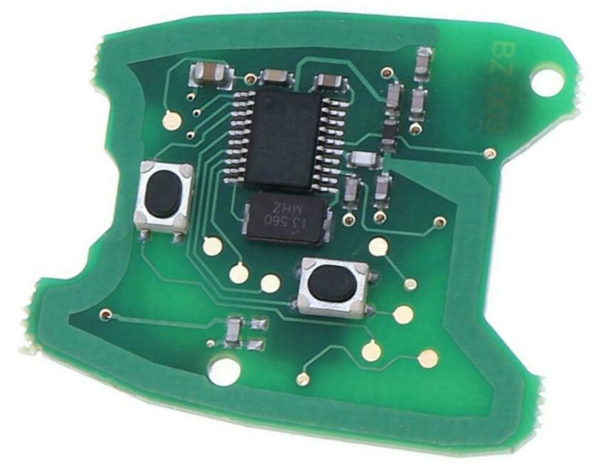

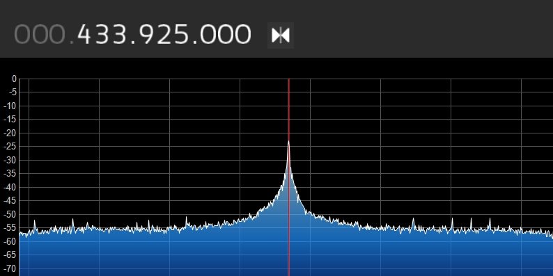

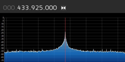

I've used a spectrum analyser to check the device is transmitting I've also used the BSI / parameter measurement option in Lexia, which shows that the BSI senses a press on the fob, but fails to act on it.
So that's the fundamental problem, the relationship between the fob and the BSI has been lost.

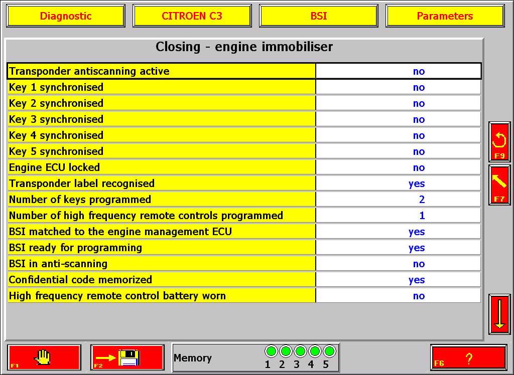

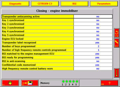

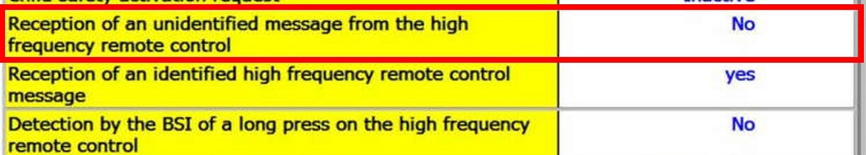

This screenshot from Lexia shows that although it's aware of 2 keys, it only recognises one RCL fob. Somehow I need to make it see the other one. I have the 4 digit key programming code and I've been through the process of reconfiguring the BSI to recognise the RFID chip in each of the two keys, but that doesn't address the RCL function.

1) The transponder chip in both keys has been programmed successfully - we know that from what Lexia is showing us. This means both fobs will start the car as the transponder coil in the ignition barrel energises the chip in the fob and the authentication takes place.

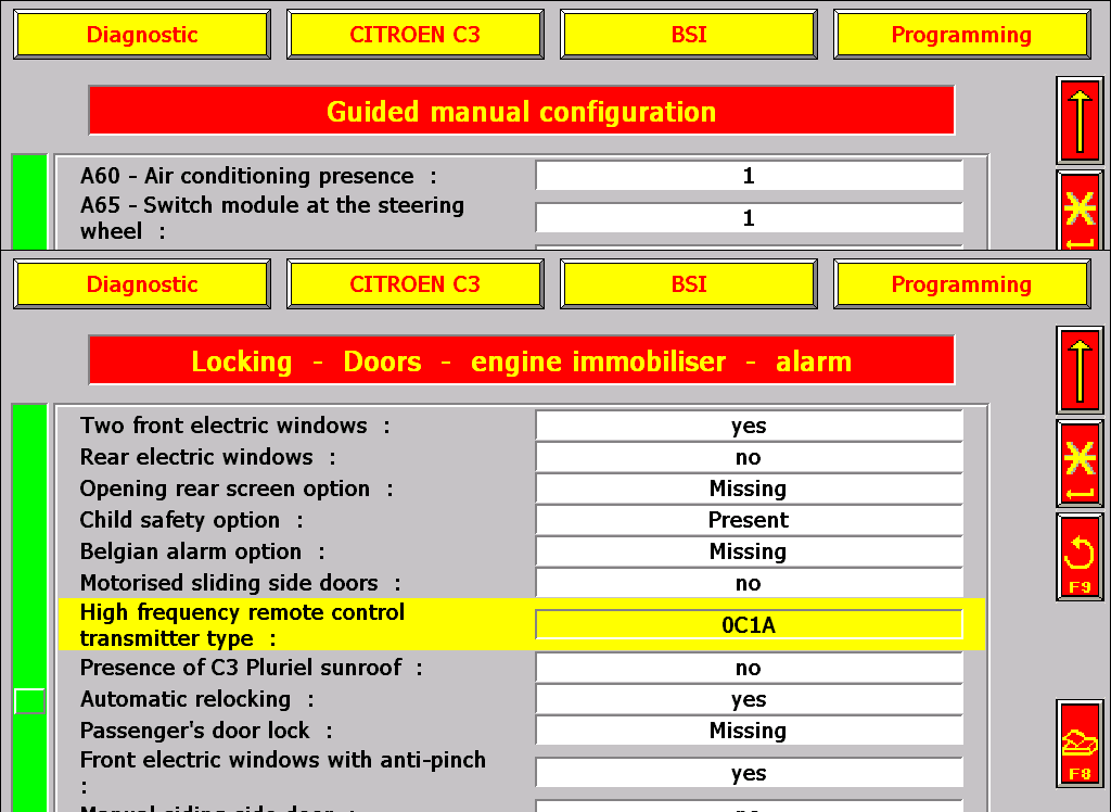

ozvtr I'm slightly confused; I think you and I may be using terminology differently. In my mind at least, the RFID chip is the wee module down by the key blade; mine's labelled Philips PCF 7936AS. I've learned a lot about these, but they're only used for the immobiliser, so can be discounted for now.

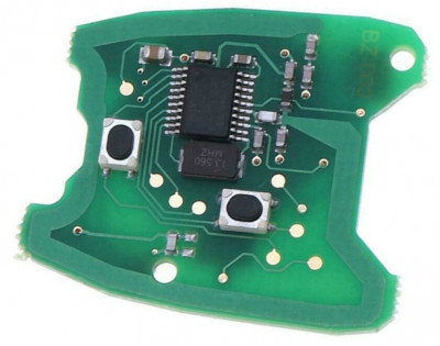

On the RCL board (7337 3067C), there's only a microcontroller and an oscillator that sets the transmission frequency. I haven't managed to find any technical documents covering these. So far, I've assumed they are not configurable after they leave the factory and thus pairing one with a car requires instructing the BSI to accept the code that's transmitted, but that may be a gross oversimplification.

I am sure the non-working RCL module is transmitting on the correct frequency, so the buttons and the battery are ok.
The reason I can say this with confidence is that, firstly, I can see a response on an RF spectrum analyser (a slightly grand way of describing some open source software and a £15 USB module) but more importantly, if I use the BSI parameter measuring page in Lexia, a button press is registered, but it's shown as an unidentified message. It's transient, and I didn't manage to catch it in a screenshot, but imagine the highlighted section below blinking from No to Yes and back again as the button is pressed.
The bit that I'm most curious about is the BSI status screen that shows only one RCL module programmed. Somehow, I need to make the lower field read 2
If I went to a dealer and said I've lost my spare key and need a new one, they would be able to produce one for me. Obviously the price would be a significant proportion of the value of a 2003 C3 these days, which is why I don't propose to do it, but ultimately, the question comes down to how they would configure a new RCL fob to work with the car, and is that course of action available to anyone with a Lexia ?
At one point, while I was searching around BSI-related screens in Lexia, I found one called Guided Programming, which has this interesting line:
This is a configurable field, but when I dug deeper, it asked me for a 4 digit code and the one I used for programming the immobiliser (the one on the card that comes with a new car) didn't work, so I'm wondering whether there is a dealer ID that allows some parts of the cofiguration to be updated. In any case, to be of any use, we would have to convince ourselves that encoded within "0C1A" is the number of RF remotes........

No, It cant. As I said the RFID chip AND the central locking board are paired by using a unique identifier FROM the RFID chip. If you know anything about RFID chips, when polled, they give off a LOT of data. One part of that data is programmed into the central locking board DURING THE MANUFACTURE OF THE KEY. If you are talking only about the engine immobilizer, then, yes the identifier is not relevant, but we are not. We are talking about the central locking. The identifier IS part of the programming of the central locking board. Now, I do not know why YOUR board does not want to work. As Givemeabreak says there are multiple reasons why the board wont work. I am trying to explain how the system works so that you can better fault find it.CitroenCrazy wrote: 02 Feb 2021, 13:44

OK, you need to inform the BSI of the current code transmitted by the "RCL board", to synchronize them,right? So that the BSI can predict what the next code will be by applying an algorithm to the current code. I know that you know that! To do that you need to go through the "synchronization process" in the LEXIA. I know that you know that too. BUT to validate that the code being transmitted by the RCL board is from a "kosher" source, during the synchronization process the BSI checks that the unique identifier between the RFID chip AND the RCL board are the same. AND that unique identifier is in its memory...otherwise it rejects the RCL board and will NOT synchronize it!CitroenCrazy wrote: 02 Feb 2021, 13:44 On the RCL board (7337 3067C), there's only a microcontroller and an oscillator that sets the transmission frequency. I haven't managed to find any technical documents covering these. So far, I've assumed they are not configurable after they leave the factory and thus pairing one with a car requires instructing the BSI to accept the code that's transmitted, but that may be a gross oversimplification.
The HF module (the receiver in the car) will receive and pass on to the BSI EVERY signal it can discriminate (that pass certain criteria, like correct frequency). So when you look at the relevant LEXIA page, ANY signal the BSI CAN decipher is displayed as "reception of an IDENTIFIED high frequency remote control message-yes". If it CANT decipher the signal you get "reception of an UNIDENTIFIED message from the high frequency remote control-yes". By the way, if it gets an "unidentified" signal the BSI goes into "anti scanning mode" and WILL NOT PROCESS signals for the next 60 seconds. Try it. Try to lock/unlock your C3 with the transmitter that puts out a signal but wont open the doors. Then try locking/unlocking with the good one within 60 seconds...it wont work! Wait a further 60 seconds and it will work. This is a strategy against "bruit force attacks", if you know anything about hacking.

Look carefully...it's a 5 digit code, not a 4 digit code. It's a generic code used by PSA technicians as a fail-safe against "unauthorized" users.CitroenCrazy wrote: 02 Feb 2021, 13:44 This is a configurable field, but when I dug deeper, it asked me for a 4 digit code and the one I used for programming the immobiliser (the one on the card that comes with a new car) didn't work, so I'm wondering whether there is a dealer ID that allows some parts of the cofiguration to be updated.

The 5 digit code you need to change settings is 03114

Have you tried swapping the RCL board out of the "bad" fob into the fob that starts the car, the semi-good one? Leave the RFID chip in the key. Then try the re-synchronizing process? Is it possible they were swapping RCL boards around because the original de-synced and they thought it was faulty? Remember you have to find the RCL board that's paired to the RFID chip before you can re-synchronize it
