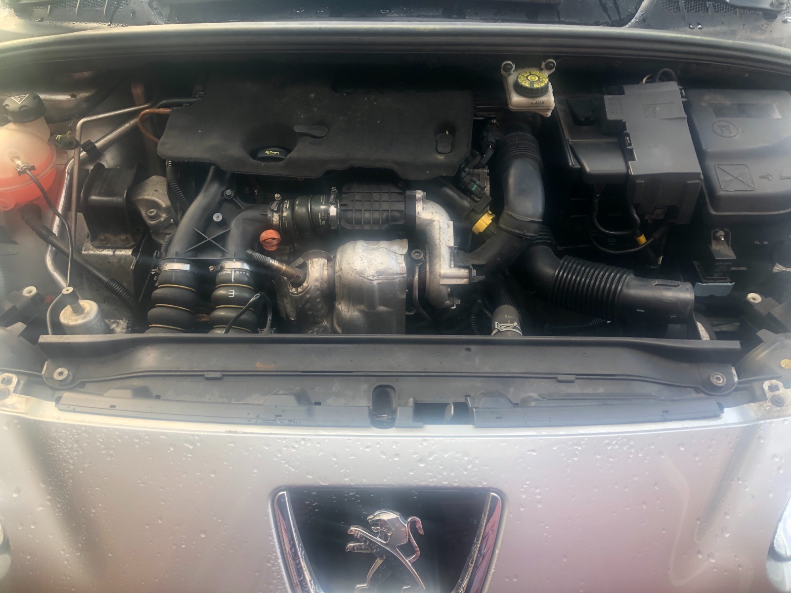

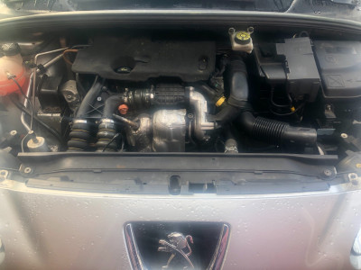

I’m not sure how I tell if it’s 8 or 16v. There is no engine cover.
I’ve attached a picture of the engine

That's an 8V DV6C engine. I'll look up to location of the boost solenoid later. There might not be any error codes - you need to look at the live data. Does the air flow make sense, does it increase in line with revs? Is the boost pressure rising as it should? Does it match the reference pressure? Does the reported position of the EGR valve match the requested position? Does the turbo position match the requested position? You're looking for anything out of place. Did you replace the MAF sensor, if so where did the replacement come from?
