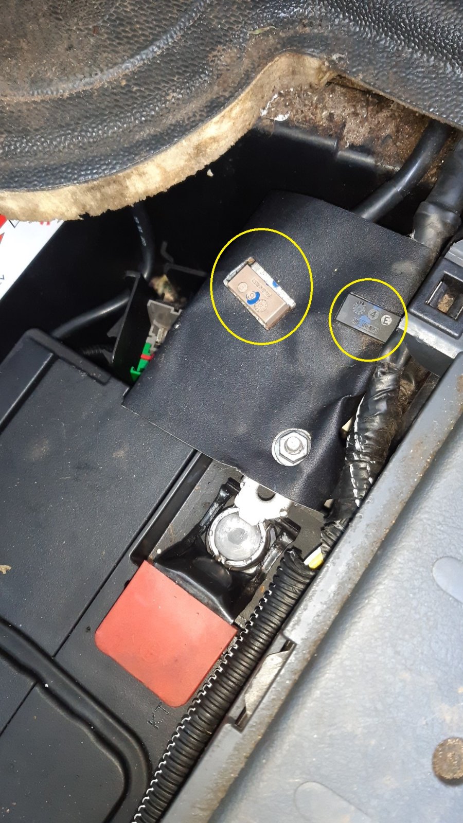

Kenny, I did wonder if there was a smart charge function cutting in and out although Marc suggests not. There are a couple of components on the positive terminal wiring which I'm not familiar with and thought they might be part of a smart system.

The things circled are just fusible links.
