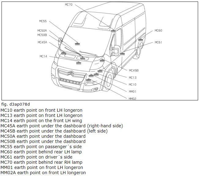

I have Citroen jumper(relay) year 2010,2.2hdi.
Where are the ground points in the car.I'm looking around dashboard,cluster.I think I have bad ground.
These lights on cluster are on,when i open a door, and they dissappear at the same time cealing light goes off,when i close the door.
When the car is running, they are on.
Here is the picture
Citroen jumper ground

Hi!
I' was unable to locate the ground screws inside the Jumper,under the dashboard.
Can anyone tell me the specific place of the ground
Thank you
