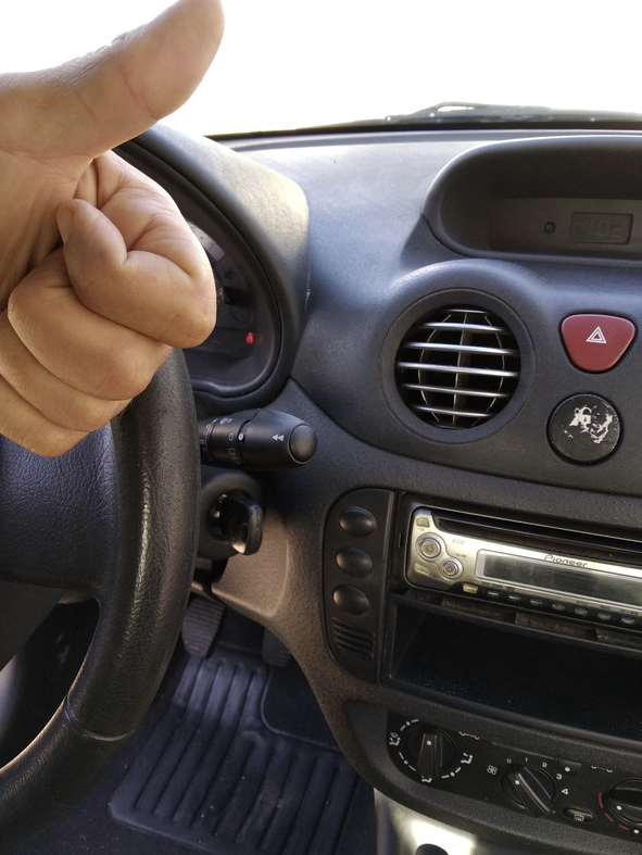

I notice the aftermarket Radio - unsure whether this may be causing you some locking issues.....

I thought about that too. But this radio has been installed for so many years and gave any kind of problemGiveMeABreak wrote: 07 Jan 2021, 18:05 I notice the aftermarket Radio - unsure whether this may be causing you some locking issues.....
