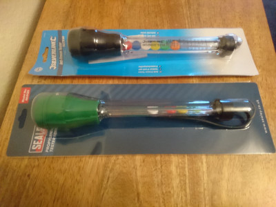

My Sealey model for the oat car has arrived but still waiting for the meg one

Mick, you keep saying OAT car but, unless you specifically know that the anti-freeze is MPG (highly unlikely) then whether or not the inhibitor is OAT shouldn't make any difference.

Thanks Paul, its me mixing up my acronyms. The Celerio has MPG whereas my cars have MEG. Because I cannot always remember which is which of those I call them CHEM (MEG) and OAT (MPG) in my own mind and forget when I write about them. Sorry if I confused anyone :-D

Testing day tomorrow!! :-D
