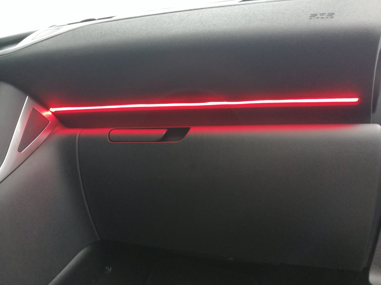

Heres a picture how it looked with 14.5v. The RED is obviously overwhelming. I was planning to set it to pleasent 6.5v

A bit of update. The 3.85 - 8v was because of the internal light brightness control.
In the end, i gave up using the original wiring and ledbars i made my own set, with a "smart" controller. Gave it two input voltage for "sensing scenarios". 1 for when opening the door and the other when the engine was running. You open the door, the ledbar lights up about 70%, and dims down to 35% when door closed and engine running.
Gives it a really nice autenthic feel.
I might change the red to orange or warm white.
Sadly a phone video doesn't do the full justice..
