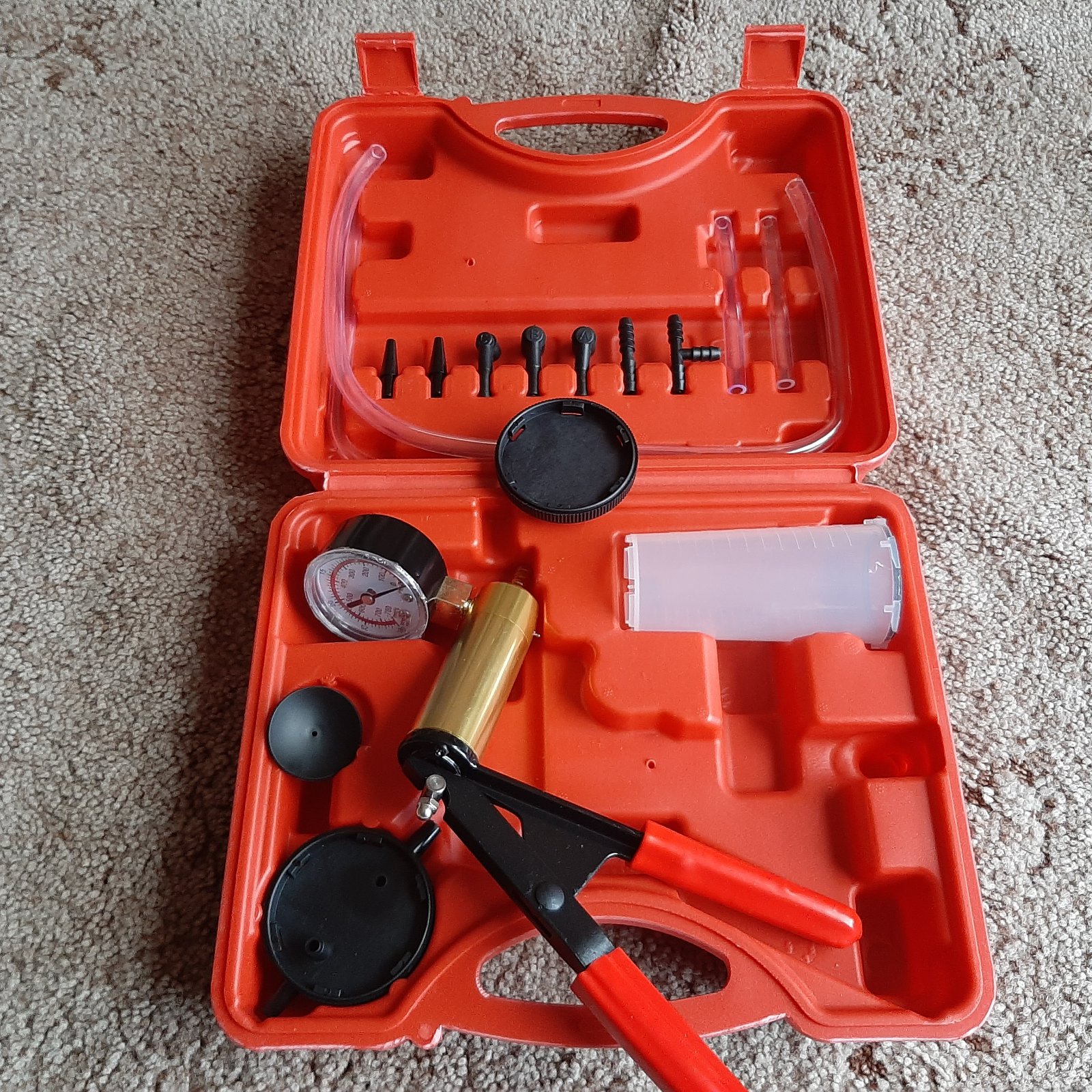

A very nice man from Amazon brought me this today
A vacuum brake bleeding kit... I'll be trying it on Daffodil later
It should make flushing out her old brake fluid and bleeding in the new a nice, clean and easy job.
I'll report back
Just waiting on a delivery of brake fluid now...

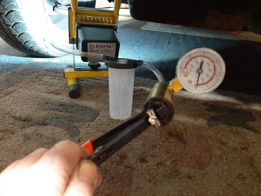

If the pressure gauge goes into the red you're positive

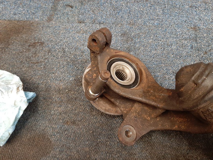

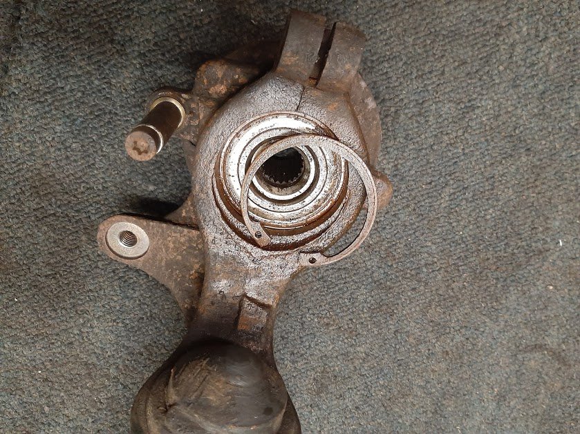

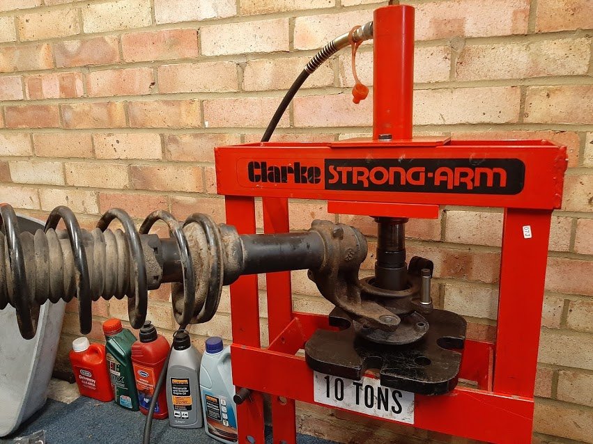

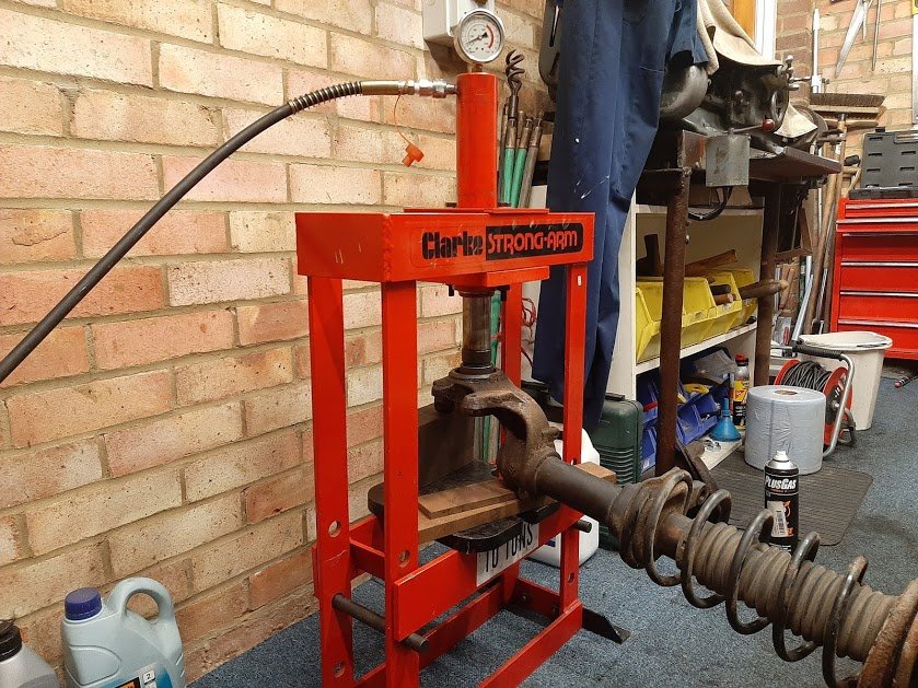

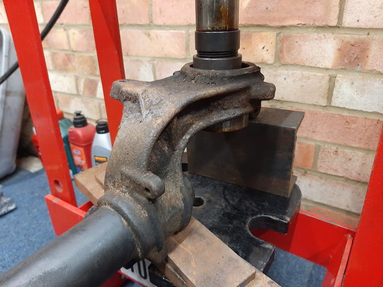

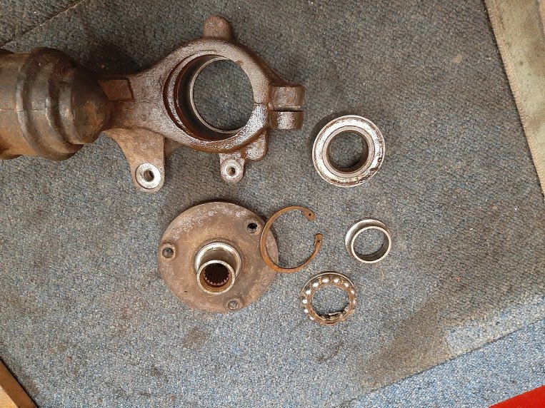

Over the years I've replaced countless wheel bearings, mainly in Xantias and XMs and in every case they've been a fight
Even a little Pug 106 I did put up a very credible fight!
I was amazed today at just how easy Daffodil's were to do... I got an idea they would not be difficult when I was able to extract the circlips without mangling them and attacking them with a cold chisel and big hammer
The bearings needed very little pressing out...
Normally, to get the inner race off the stub axle takes heat, angle grinders and cold chisels but not Daffodil's... Hers came off using a flat bearing puller and a pair of big tyre levers
And here are all the removed bits, all undamaged, ready or new bearings to be fitted... That's a job for tomorrow...
The old bearings had died for the usual reason...The grease had dried out...
Reassembly will commence tomorrow, weather permitting
I'm hoping by tomorrow afternoon Daffodil will be back in her warm, dry garage...
Then it'll be time to do the rear drums and bearings... I can do those indoors...

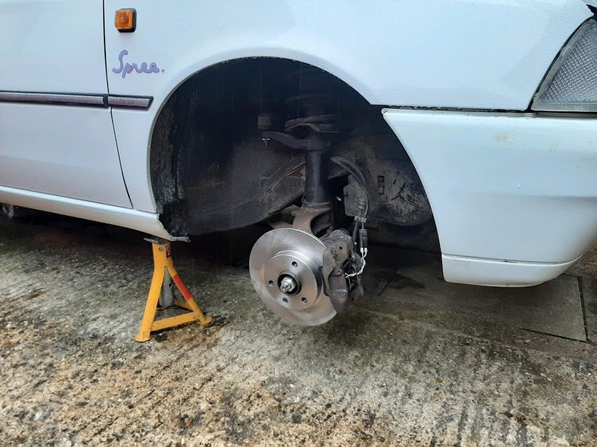

A very good day on Daffodil today...
After spending the night in the freezer to shrink them, the new bearings and the hubs/stub axles slid into place a treat
Reassembly did not take long
Behind the shiny new disc, bearing and pad is a nice new driveshaft
Wheels on and Daffodil is nicely tucked up in her cosy garage again
The remaining jobs can now be done indoors...

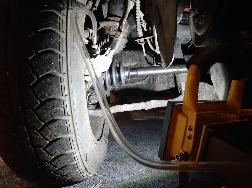

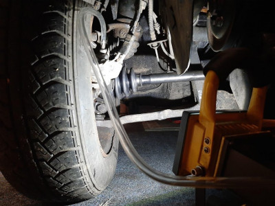

I gave my new vacuum bleeding kit a try today...
Fundamentally, it works well and is great for drawing a large volume of fluid through the system for flushing purposes.
One problem I was warned about by a person with much experience of these things is that they have a tendency to draw in air down the bleed nipple threads and this can be seen as a stream of small bubbles in the fluid flowing out of the nipple.
This does not seem to have adverse effects on braking performance but just in case I'll likely use it for an initial 'quick and dirty' bleed and a flush before doing a final bleed using more traditional methods...
It certainly does make it a very quick and clean job of it... The waste fluid catch bottle is a lot better than the jamjar used in the traditional methods... I have a terrible tendency for kicking over jamjars full of brake fluid and making a terrible mess
