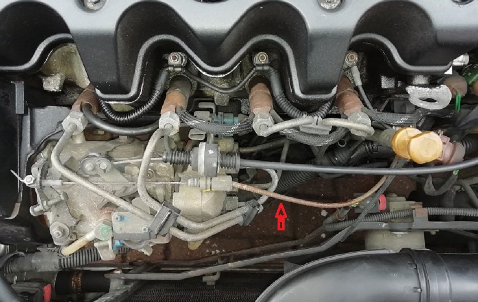

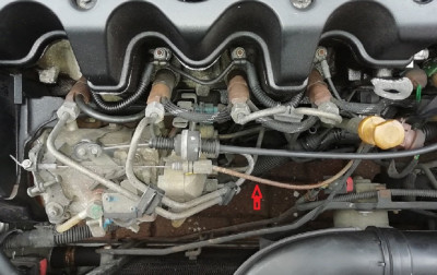

Re: TUD5 timing belt
Unread post by Jonathancilia »
Yes i cant work out that, on the saxo forum i have been told that the bosch pump is normal for it to dont have the fast idle cable. Infact the waxstat is blocked off on many engines, i went to adjust it ince only to find no cable 😂
I have been told that bosch pump dont have a fast idle cable from factory, only lucas ones have, i would like to have abit of a higher idle when cold but i think irs not possible to fit because its blocked off. Anyway this engine doesnt have any problem when cold its very low mileage, only 109k kilometres. And solid compression, starts instantly when i turn key from cold.
