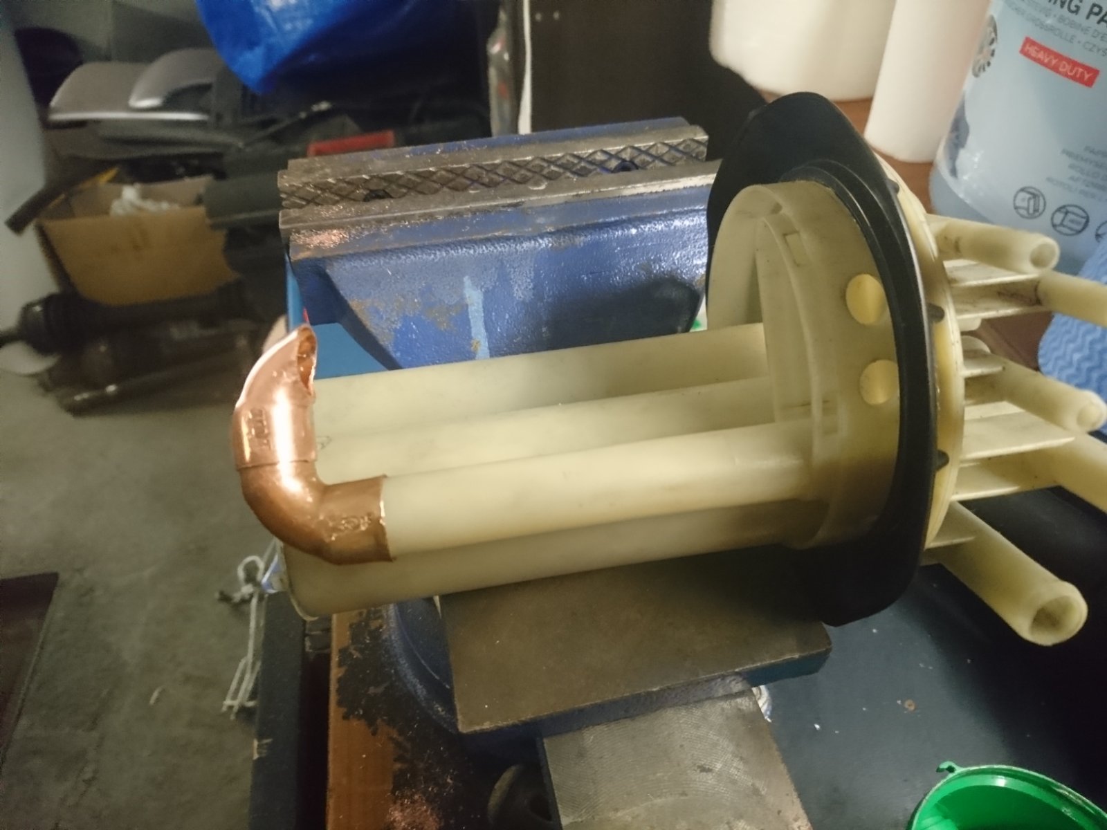

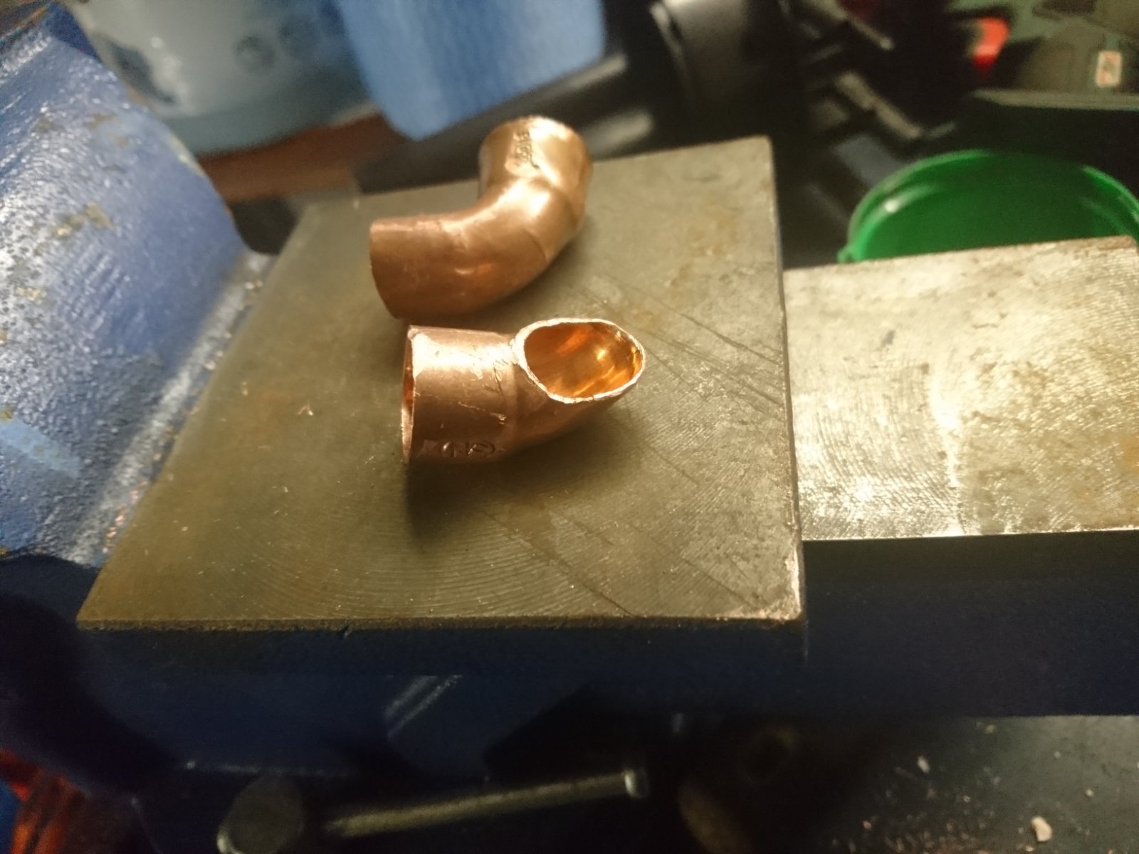

Hello. I haven't written in a while but the fight with the air continues. I bought a new Citroen LHM pump and fitted it to the V6 mount. It didn't change anything. The power steering was a bit worse than on the original pump from V6 (bigger pistons in V6). I also bought new connections to the tank (xantia) to eliminate cracks in the plastic, etc. Unfortunately, I can still see air in the pump supply line. At idle, there are a lot of them and they are microscopic, but when I press the gas, it draws large air bubbles (like in the video), which the pump breaks into even more microbubbles, which causes worse and worse driving the longer I drive.
I have looked at this pipe and the air is coming out from inside the tank, not from under the band. I watched it after about 12 hours of suspension rest, where there should be no more microbubbles in the tank. In the morning, after starting the engine, I immediately looked at the cable, which already had microbubbles in it. How is it that air gets into the hose supplying the pump within about 3-5 seconds from starting the engine despite new connections at the tank? I wonder if Mandrake found a problem because his symptoms were similar to mine.
Workaround for bubbles in LHM return flow

Re: Workaround for bubbles in LHM return flow
I used to drive with a hose inside the tank once and there were no positive effects. Now, after replacing the steering gear, there is a big improvement in the process, so I will try again, but only after replacing it with a fresh LHM to save the LHM pump. I leveled the threshold at the connection before installing new connections.
Unfortunately, driving without a suction filter and with a suction pipe directly in the tank does not give good results. The ride itself was worse, rougher and more nervous without the filter. Probably some of the air stays on the filter screen. After changing the LHM, I noticed that the air in the hose in front of the pump appears only 3-5 seconds after starting the engine, which would suggest a problem somewhere on the power steering. Return from the conjector comes only when it lifts the suspension, which in the morning takes a total of about 30 seconds before it fills the suspension.
I noticed that on the new LHM, air releases from the oil much faster. I also measured the time to turn on the conjector after driving in the city, which shows that the air disturbs the work of the hydraulics:
8 sec; 13sec; 16sec; 17sec; 21sec; 25sec; 28sec; 35sec; 51sec; 1: 16 min.
I also did a little front axle test because I have a problem with the front axle dropping down after a night. I have already used 5 sets of actuators, a few height correctors, a few SCMAC valves and unfortunately there is still a problem.
Yesterday before the night I went and started the engine for about 10 seconds, and I directed the return cable from the power steering / conjector to the 1L bottle. I repeated this 4 times. This morning the front is up and there is pressure on the actuators when the doors are opened.

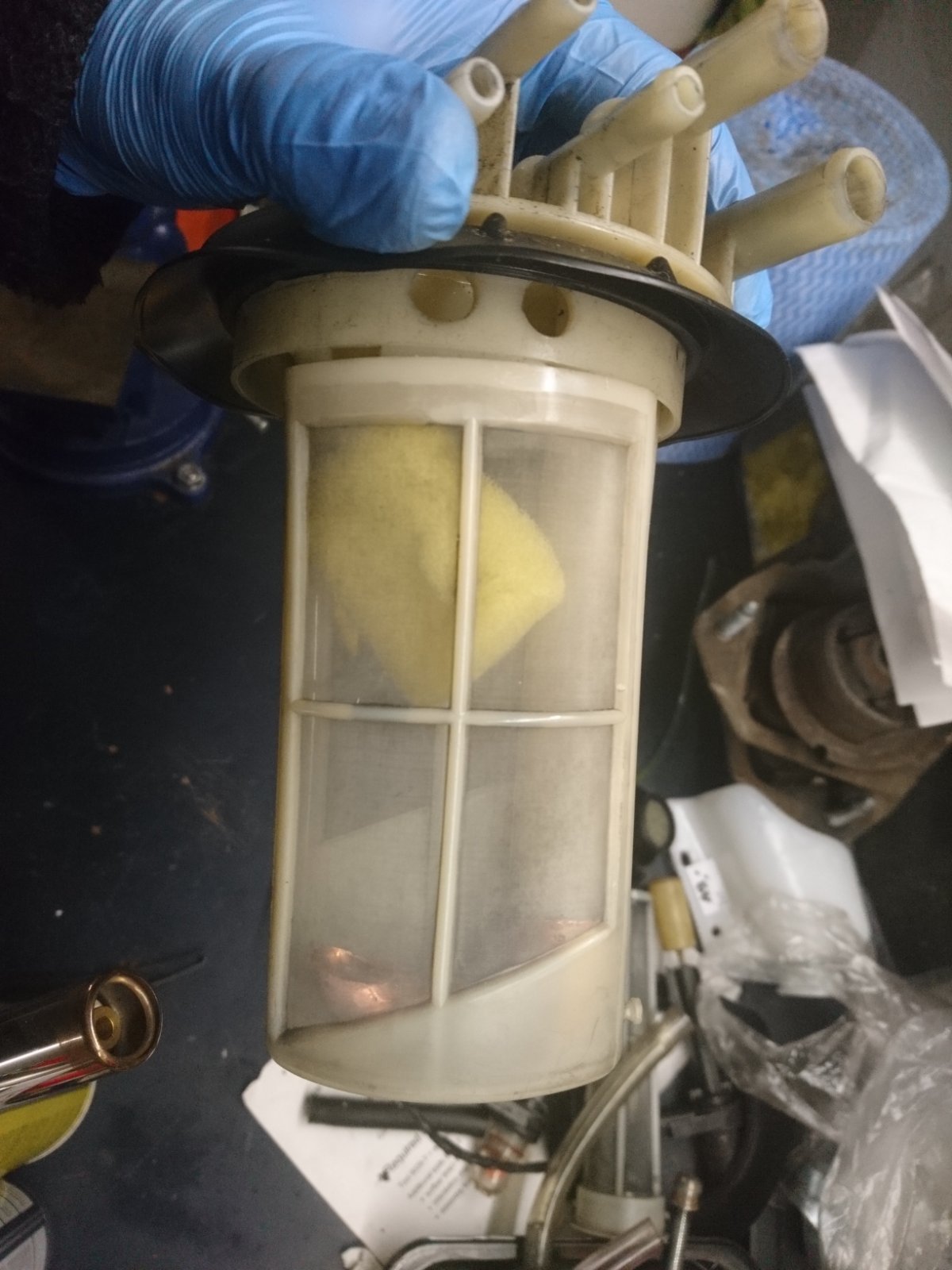

I wish you happiness and a lot of comfort in the New Yearwhite exec wrote: 22 Dec 2020, 10:54 The two tank filters are also there to break up returning air bubbles, and prevent them from being recirculated into the system. It's a two-stage process - large filter first (for the return pipes), then the small one surrounding the pump pick-up tube.
I also have new filters. They can't handle air microbubbles. I did the 10min mod unfortunately without cutting the tube. I used copper elbows and directed the liquid to a piece of sponge (it retains microbables very well and connects them into larger ones that flow faster to the LHM surface). My wife said today that XM is enjoying a ride. For me, this is not the suspension work he can do. I ordered an air separator used to heat apartments. I wonder if the oil is also able to precipitate air during the flow.
Interesting, Mat.
All the fluid returns are fed into the interior of the large filter, and the fluid has to pass out through the nylon mesh, which is there to break up/destroy large bubbles, and to persuade small ones to break down. The microbubbles which do manage to get through the mesh are supposed to cross the reservoir slowly, and hopefully rise to the surface and dispel.
The smaller filter attacks bubbles for a second time, to prevent them being sucked into the pump and recirculated.
I'm interested in your additional sponge filter. Which of the return pipes was it fitted to?
It is obviously helping, as the ride is reported to be improved, and suggests that this return pipe is the source of the air.
One of these systems working properly (no air leaks) will not have any air (even microbubbles, which are usually tolerated) visible in the reservoir fluid.

MatPL
- Posts: 46
- Joined: 13 May 2020, 19:49
From my observations, the microbubbles that float in the tank with the engine off, very slowly rise to the surface. Probably because they have low displacement. With the engine running, the pump draws in oil, making it difficult for the micro-bubbles to get to the surface and draws them into the pump.
I put the sponge filter loosely (as in the photo) in front of the outlet from the return of the steering gear / conjector. I left some space for the oil to seep through the original filter and so that the sponge filter does not clog, but catches the microbubbles and fuses them into larger ones.
I think the steering gear circuit is a problem, because after starting the engine, the most fluid returns from there and under the highest pressure. I have already replaced the steering gear 4 times together with the heads on new seals.
