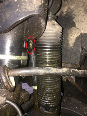

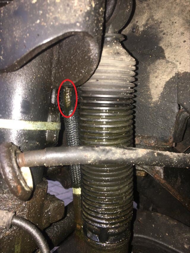

Got a burst pipe somewhere STOP .... limped home 2 miles as it was pissing down ..... pump belt is OK ....investigate location tomorrow, suspect a scabby OSF pipe.

I've cast my mind back a bit .....
As above - I had noticed some slight chaffing on the front ram hose nylon outer sheaf but it's done 16,000 miles since the rams were done according to the invoice, but that has now been severely chewed probably by the upper mounting lug for the ram, quite hard to get a decent photo in situ, I suppose I should have taken more notice of that initial chaffing when I replaced the low pressure return line.
Maybe I made the contact area worse when I fitted the suspension leg low pressure return line
I will have to make sure I get some decent clearance when at normal height on assembly.
I need the following part No. for: VIN VF7**************[VIN obfuscated, can be read by forum staff]
FRONT RAM HOSE Are they individual ? I need the rear/outer one
(SUSPENSION LEG GAITER also perishing)
Well my initial suspect is not guilty.Skull wrote: 18 Jan 2019, 14:35 Week has flown - not much done but I had a look at the weep from the front n/s suspension leg seemed to be the coming from the low pressure return connector which is held on by a metal clip .....
Which leads me to the other problem I've discovered - one of the ram flexi-lines has been chaffing on either the suspension leg or the back of the return connector (and may have dislodged it a bit ?)

Skull, there's a way of dressing the ram hoses to prevent chafing. See my website
They are identical front and rear but are 'handed' in that they're different lengths..
Hopefully someone will have a decent spare in their stash somewhere. Sadly I no longer have
You may find a mob such as Pirtek can make you a new one using your original fittings...
Here's hoping it all turns out good
