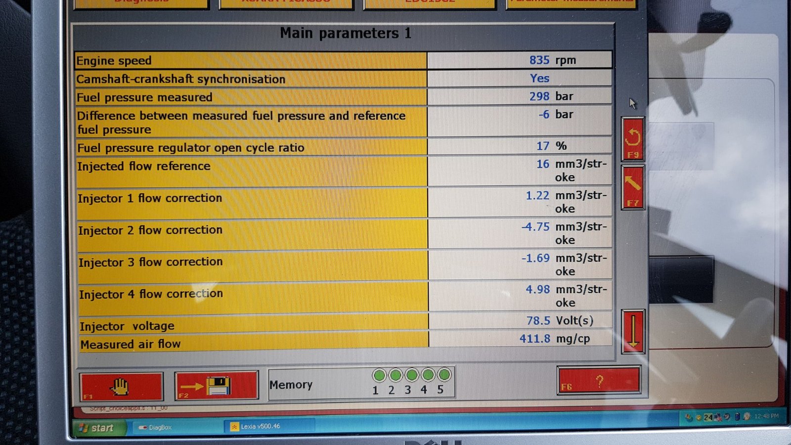

in regards to my saga with the lumpy cold running
i've gone into the parameter measurements in lexia to check the injectors
injector 1: 1.22 mm3/stroke
injector 2: -4.75 mm3/stroke
injector 3 -1.69 mm3/stroke
injector 4: 4.98 mm3/stroke
plus additional information shown in attached images, curious as to why the EGR is doing something just after a cold start
only codes are the classic HDi glow plug relay

Flow correction is not good. According to the distribution of values, I would say that the problem is not in the injectors.Otherwise the injector parameters are read when the engine operating temperature is reached.

are we looking at more likely to be the fuel pump/fuel rail?
i'll be driving it about 100 miles tomorrow, so will re read them upon returning home to check how they look when hot

i also revved the engine up slightly at first to 1028 rpm from idle
these are the readings i got whilst conducting this
injector 1 flow correction: -0.20 mm3/stroke
injector 2 flow correction -3.57 mm3/stroke
injector 3 flow correction -1.29 mm3/stroke
injector 4 flow correction 5/06 mm3/stroke
1124 rpm (this is where it smoothens out most days after cold starting)
injector 1: -0.43 mm3/stroke
injector 2: -2.78 mm3/stroke
injector 3: -1.92 mm3/stroke
now, i'm aware from doing some research these results are not good at all
where is best to proceed with this? i absolutely thrashed the car today, but as per usual i do a lot of motorway driving so barely any smoke and didn't make any difference to the way it was running.

Check-crankshaft pulley, pc belt tensioner, compression, injector washers.

Checked everything i can under the bonnet today, all looks absolutely fine, even charging spot on
warm idle
injector 1: 0.12 mm3/stroke
injector 2: -2.31 mm3/stroke
injector 3: -2.86 mm3/stroke
warm driving (1992 rpm)
injector 2: -1.22 mm3/stroke
injector 3: -0.67 mm3/stroke
injector 4: 0.59 mm3/stroke
now this seems absolutely spot on, however i have a feeling the flow correction doesn't kick in that hard whilst driving/revving
revved the engine up to 3k rpm whilst stopped, which made the readings somewhat behave
warm idle (just after static revving)
injector 1: 0.74 mm3/stroke
injector 2: -1.45 mm3/stroke
injector 3: -1.37 mm3/stroke
injector 4: 2.08 mm3/stroke
so, what i believe is causing the issue is failing fuel injectors on cylinders 2,3,4, injector 4 seems especially bad
smokes quite badly at cold idle, and runs lumpy when cold

Now the values ​​are different, maybe you should measure the compression, do a test on the overflows or take the injectors for control.
